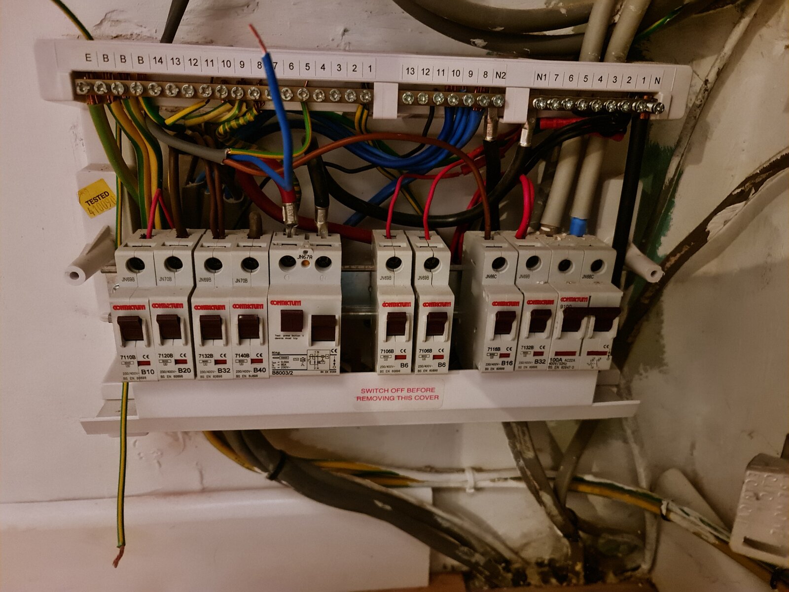

I found a 16Amp MCB in the CU that wasn't being used and decided to use that for the Dyson socket. The CU is split load. The electrician that installed it found faults on the upper and lower rings and put them on the non-RCD side.
I noted that the neutral for the RCD went in to the other neutral connector bar, so I connected my neutral to the left hand bar. I turned on the main power and the RCD tripped. I then realised that the other neutrals on the bar were ones covered by the RCB, I then moved the neutral and everything was fine.
Shouldn't the neutral RCD be on the RCB side?

Apropos the neutral for the RCD- if you look at the image the neutrals covered by the RCD, they terminate in 13-N2, but the neutral for the RCD runs into N1. Is that normal?
Yes of course!. That neutral IN to the top of the RCD is the supply. N1 is the neutral supply bar, it is fed from the main switch on the right.
The N2 bar is fed from the output (bottom) of the RCD.
