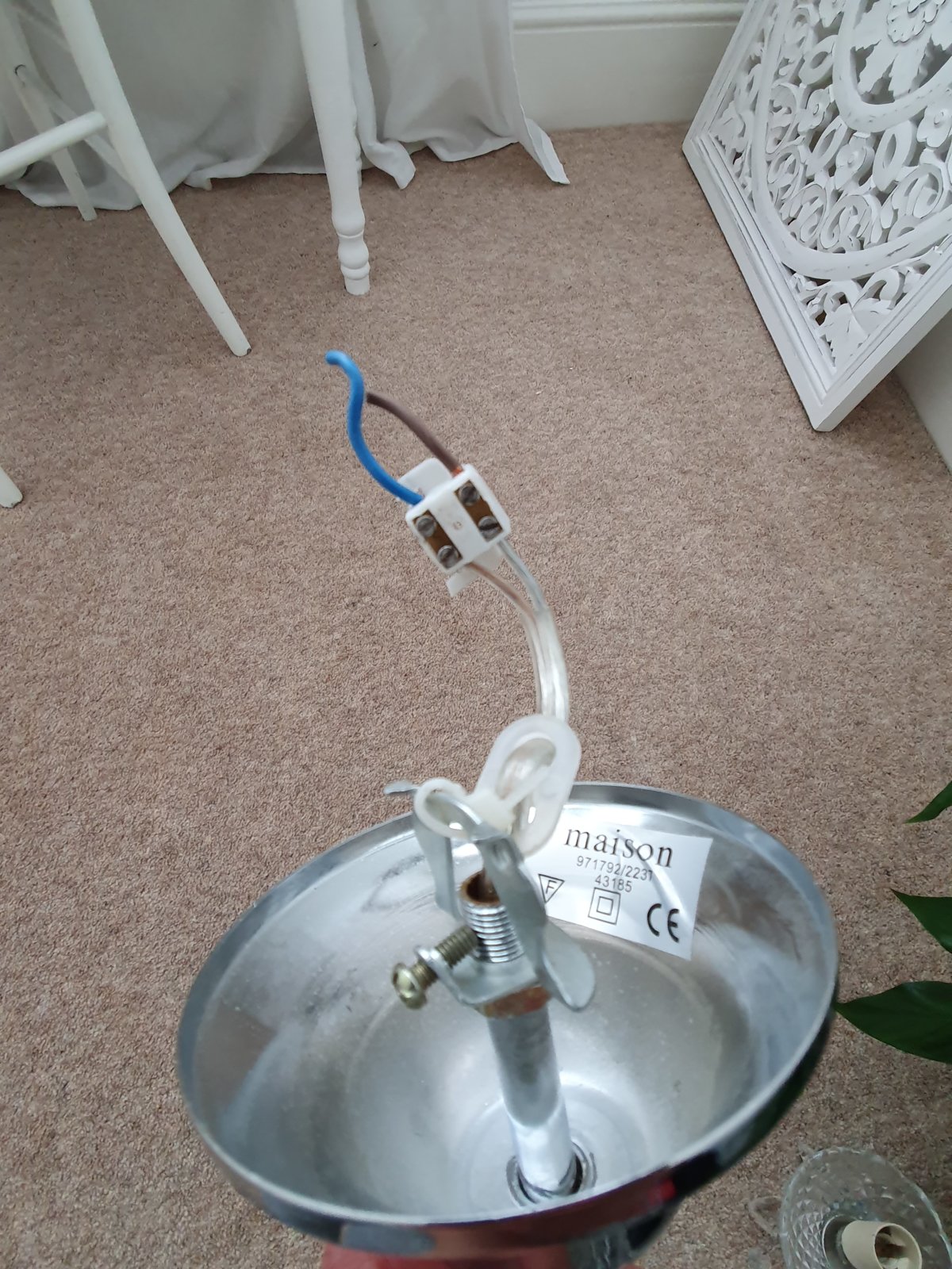

Hi everyone,
Wondering if anyone can help? I have no Earth wire in the new light fitting I'm trying to put up, which I suppose is fine because it must be double insulated? (It has the double square - please see photo with Maison sticker).
I thought this would be an easy job, but there are a million wires coming out of the ceiling...Can I put the Earth wire which is currently attached to the old light fitting (which is still up) into one of the connection blocks for another Earth that is already there?
Then should I just put the live and neutral wires from the new fitting into where the wires from the old fitting are?
Thanks!
Well, I can see that your "new" light is "old" in that it is second hand. You should use the connector that came with the fitting when new. They are a PIA, but you need to ensure separation between the incoming cables and the fitting. Just ensure the earths are all in a block together and do not electrically come into contact with the fitting.
Yes the "new" fitting is second hand. Sorry I'm a rookie here. I know, that means I should probably get an electrician in but I was hoping it could be straightforward.
The problem with class 2 "double insulated" metal light fittings is that while they may well meet class 2 insulation standards when installed exactly in accordance with the manufacturers instructions and fed by a single cable, in practice they are very often wired in ways that violate the class 2 insulation standards.
To maintain class 2 insulation standards on such a fitting the incoming cable must remain sheathed and protected from abrasion until it passes into a terminal enclosure and all connections must be made inside that terminal enclosure. In practice what that means is that you need to bring a single cable to the light and that cable must have enough slack. Often this means fitting a maintainance free junction box in the void above the fitting to deal with multiple cables and/or cables that have insufficient slack.
The fitting you have looks like it has had it's terminal enclosure butchered by the previous owner. So re-using it doesn't look like an option. Finding a replacement fully enclosed terminal enclosure that is small enough to fit inside the fitting is likely to be difficult.
The other option is to modify the fitting to attach earth wires to the exposed metal parts and make it class 1, but again this may be easier said than done.
