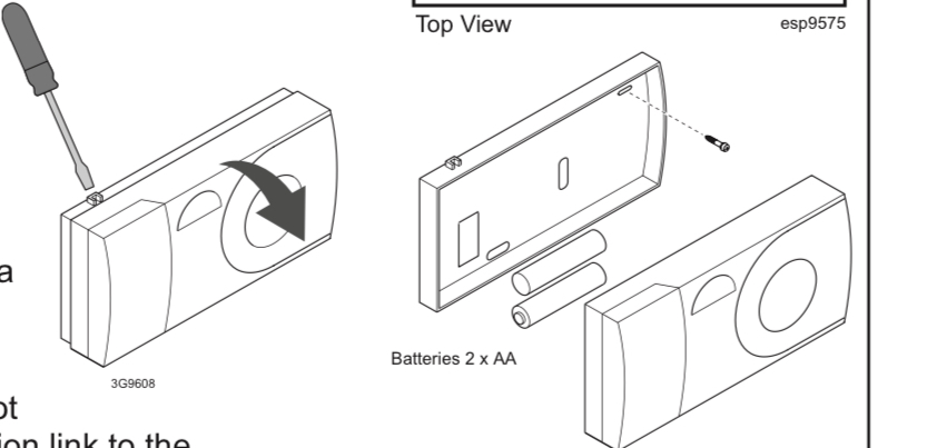

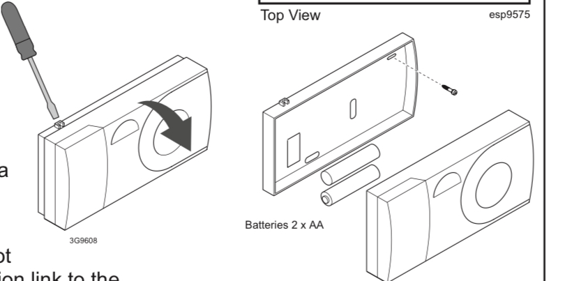

How did you get your thermostat off the wall? I have the same one and I don’t know how to take it off the wall!!
Looks like it’s a flat head screw at the top, then the fixings behind after removal of the thermostat. Do you definitely have a wireless type?
