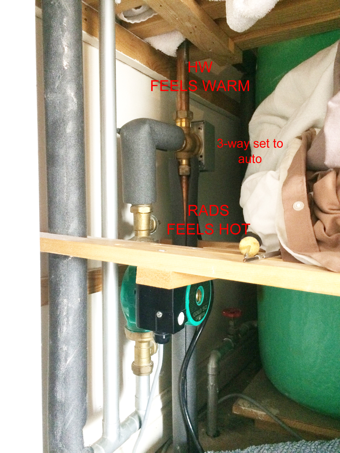

I have an issue with getting hot water which has only just happened.
I have a gravity fed system for heating/hot water which has been working fine for some time (oftern water seeming a little hot)
My hot water is not getting heated any more, so i checked the pump and that seems as though its fine, even unscrewed the brass screw to release any air. The next in line is the three-way valve for heating and hot water (delivering to cylinder), the pipe was hotter on the heating and only milder on the hot water, so i set the three way valve to MAN, i now have the same heat on the pipe at both ends A and B, the hot water pipe goes upwards across and downwards its at this bend the pipe is cool, and from this point into the cylinder it is cold.
Also to add, my pump gets very hot
The output from the cylinder back to the boiler is cold
Any ideas?

Firstly, need to ask what make/model of valve have you got? Then, if you set the system to HW only, what happens? Initial thoughts are either faulty valve or a blockage on the cylinder coil/pipework, but really need to know if valve is operating correctly first.

There is no brand on the motorised valve, I have it in manual mode now
The B pipe going to cyclinder is getting hot but goes cold before it reaches the cylinder, it goes cold just before an elbow joint before going down into the bottom side of cylinder.
I’m pretty sure there is a blockage but don’t know how to a) verify it is a blockage and b) how to remove it
I can feel the area that goes from hot to cold on a selection of piping, before the bend it’s hot and after the bend it’s cold

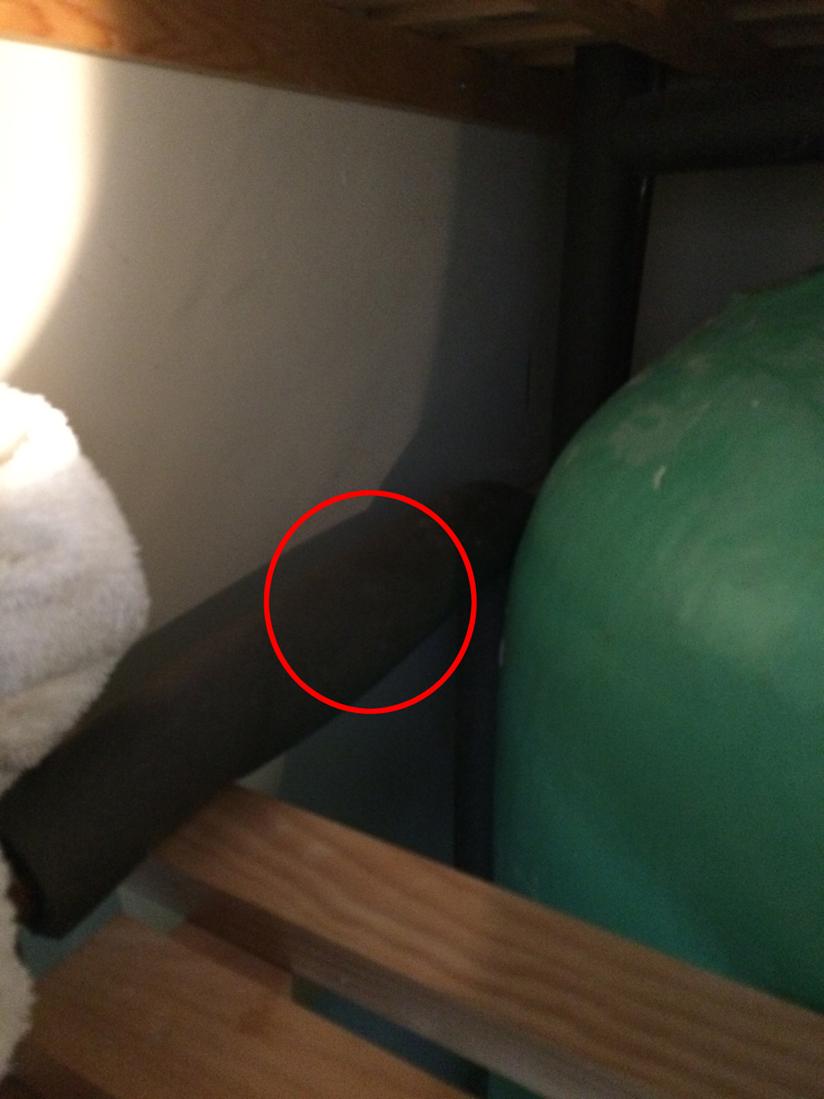

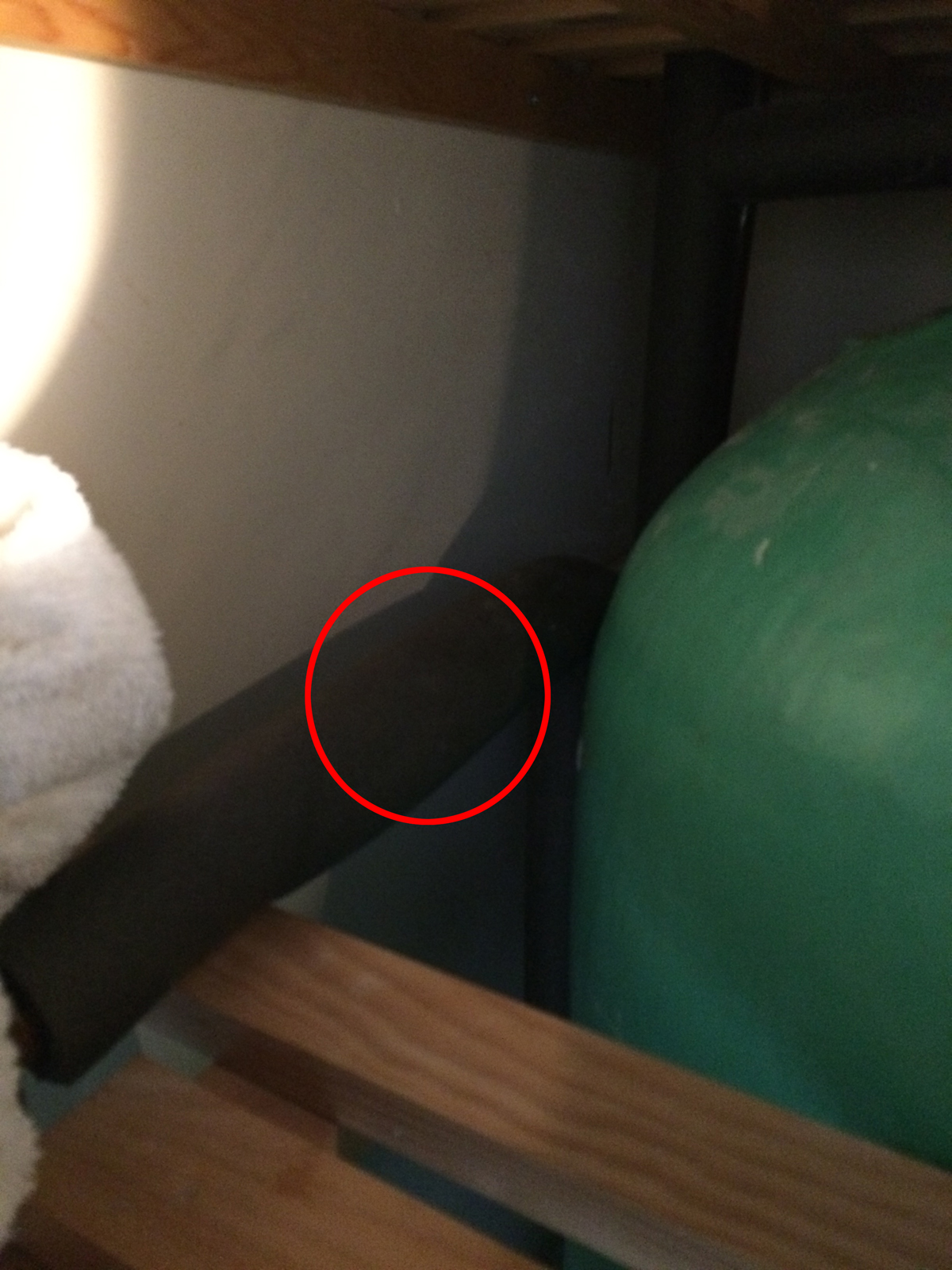

Ive re-done the magnet test, and im getting a pull along on one parts of pipe
I will attach pics of my system and label for reference
Rob
update, i did the magnet test again, and at the part of the pipe i've indicated in poss-block.jpg image, the magnet pulls, infact the magnet holds there, this is before it reaches the bend to come back down and into the cylinder, at entrance into cylinder it feels cold, also the out from the cylinder feels cold and gets warmer the as it disapears under the floor of the cupbload (pic above with red valve), i have the pump on 3 for a bit, in the hope extra flow might move any debris, but i think im screwed.
I saw a pic of someones pipe that showed how narrowed it had gone for them, can any cleaner added to the system help break this up?
Up in the loft ive just found an empty sentinal x100 inhibitor, god know when that was lasted added
Rob

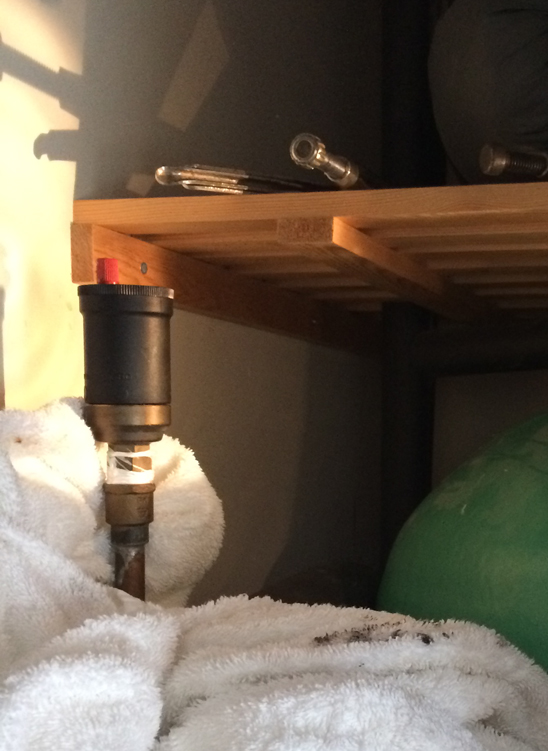

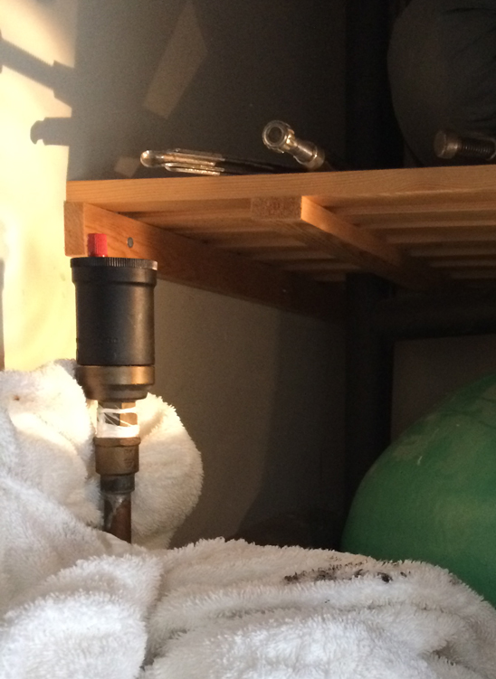

Is there a bleed valve on the pipe work going into the top of the coil on the side of the cylinder?
Post some pictures.
Andy
Post some pictures.
Andy
do you mean the air vent? this is at the highest part of the pipework towards to cyclinder, thumnail attached, if so, ive had this stripped down and cleaned, when i opened the vale again, i had a rush of air, and tiny trickle of water
