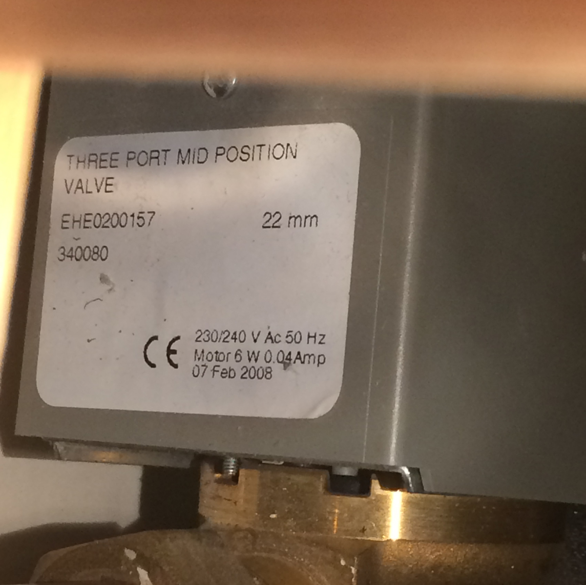

The actuator head is the box on top of the brass valve body ( I assume that's what you call the powerhead,and are not just referring to the motor ) . If you show us pictures of the 3 port valve we may recognise it ,or look all around it for makers identification . Many can have the actuator removed from the brass body , you can then check the mechanical shaft below is turning freely, and fit a new actuator .
This is all i have picture-wise of it, there was an installation guide nearby a Wolseley company with the only reference to a model number was something on the sheet 95C-10952
Does the valve have the word "center" embossed on the top ? I think it is supplied by wolseley ? It's quite old ,the label says Feb 2008. I think replacement actuators are still available. But I can't remember if they can be changed without draining the system ,I think they can. Ring wolseley to confirm.
Hi, there is no embossed lettering on the unit i can see, but the leaflet says 'CENTER' at the top with 4 square boxes (like the microsofts old windows logo)
