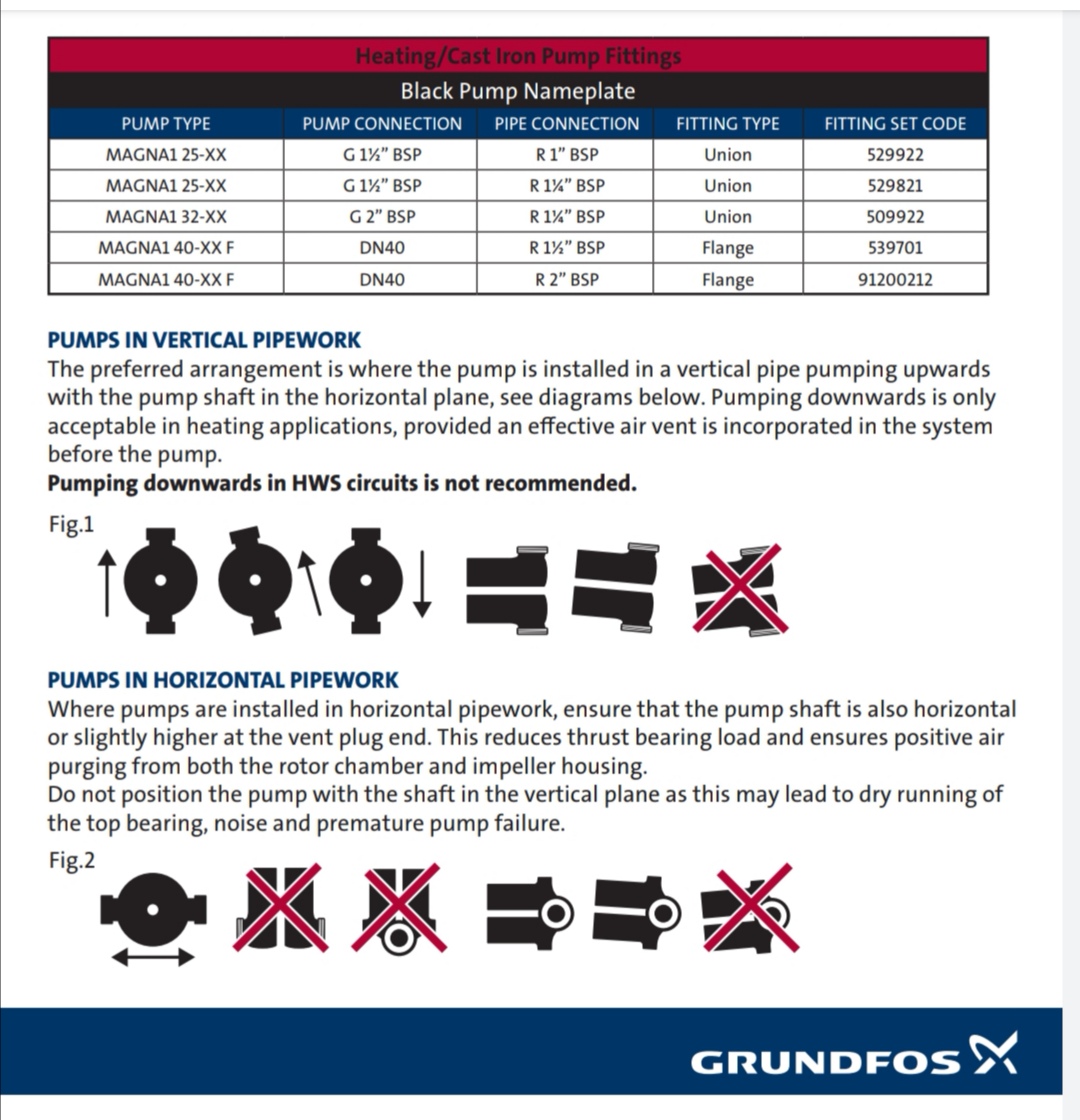

Also note that your circulation pump is not in an ideal orientation.
Yours is in the bottom right orientation above.
Your pump may also be tired and not giving the oomph needed to get things moving.
