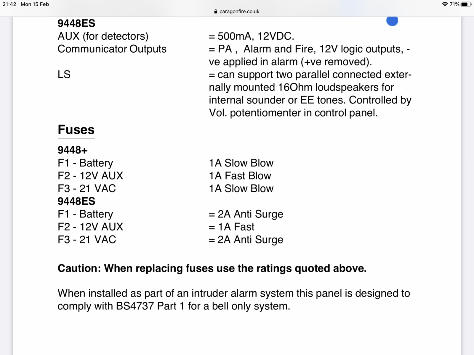

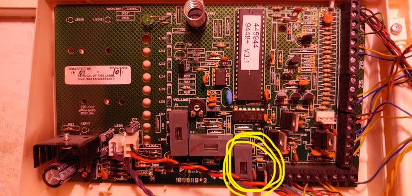

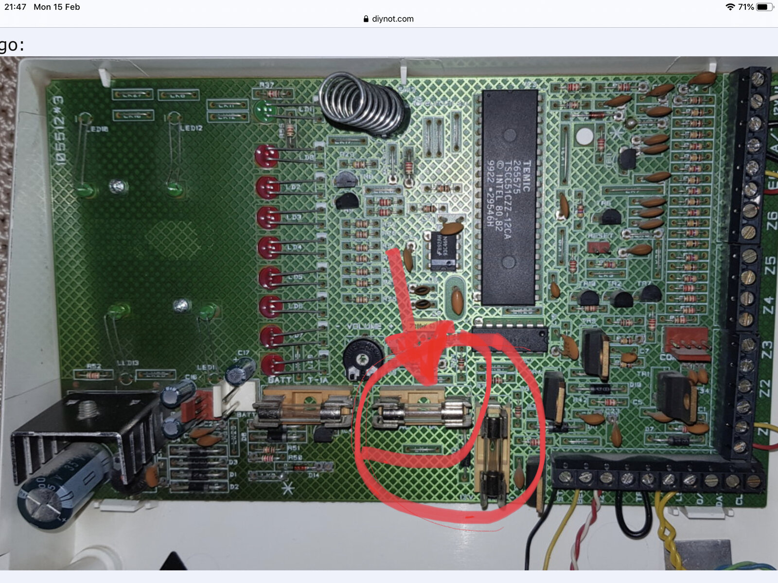

Thanks - but which fuse, where? The one between the main unit and the junction box seems fine (or the green light wouldn't be on on the main unit, surely)?
Thanks.
Ok ...what panel do you have as the 9427 is just the keypad part number ....you will have either a plastic endstaion with keys or not ...or a metal box ...inside is a pcb on which there are various fuses ...
7C5B8D35-2E95-42AE-8F26-0649E009530B.png B7D09F34-E518-48A8-911E-BC2F5843B235.jpeg. 1AMP FAST BLOW FUSE
