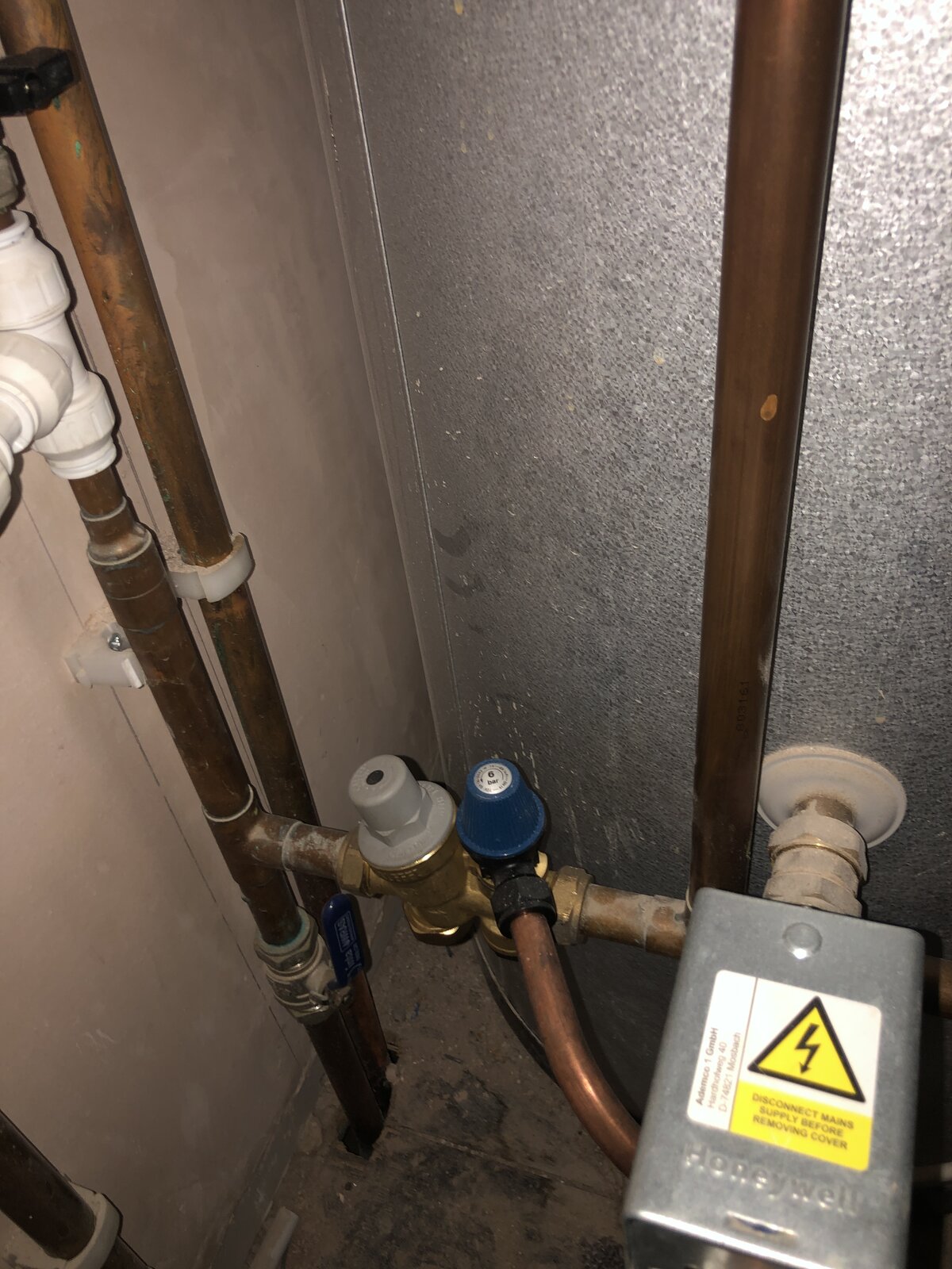

@Madrab the EV is fed from the cold side, just after the PRV which is low down there is T and the cold pipe travels up and into the bottom of the EV tank.
@DP they tried replacing the PRV a few weeks ago.......worked for about 3 days then noise started again!

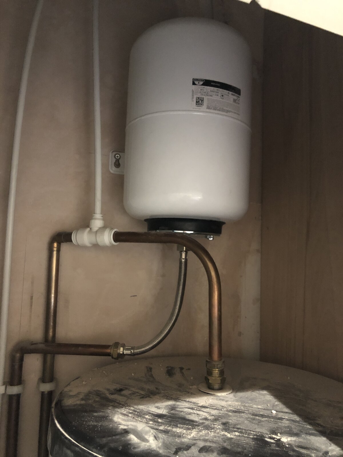

Couple of pics of set-up below.....I cant upload video of the noise but happy to e-mail to anyone who thinks they may be able to help.

Looking at your setup, you do not have balanced cold feed from that combination valve
Ensure your cold water isolating valve is fully open

I'd still be looking to depressurising the EV, take it off and check the pre-charge pressure with the vessel cold and off the rig and then refit. I'd also be tempted to remove that flexi and try hard piping it.
The noise is usually vibration in the system caused by pressure fluctuations, I've found it can be air in the vessel as it contracts when the water is heated and then expands as the pressure is released when a tap is opened. Do you find you get a little rush of HW to start then it settles? As @DP mentions the PRV can sometimes cause it as it ages and the spring starts to weaken and fluctuations in the system makes the jumper bounce. If that'[s been replaced though then that should rule that out.
Be beside the vessel when you know it going to makes the noise and hold the pipe below the vessel and the base of the EV you may be able to localise it where it coming from.
