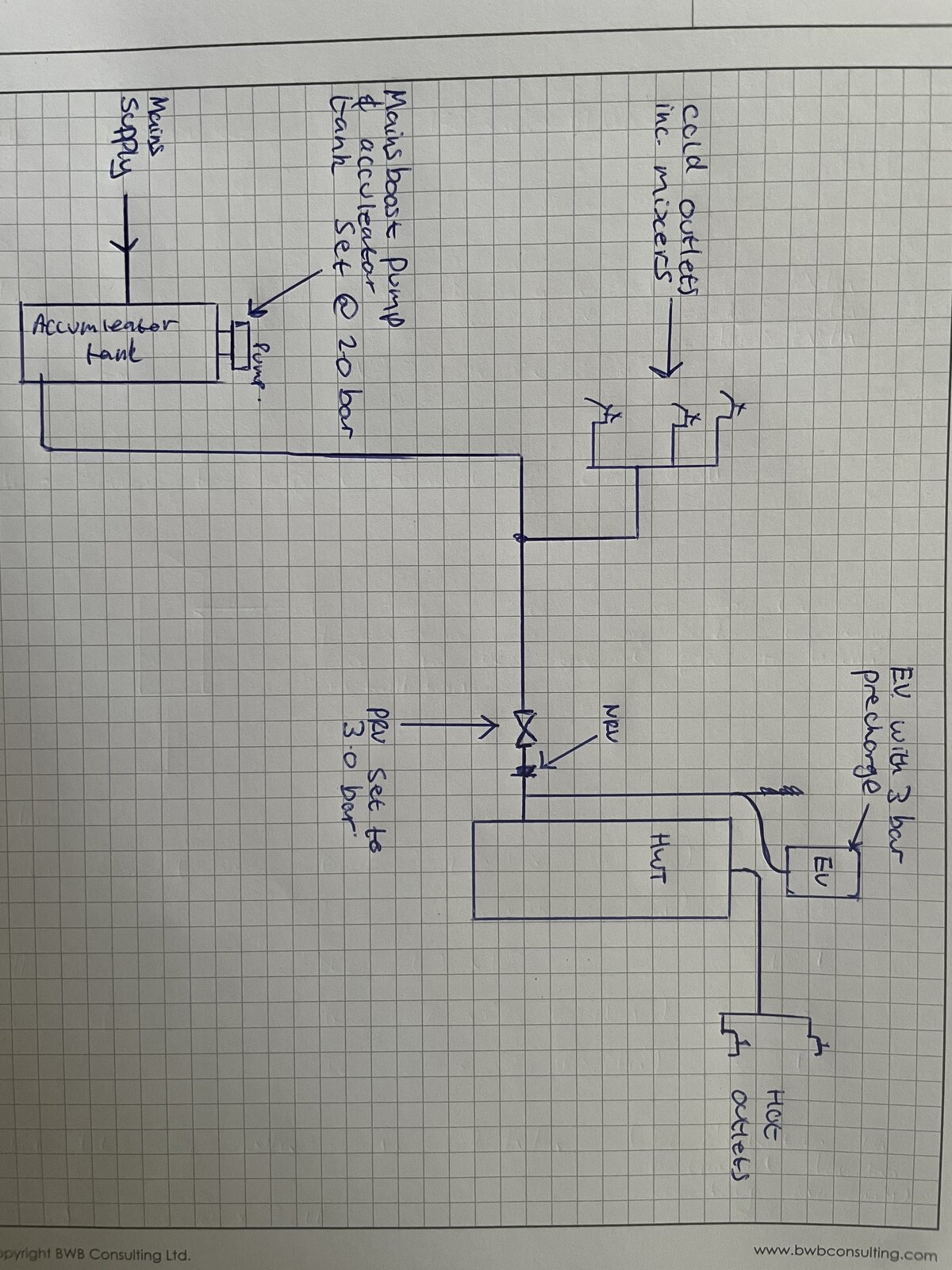

Noise from unvented hot water system
Do you know what your water pressure is downstream of the PRV, has it been checked physically checked? It's definitely an EV issue. After a bit of thought, I believe it's the baffle in the throat of the EV that causes it, and it's due to the movement of pressure from the EV to the pipework when the HW tap is opened. Balancing the pressure up between the EV pre-charge and the Water pressure minimises the movement of that pressure, may need a bit of fine tuning
Downstream pressure is regulated by the accumleator tank which is set to 2bar….are you thinking drop the precharge in the EV to 2bar? I See the logic…
EV pre fill pressure should be set 0.2 bar lower than the cylinder cold water pressure.
As said the vessel pre charge should be set to site conditions, if you have 2 bar static pressure downstream of the PRV your pre charge would need to be set to 1.8 bar if you leave the gauge on you will set it rise to 2.0bar. The diaphragm closes off the outlet if its too high and farts as it releases the pressure built up when heated.

Sounds like I need to get the plumber to tinker with the pressure balance. He was telling me everything was balanced as I have an accumulator tank with a mainsboost pump, the pump is set to maintain a pressure of 2bar…..see diagram below.

Re the accumulator, normally if its a pumped accumulator, its first drained down and pre charged (like a EV) to 2bar (whatever the minimum pressure required) the pump should then charge/pump it to say 3.5bar to 4bar and then cut out, the accumulator will then give between 33L and 40L for every 100L of accumulator capacity in falling to 2bar.
What is the accumulator volume and do you ever see the pump at any other pressure other than 2.0bar.
pump pressure is set to 2bar with a 0.2bar differential, tried increasing the pressure to 3bar but made no difference. It’s 250L tank with a 1.4bar precharge. Pressure rarely fluctuates
If you are happy with 2/2.2 bar then grand as the accumulator will supply 12.5L while the pressure is falling from 2.2bar to 2.0bar and should mean that the pump would remain off for ~ 30 secs if the demand is 25LPM.
So a EV pre charge of 1.8bar should be spot on and the EV shouldn't be the cause of your problem at that setting IMO. You might also note the HW cylinder and the EV volumes sometime.

You have a combination valve with its PRV presumably set to 2.0bar but you are supplying this at 2/2.2bar from the accumulator, this may result in erratic control as a PRV needs ~ 1bar differential to work properly. You might consider removing the combination valve and just install a NRV with the 6bar expansion valve. Also presume that the cold water PRV (if installed) is working under the same conditions, if so, maybe just remove that also?, food for thought anyway.
Thanks for all the help, really appreciate it. Combination PRV valve is set to 3 bar and it was the first thing that got changed.

The PRV is set 3.0bar and the pump/accumulator pressure is 2.0/2.2bar so presumably the PRV is wide open at all times and shouldn't interfere with the flow/pressure.
What all ways surprises me is that there is rarely if ever a pressure gauge installed in the HW cylinder which would surely give some info as to system performance.
OK, that's a bit of important information .... you are using a pumped accumulator running @ ~ 2bar. Is it an ST?
As a first, the engineer should be looking to align the pre-charge closer to the input pressure to minimise the differential once the cylinder is fully heated. It sounds like there is a 'sweet spot' with the EV where the pressure release through the EV's baffle is causing a resonance, creating the 'fog horn' noises. You did say that a new PRV/Control group was installed? That would generally rule out the PRV. It may also be an idea to calibrated the PRV closer to the Accumulator's output.

I am quoting OP post #38 which if the Accumulator is actually being used as a accumulator would imply that the cold cylinder pressure could be as low as 1.4bar since the accumulator precharge pressure is set to 1.4bar, the pump is set to 2bar, so should the PRV be set to 1.4bar?, it is presently set to 3bar. 1.4bar would seem low for a unvented HW cylinder.
Also the accumulator is being under utilised as it will only flow 50L in falling from 2bar to 1.4bar. I would expect the pump to be set to ~ 4bar.
