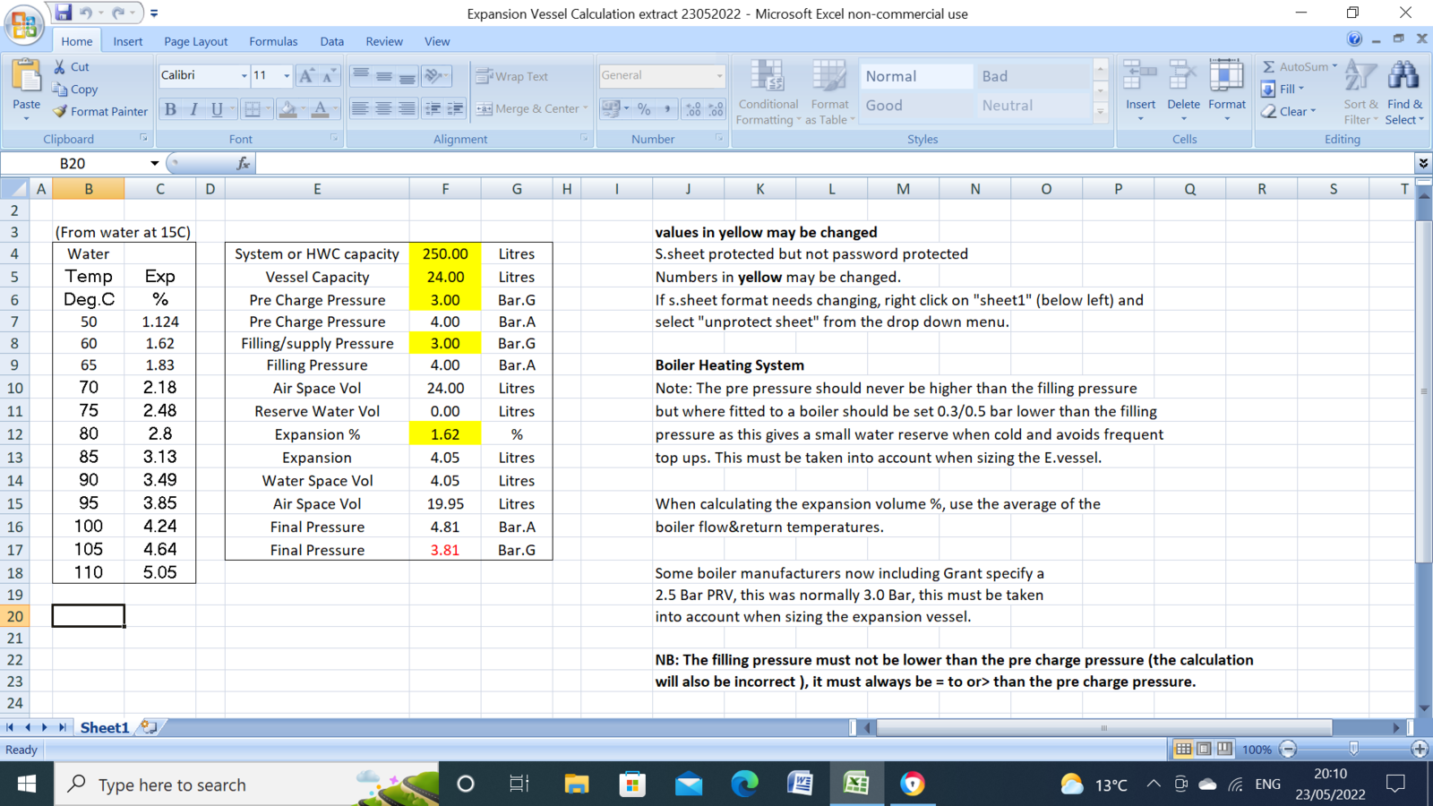

Unfortunately, I cannot download a very useful and simple spreadsheet that I put together ~ 40 years ago but have included a screenshot for info. Anyone who would like the live version can PM me with a email address and I will attach.

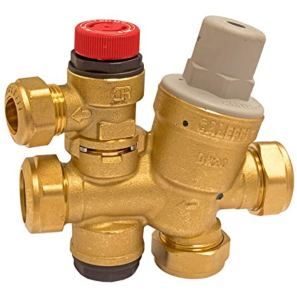

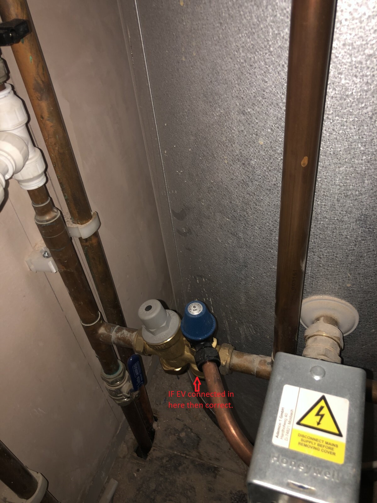

Can you see exactly where the EV outlet pipe is teed into the system, this is very important. (may have asked before).
If its installed in the cold water supply before the combination valve set which has a non return valve incorporated betwwen the PRV & the expansion relief valve then effectively no EV and every time the cylinder reheats then the expansion valve will eject a litre or two of water at 6bar pressure and may cause problems when opening a hot water tap first thing in the morning or after every reheat.
Post 12 I think shows it connected in correctly, after the PRC&NRV.
