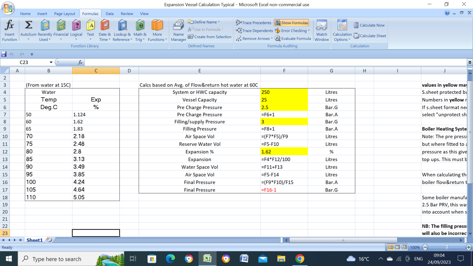

For interest or for anyone who would like to configure their own to see the effect of different volumes here is my s/sheet with simple formulae for building one. Cannot post file.

The main reason for having a EV installed in a UV cylinder is to only allow a modest rise in cylinder pressure after a full volume reheat, normal rise will be less than 1bar on any cylinder with a EV volume of 1/10th of the cylinder volume and assuming a cold cylinder pressure of 3.0bar. I have seen several UV cylinder installations on the continent with no EVs but all had expansion relief valves, debatable IMO if even these should be considered as a safety device. The only real safety device on any pressure vessel is its own PRV which would be better termed the cylinder safety valve. All pressure vessels can be run safely right up to the safety valve setting since its setting is at the safe working pressure of the cylinder, cylinder test pressure is 1.5 times the working pressure.

What are the volumes of the UVC and the EV?
