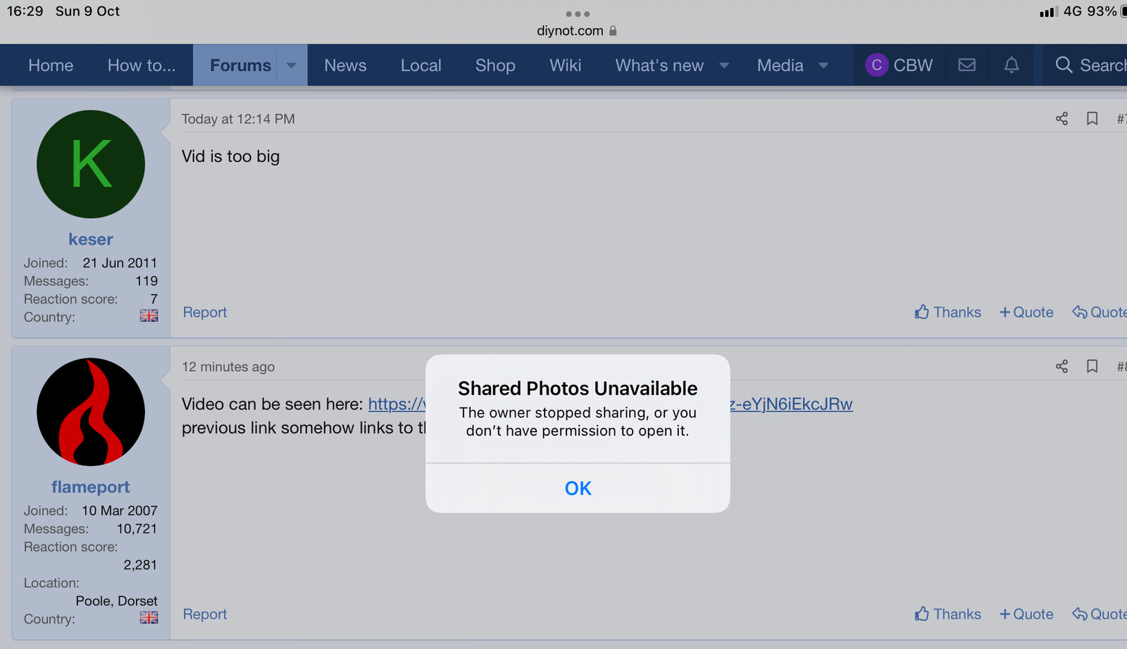

You might as well be speaking Chinese to me my friend so I’ll posta video if it helps
Sorry .. cant access that .. you need to upload your vid to the media library on this site, then embed/link to is in the post.
Look at the top of this page and click on media drop down arrow, then select your media. Then add new media, create a new personal library then upload the vid to it. Then link back to it here.

Ok people bear with me, as you probably worked out I’m not the greatest with computers i will come back to you
