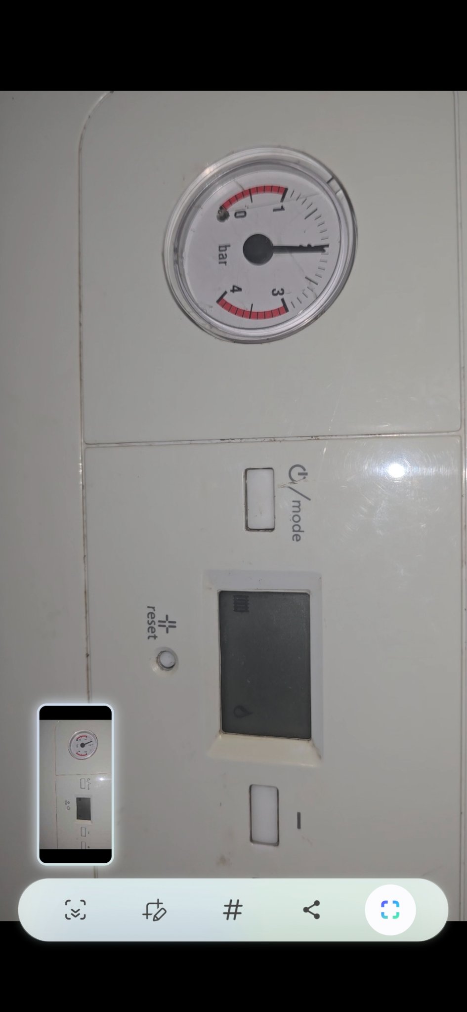

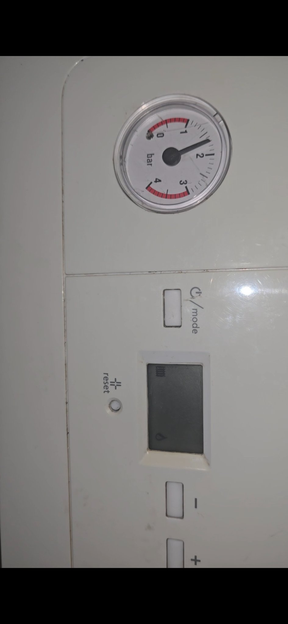

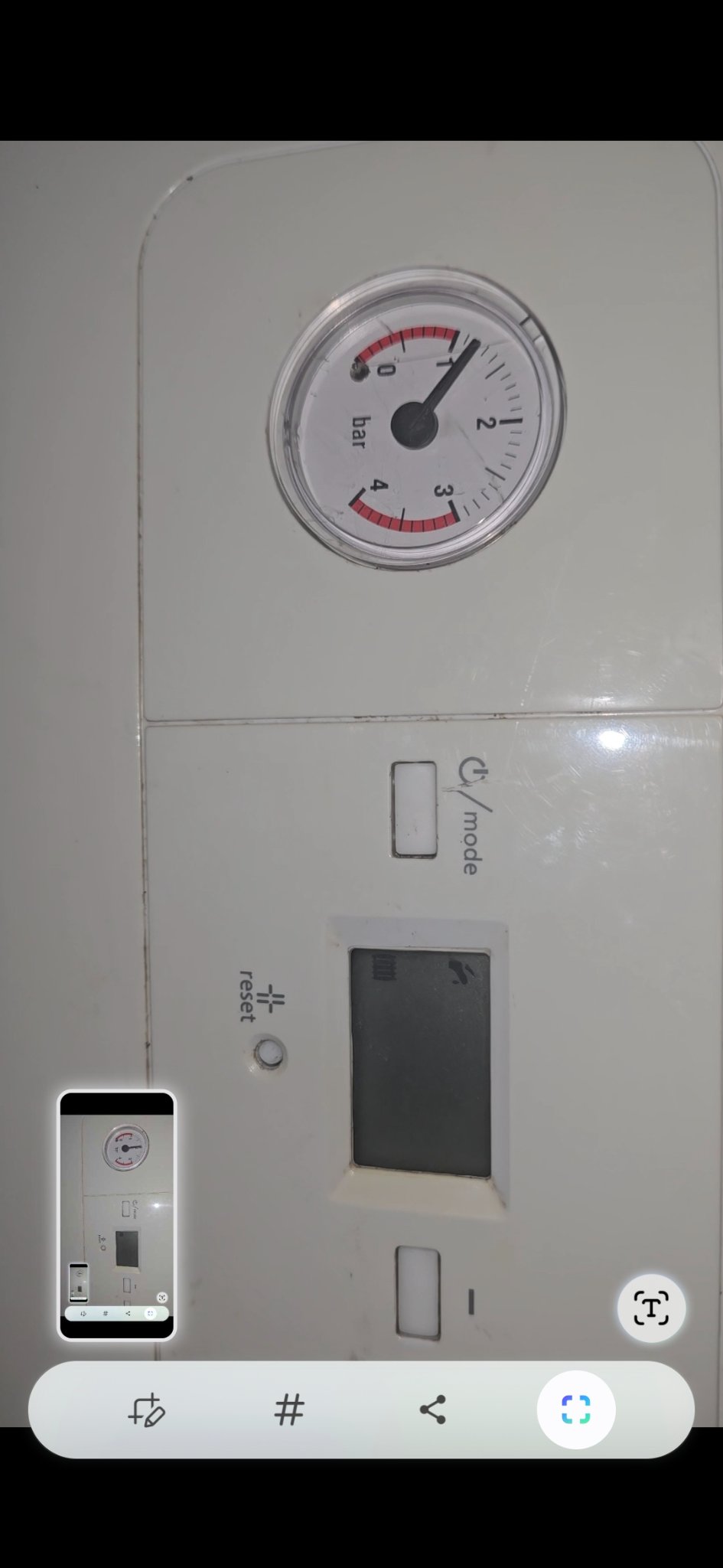

I have a Heatline Capriz 28 boiler. New Heat exchanger, new diverter valve, new outlet let pipe. Central Heating works fine, but the problem is with the hot water. When turning the tap on, the water temp is not consistent e.g. hot, warm, cold on loop. The flame indicator on the boiler switches between being on/off a tap is running. Plus the pressure dial seems to fluctuate when this happens. Again, it loops, flame icon comes and goes. I have attached a few pics. Please help. I've had professionals look at the boiler and the issue is baffling

So could the flow sensor cause pressure gage fluctuations? When I run the tap the hit and cold fluctuations are coupled with the pressure gage running up and down between bar 1 and 2.

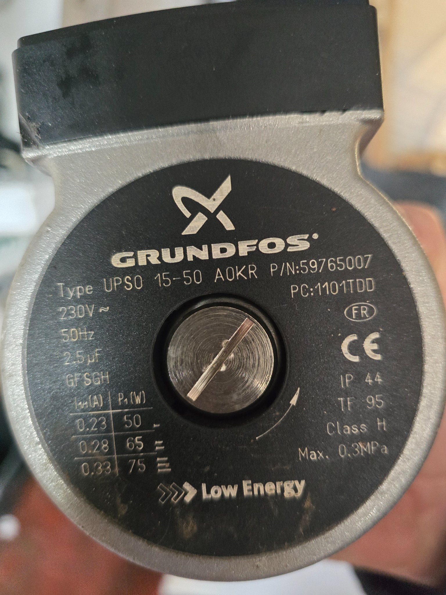

Do you think The pump can be ruled out? I purchased a refurbished pump with a top speed of (setting 3) pw 90, whereas my older one had a top speed of (setting 3) pw 75. Pictured.

Pressure fluctuation might suggest overheating situation
While the appliance is called a boiler, water should never reach boiling temperature. In your boiler I suspect that is happening hence the pressure indication fluctuations
