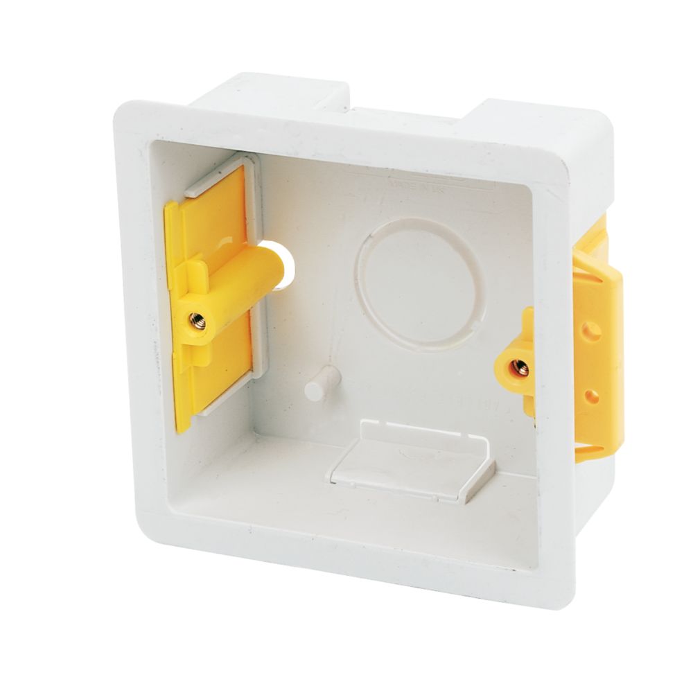

Some flat plate fitting really don't suit standard dry line back boxes, the standard dry line boxes lip prevents the fitting sitting correctly.
Interestingly TLC have recently add dry line boxes for flat plates to the range
http://www.tlc-direct.co.uk/Products/MTFDLB1.html
Dry line box
Standard dry line box
Notice the lip is now all but gone :eek:
A retro fit / swap back boxes is the cure, although I'd suggest you just buy one single box and one socket double and try first.

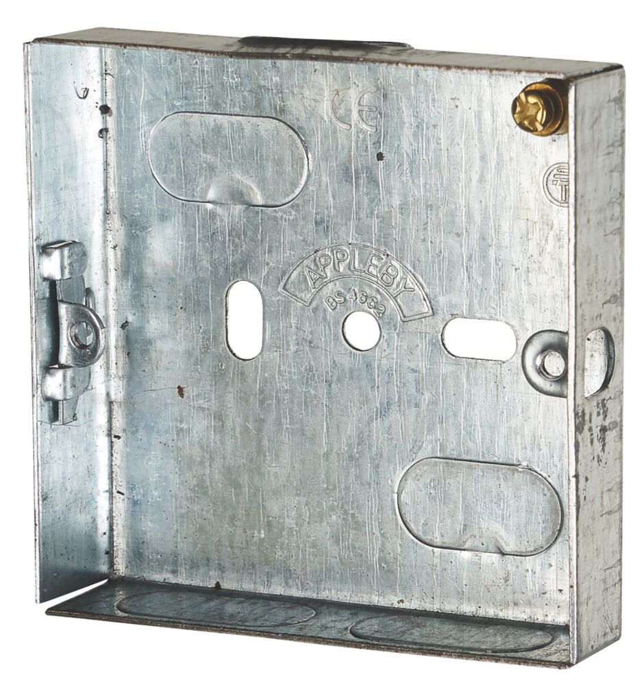

When you say you bought "standard back boxes" with the sockets, do I take it they are the metal ones?

We used standard back boxes that I bought with the sockets and switches and this is a picture of one of the fittings,
So, what do you call "standard"?? There are 25, 35, 47mm deep boxes.
If you supplied him with 25mm back boxes and flat plate sockets then you've only got yourself to blame.
The basic white plastic socket shown in the photograph should fit on a 25 mm deep box though - unless there is an excessive amount of wiring behind it; or the box hasn't been recessed far enough in. This could be bad workmanship.
