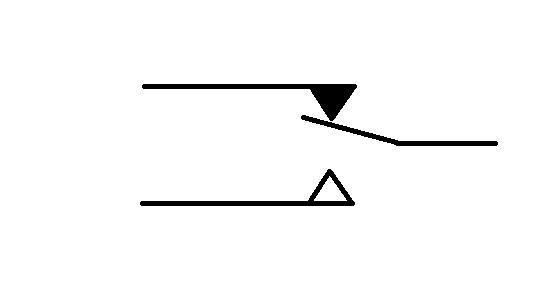

For schematics the following is an informative way to show a relay contact and its function
The black contact is the contact made when the relay / contactor is not energised.
The white contact is the contact made when the relay / contactor is energised.
The wiper / moving contact is drawn to show the normal / quiescent / inactive state of the equipment.
