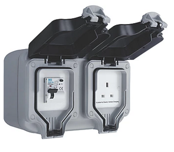

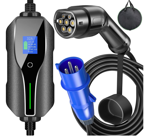

I do see a problem with EV charging, it can be a dedicated unit with all bells and whistles, but it can also be a plug in device, so the same 32 amp commando socket can supply the welding set, or the EV charger. And as installer we have no idea if the 32 amp socket is going to be used for one of these 1698462936964.png and it does not need to be 32 amp there are also 10 amp versions, and we actually see 13 amp sockets like these 1698463174315.pngsold as EV charging points, the lead may have RCD and RDC built in, but they seem to lack any loss of PEN protection. Also of course no load shedding if the house use goes up, for a car parked in a garage I suppose there is no real problem, if OK to use a welding set in the garage then also OK to charge the car.
It is only when used outdoors when the problems arise. And the same problem arises using a patio heater which is class I. @flameport has given a good answer, as usual, but at the end of the day, one needs to use some common sense. I have looked for type F and B RCBO's single modular width and they don't seem to be made, we can get double pole as far as the switching goes, but only the line goes through the overload. And we can now get type A rather than the old type AC.
As you say there is BS 62916 however I have a copy of BS 7671 although out of date, but I am unlikely to ever see a copy of BS 62916. I note the pictured lead says
as to if it really detects loss of PEN not so sure? Just glad I have retired and don't need to worry about things like this.
