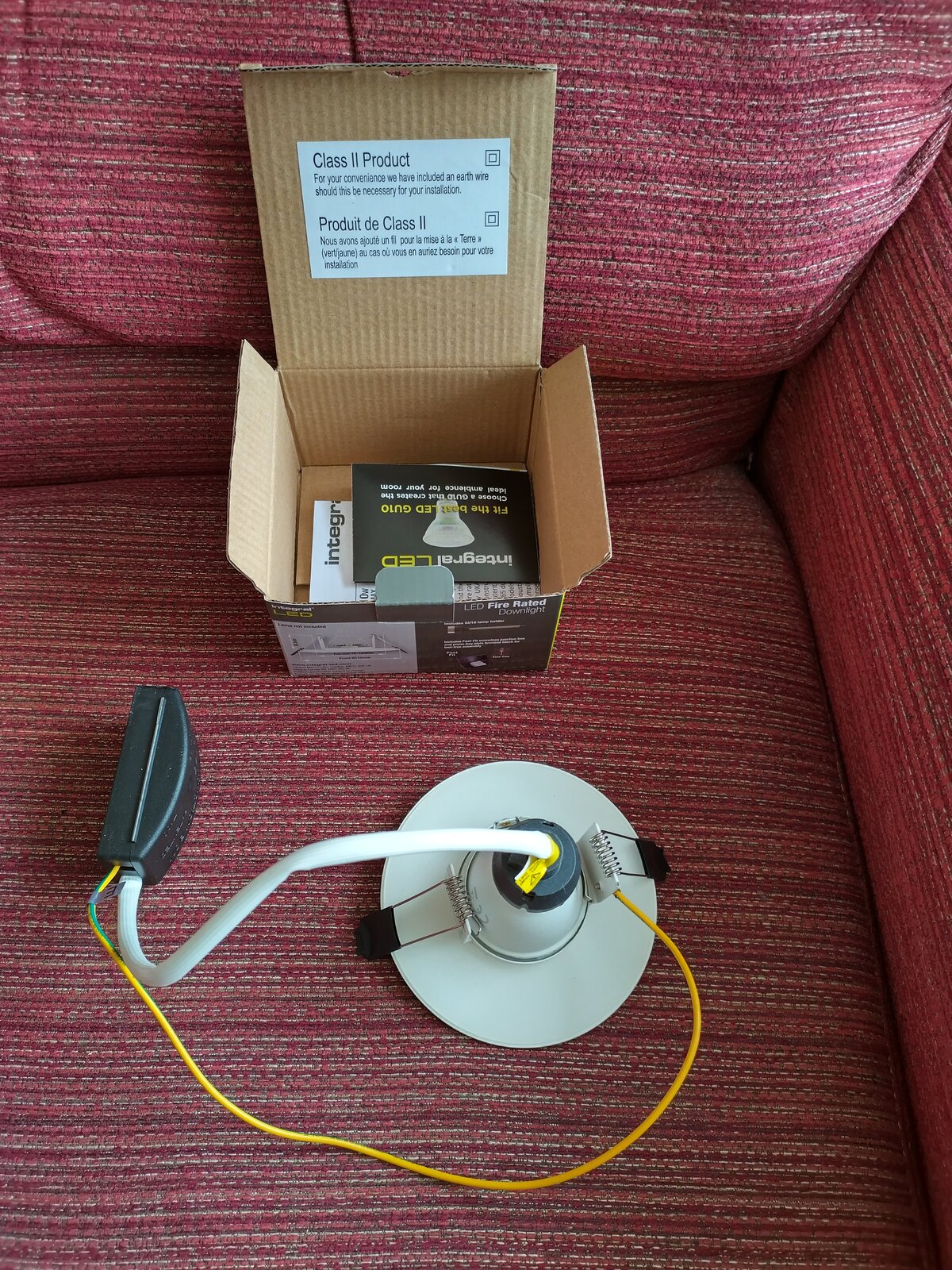

Usually, light fittings have their Class designated by the manufacturer.
If they are Class II, surely there should be no earth connection?
These are Integral Evo Fire Rated downlighters.
My guess would be that the maker of this product is able to test and certify them as Class II products but they don't feel confident that the item will remain as a class 2. It could be modified in the future or depends on how is it installed.
Yes, that's all I could come up with, but still didn't seem a good enough reason.
Thing is - I probably would fit the earth lead, even though it's apparently not needed whatsoever.
On some light fittings, this would be a good idea - notably when you have a metal Class 2 fitting and it comes with one of those bloody awkward cases around the connector block.
But it's not sort of light fitting, because the flex separates the light from the connector, and since it's a downlight the connections aren't ever going to be directly near the downlight itself.

Most fittings (even Class II) have an earth terminal so you can ensure continuity round the circuit.
But in this case, once you've parked your CPCs, they are connected to the fitting body, thus making it Class I.
So, given the label on the box and the fact that when you use the provided enclosed terminal block it earth's the (Class II) fitting, what would you do?

Well, the body is metallic.
Are there any exposed-conductive-parts?
Well, there shouldn't be if it is Class II!
