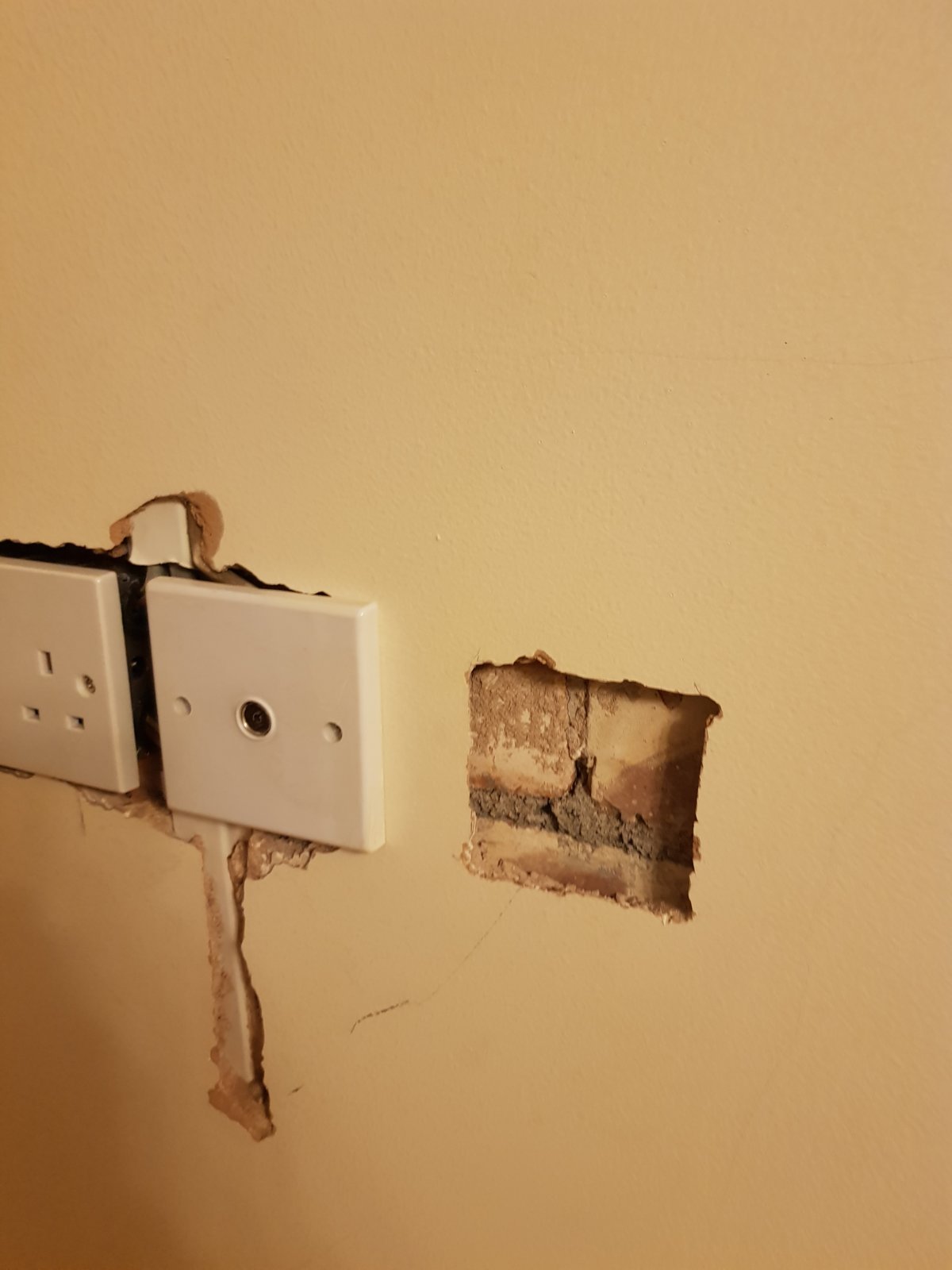

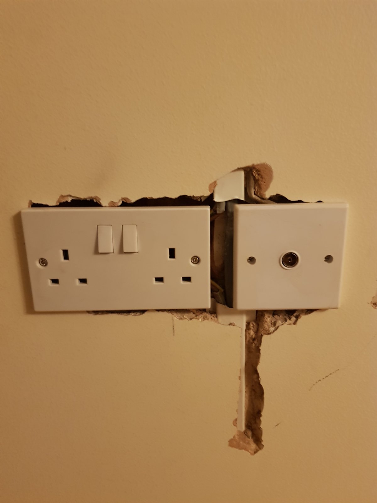

How would you tackle this situation please?
See attached pictures - would Toupret filler be OK in the gaps directly or is there a better, tidier abf more professional way of doing it?

Yes I'd do that with Toupret and feather it in.
There is a big chunk of plaster that will need to come off too by the look of things, plus any other loose.
Then care with the finish and emulsion as otherwise you end up with a dead smooth patch that stands out a mile.

Looks fine to me - you need a bit of a gap around them to position them correctly and to be able to get a bit of plaster between the box and existing plaster. As said, plaster first then filler but just make sure the back boxes are deep enough and are at least just below the finished surface of the existing plaster.

And to get back to the original question, as a DIY person, what we did on our own chases full of loose crumbly lime plaster, I painted some watery PVA all over, let it dry, and then my wife used scrim tape in places where necessary with easi fill, and blended it in then painted the whole wall (colour change) So far it's all still intact.

Ive recently moved into the house, first-time buyer and total novice DIYer. The wall was left like that, not sure of the history.
What's the purpose of PVA please and what do you mean by blended in?
the pva was just because the wall was crumbling so bunging in filler it just fell out again, much like a greased and floured cake tin nothing can stick. With the pva all the loose stuff was held in place long enough to slap the filler in the hole and go solid.
Blended in just means get a nice smooth edge between the filler and the original wall. If you use normal skim gypsum plaster you have to skim the whole wall, but with the filler you can press harder and get a feathered edge. And if necessary sand the bumps off later.
Thanks John. So would you unscrew the sockets, make good and then rescrew back on the wall once set?
