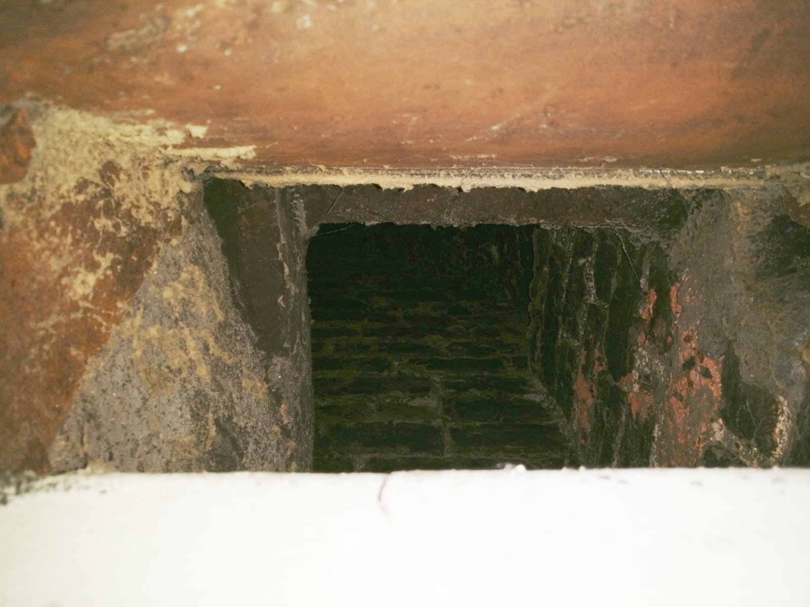

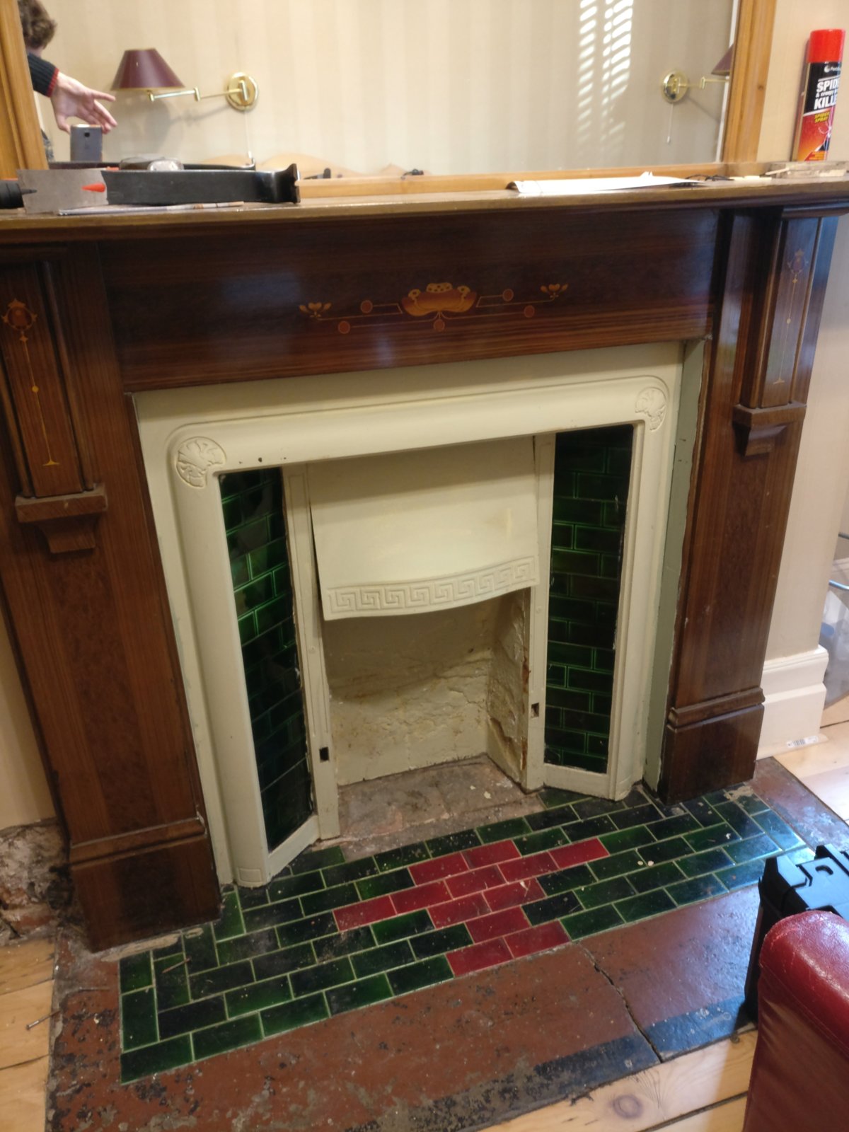

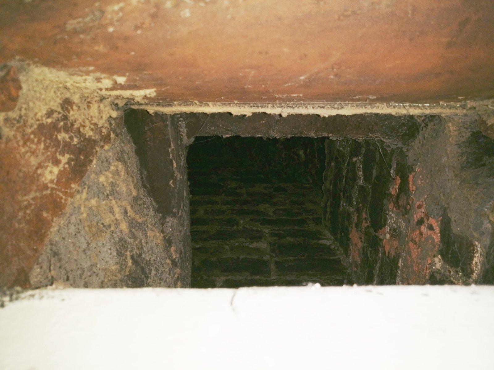

Our Victorian house has an open fire-place in a reception room that has not been used for decades but was never blocked up at the top or bottom. It is assumed the flue is in good condition since others were inspected and cleaned, but we will get it checked out before use.

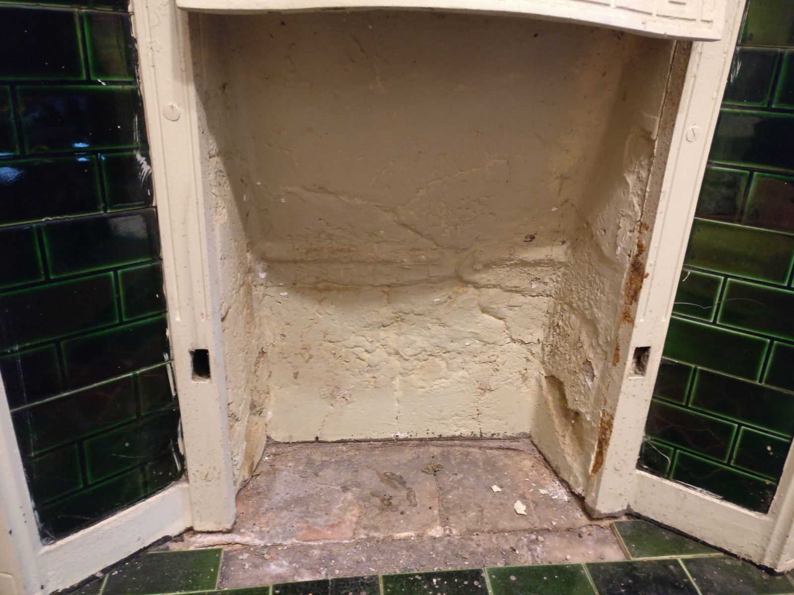

Despite the surround seemingly still being in place from when it was used, it has been made decorative i.e. we found the tiled hearth intact under a carpet, and it seems they put in a false brick back (as it is very shallow) and painted it. This looks to be maybe 20 years ago.
I am looking to have it renovated but am curious to light a fire in it as the hearth and grate remain. My only concern is the false bricked back as obviously fires are supposed to have fire-proof render, fire-bricks, etc. Is the reason for this to stop the bricks being damaged, or for safety?
If the former, I couldn't care less if the bricks crumble since I will be removing them. But we've all heard about how bricks and stones can explode in campfires... is this a risk here or can I safely light a fire?
Minor query - if the fireplace was never closed off is it subject to regs or classed as existing despite not being used for a long time?

The condition of the flue and chimney should be checked as you say, it also makes sense to rebuild the hearth and clay fire back to meet to current regulations, especially as yours are not as originally installed!
Carbon monoxide can escape into upper bedrooms.
And as you say the chimney will need sweeping.

Back to the fire, anyone got any concerns about laying a fire against potentially regular painted bricks? It's not going to shatter, is all I really want to know.
Ordinary bricks tend to crack and spall over a period of time, as the constant heating and rapid cooling causes fractures in them. In the kiln the cooling is controlled to prevent this.
I would bypass the trouble and expense of intrim open fire , your going to need a liner eventually so just as well drop one down now and fit your burner?...have you a picture of the opening?
I don't necessarily need a liner. And if I do, it will be several weeks until it could all be done (my chimney pots are 50-60 foot above ground so a scaffold is needed)... but it's cold now :)
I would have thought that if indeed your pots are that high you would need a liner and posibly an insulated one at that. With a small efficient wood stove, the gasses will be so cold by the time they gets that high they could struggle to make it out the top:eek:
