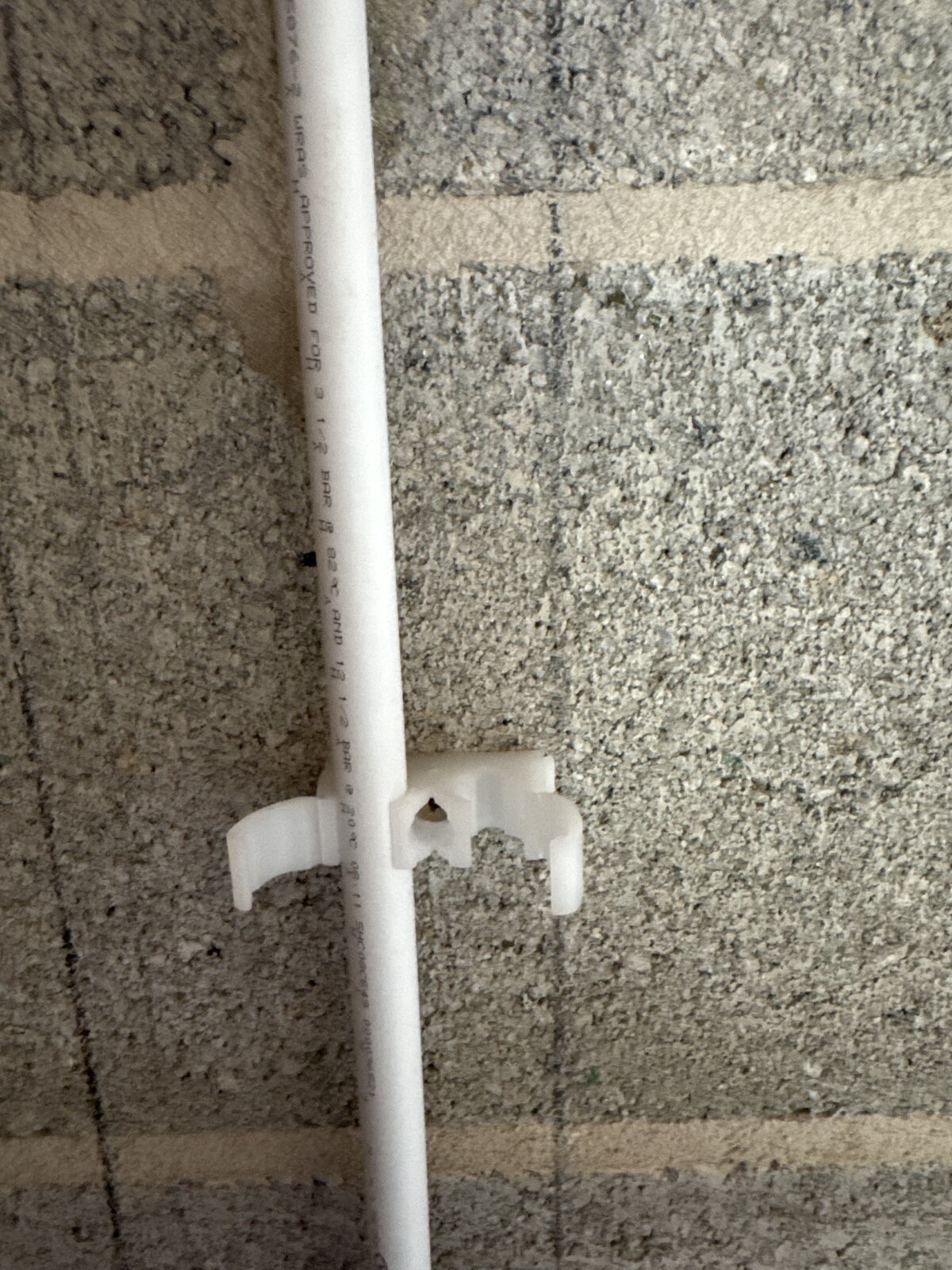

When pipes running vertically should hot pipe be on left hand side or right hand side or doesn’t it matter?
Depends, if it running up to a shower then hot would be left, if it's just say running upstairs then it there isn't really standard. Just mark red and/or blue to keep track of which is which.

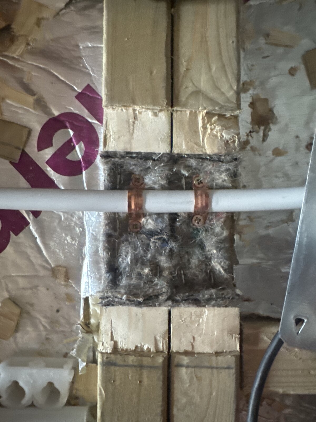

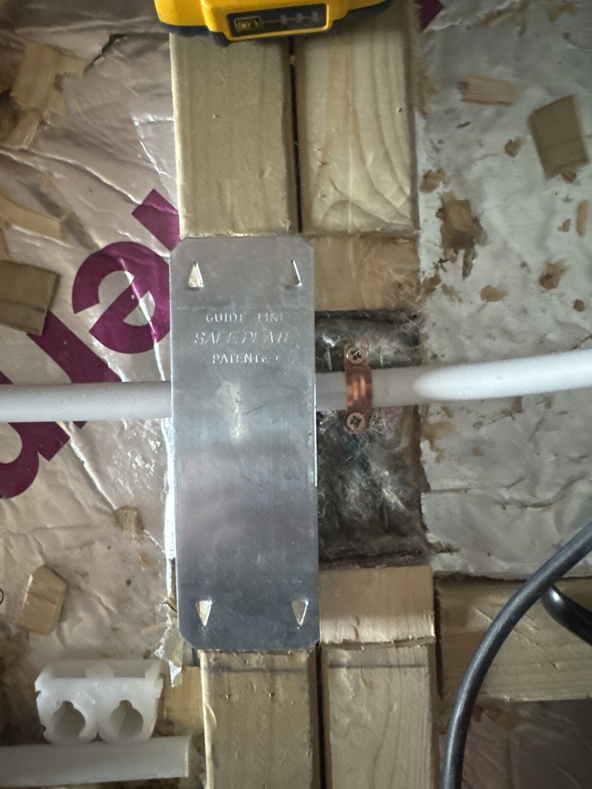

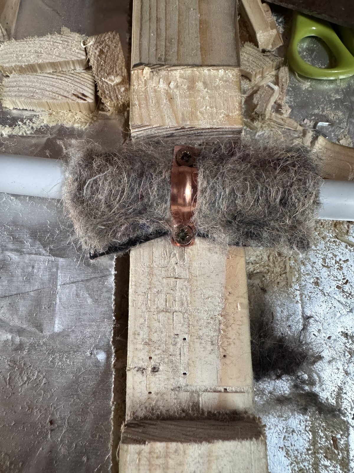

Sorry last question on this. This look all good notched out. Horse hair felt then saddle clips and then a safe plate above it
