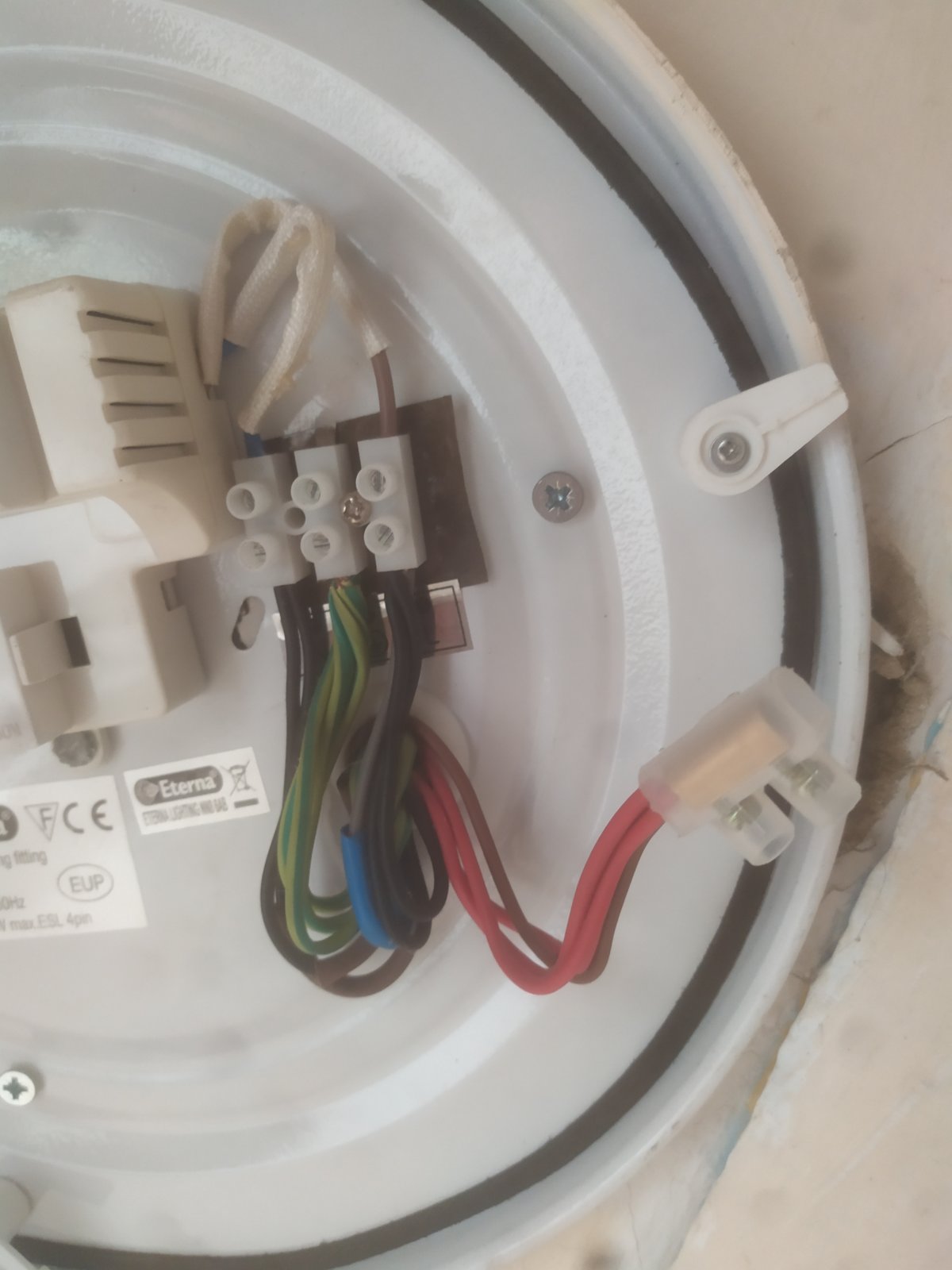

I refer to Picture 1 in Post #11
It appears that the four Red/Brown insulated conductors are connected via a Twin "Set_Screw" connector, similar to that used in Australia for the required "Protective Earth" connections. (To be sure, to be sure.)
(See https://commons.wikimedia.org/wiki/File:Australian_Set_Screw_Connectors.jpg)
This is the first time that I have seen such a connector pictured on this UK site and I wonder what is it that these connectors are called in the UK?
I note that, unlike the Australian dual/twin screw connectors, which are required only for Protective Earth connection, the connector shown is "blind", in that no conductor may protrude from it.
I also note that the way in which this connector has been installed would not be approved in Australia, since none of the conductors are visible beyond the ferrule concerned, indicating that the (last) set-screw may not have connected with the conductors.
A "normal" (Single-Screw) Australian connector may be viewed at https://www.sparkydirect.com.au/p/30007/nls-single-screw-insulated-electrical-connector-2.html
The "Dual Screw" connector may be viewed at https://www.sparkydirect.com.au/p/888595/nls---two-screw-insulated-connector---50-per-jar.html
