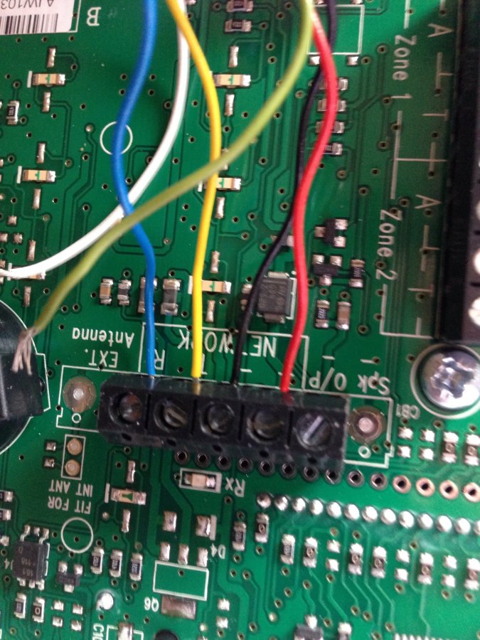

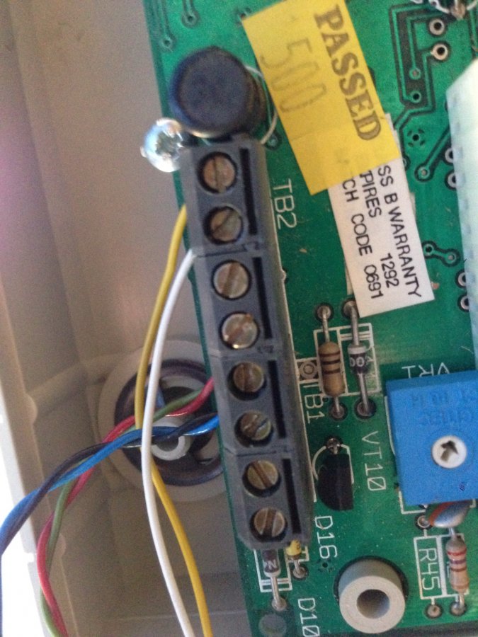

Apologies for all the posts. Wanting to replace a old remote panel with a new Texexcom one but confused (as usual) how to wire it. Any help very grateful.

Wire to network on rkp , red 12v black 0v , T yellow , R blue , same at panel end , giving you green and white spare.
Thanks again Sparkym.
Think I'm heading out of my death with this install sadly.
