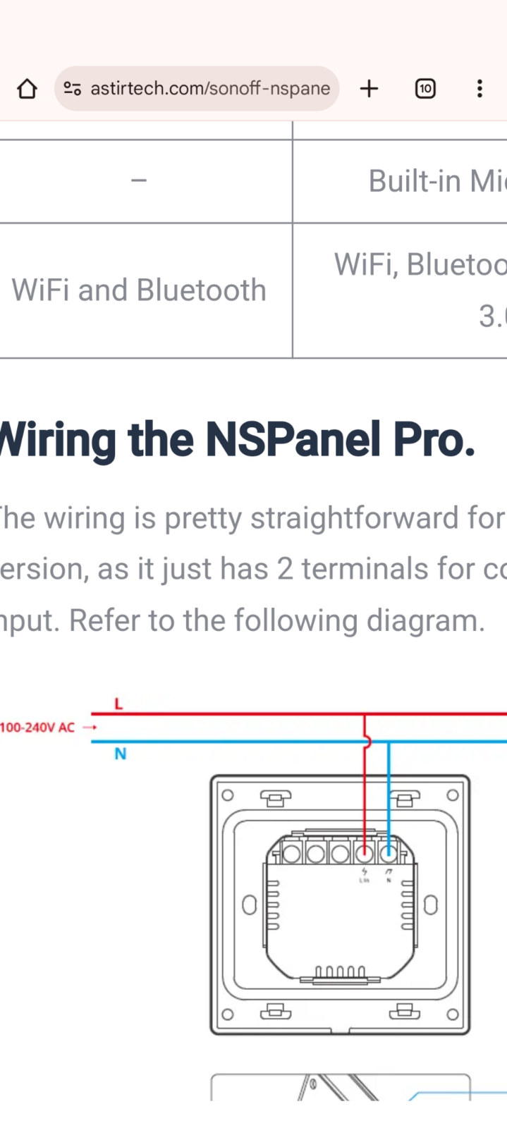

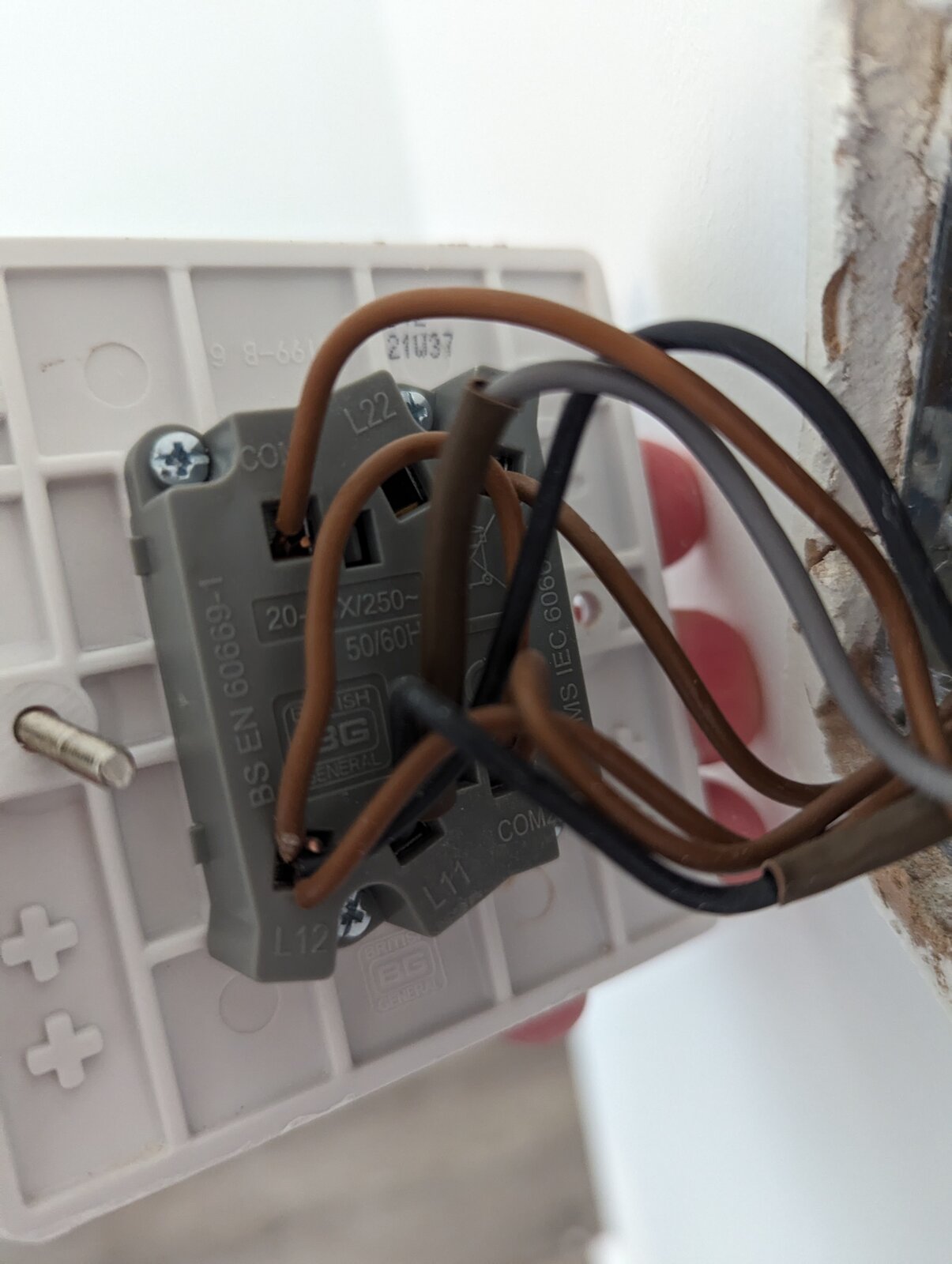

Hi I'm looking to fit a smart display called sonoff NSPanel pro which will also require me to fit a deeper wall box.
I plan to replace a double switch with the above, the switch is currently setup for my outside light and hall light. I have smart bulbs so don't use the switch at all.
What I'm trying to work out is how do I wire the NSpanel which requires Live and natural and still complete the circuit so the light basically ignore the current switch setup.

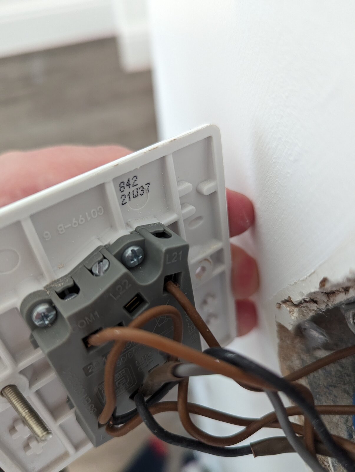

That light switch doesn't have any neutrals, so unless there are other wires that are not shown in the picture, you can't connect the panel there.
I assume there are 2x 3C&E and 2x T&E with 2 blue and a grey in a connector, especially as there is a blue visible in the pic.
As I only really need power and the neutral and not the switch function could I just put all the connectors into a wago and then just take COM for the Live for the NS panel
