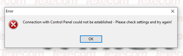

Wintex on a Windows 10 PC is not connecting. No changes since the last time I connected.

But if I try to connect in Wintex I get
The Wintex settings are unchanged from when I last checked it a few weeks ago.

you need the ip address, port and udl password (default udl password is engineers code if the udl password box hasn't been completed (note app will not accept engineers code for UDL it must be in the UDL password box in panel).

well sally I would double check the following to start with.
ip we know is correct as we can see com ip page
check wintex panel details tally with those in the panel, so ip, port, udl
check wintex panel profile version versus panel versions (menu 4 on keypad).
check router that the port is still forwarded
if I was setting up a new profile I would need panel version, UDL, ip and port, and that the router was forwarded to the correct ip and port
if you are using the app and notifications you may not be able to connect if the panel is sending out a notification.
You can turn off notifications but need to do so via the keypad and disable the ARC.
If you still cant connect via the keypad, engineers code, 7 yes 8 yes, scroll to com ip port, press 0 what is displayed (bottom right should be 21).
if not press reset, it should clear and go through a sequence when it stops whats displayed?
I have sorted the connection problem. :mrgreen:
I replaced all the Account files from a cloud backup, and it worked straight off. Although everything looked OK in the Wintex settings, something must have been corrupted - there are four separate files for each account.
