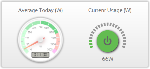

New toy an energy meter plug in type, plugged in chest freezer in garage detached to test how the new toy works, however some odd readings.

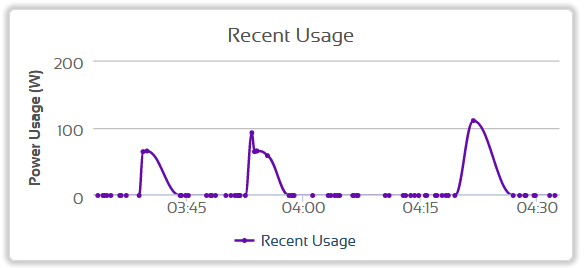

The freezer normally reports using 63 watt however these spikes show varying wattage up to 111 watt and not even, this time of morning I have not opened lid.

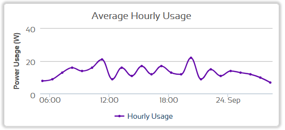

Although I can see how some hours the motor will run 4 times and other times 3 times that chart seems to have more variation than expected, yesterday the average watts were 14 today average watts are 11, at 200 kWh/annum the average watts should be 22.8 at 14 watt that's 122.6 kWh/annum which is not far out but at 11 watt it's 96.36 kWh/annum which seems rather low.

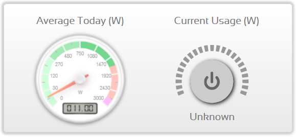

So question is the freezer super economic or is the energy meter missing data transmissions? every so often I get this.
does it store info then send again, or if it loses internet or local connection does it mess up the reading, it would seem my info is sent to a server then back to me, so the local hub may still be getting info but not sending it to server so I can read, or it could be the local hub missing chunks of info. Main reason for device is so when I remote switch it, there is a report saying on or off, although I can switch other sockets they don't report their state. So the power measuring was not really why it was bought. Idea is to use it in my house so if I get the green light I know power is still on so I can see if my RCD has tripped, a report as above would mean a visit to check house. Normally it shows like this.
So I know freezer is running and using 66W the Unknown is not that often seen and when it is watch for a minute or so and back to green light. However I expected the chest freezer to show a regular on/off patten except when door has been opened, but the patten is not regular, freezer only 2 months old so should be A1.

Although I can see how some hours the motor will run 4 times and other times 3 times that chart seems to have more variation than expected .....
I think you are probably expecting too much - I would not have said the the hourly averages show more variability that I personally would have expected. For a start, in terms of those hourly averages, it's obviosuly not only the number of times the compressor comes on in an hour that matters, but how long it comes on for on each of the occasions. There are some difficulties with the plot of 'recent usage' (see * below), but, IF (see ** below) each data point represents the instantaneous power at 1 minute intervals, it looks as if the first 'on period' could have been anything between 1 and 3 minutes (present at two 1-minute readings), the second between 2-4 minutes and the third between 0 and 2 minutes.
Why this variability? Well, few things in life are constant or perfect, and there are many factors involved. For example, the differing durations of the on-periods suggests that the hysteresis of the thermostat is not consistent/constant, even if ambient temp remains unchanged (and the freezer is not opened!). Also, we are talking about pretty small currents. 65W at 230V is only about 280mA, and it would not surprise me if there was an appreciable (variable) measurement error. I would also expect that the amount of current used by the compressor probably varies a little according to the compressor temperature - which will depend on the duration of the ('cooling') intervals between 'on' periods. In the plot, the third 'on' period appears to have used a higher power than the first two, but the interval between second and third is much longer than the interval between the first two.
* As I said, that plot of 'recent usage' is a little odd. If each of the data points is at 1-minute intervals, for some reason they are not evenly spaced on the x-axis. Also, the fact that the points have been joined with a 'smooth curve' is potentially misleading, particularly for a load which (presumably) is either 'on' or 'off'.
** As I said, I initially assumed (since the axis label is silent about details) that the data represents the instantaneous power consumption at 1-minute intervals. An alternative would be that they are 1-minute averages. That would not alter the generality of what I've said above, but it would explain why there are a range of figures, rather than just 'on' and 'off' ones.
As above, I suspect that is partially due to a less-than-perfect thermostat (varying hysteresis). Indeed, even if the ambient temp were constant (and not opened) you might well find that a corresponding plot of the temp inside the freezer did not show the perfect horizontal line which you 'expected'.
And it's not the power used but non regular patten which is worrying. What do you think?
As above, I would personally not 'worry'!
