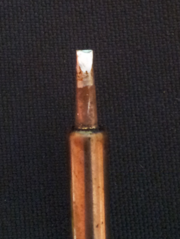

Copper has natural wetting (sticking) ability for solder. When oxidation fails it, sand it and it's new again. If properly tinned, I believe oxidation will never happen. So, there's not even a need for sanding. I was going to make a thread asking why copper was discontinued. I didn't think anyone would have the right answer, and so I refrained. The real reason I think was to cut material cost for more profit, or deliberately fail products so people had to keep buying more. Copper tips are less suitable for the high temperature needed for lead free solder. It seem to me lead free was a deliberate attempt to fail consumer soldering so that they don't repair stuff and have to buy new. 400C needed for lead free will damage components and melt insulation, also cause rapid oxidation on copper. 60/40 solder melts at 190C. That's all a DIYer needs.

BTW, copper soldering tips, I have never used them, and I don't consider myself to be particularly competent at soldering. Can you (please) explain how they make soldering easier, and are there any caveats (regarding temperature etc).
Copper soldering tips can be recovered from the unrepairable loss of surface wetting that happens to Iron clad bits when left hot and not being used. It only needs a file to expose some fresh surface. Not suitable if your usecase happens to need one of these:

So for general use where you need to keep the iron warm, but there are other tasks between each joint then they work quite well. If it is for constant prototype soldering on a large board, then Iron tips kept wetted at all times are more useful.

Some tips are copper plated iron, and once you burn them or the copper wears off, they are useless. Best is proper copper, which can be easily cleaned and in a temperature controlled system of some sort.
an iron coated tip is prone to losing its ability to adhere to the solder, but if used correctly are the right answer for many soldering tasks. The pure copper tips dissolve slowly into the solder.
Never heard of one of those. Only heard of iron plated copper. Then nickel plating on top of the iron plating. The idiotic freebie china tips that come with irons are pure iron with a thin coat (probably sprayed on) of nickel on the wetting tip. Temperature destroys that quickly, turning them useless. A pure iron tip cannot be wetted.
If you had to solder or repair one of these:
https://www.topline.tv/drawings/images/qfp/QFP208T19.7-2.6.gif a copper tip would not last at all and would need constant refiling.
You are contradicting yourself. Firstly you say copper dissolves slowly. Then you say it will not last. How can it dissolve slowly and then stop lasting quickly?
My tip stays tin plated during and after use and ready to go without the BS elaborate preparation described in youtube videos. Why would it need filing? Compared to conventional tips, I can have as large a wetting area as I want with copper. The discoloration on the silver is flux. The dried flux is not black because the temperature isn't high enough to carbonise it. The apparent "chip" at the end of the tip is a mirror reflection of my monitor.

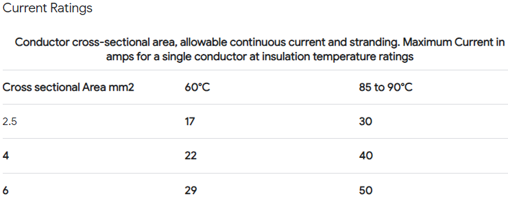

Oh, so they provide it with enough 6mm cable to reach the consumer unit?

You mentioned a 30 amp cooker. That requires 6mm cable.

I buy from china because I dare to win. I don't think you should because you are liable to cut yourself an arm off from accidents. 4800w / 220v = 22a = 2.5mm cable.
