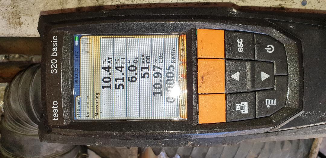

Oil boiler riello burner firing fine until i put it back in boiler ?
Hi Guys . gave it a while to settle down is this looking good
Glad you've got it going again, but idealy it needs a combustion test to ensure you don't get the same again. soot buids up exponentially. It may take 3 months to get a light dusting, but it will doublre or treble in much less time than it takes for your light dusting.
Edit to add. You posted your test results whilst I was typing. Looks good.
