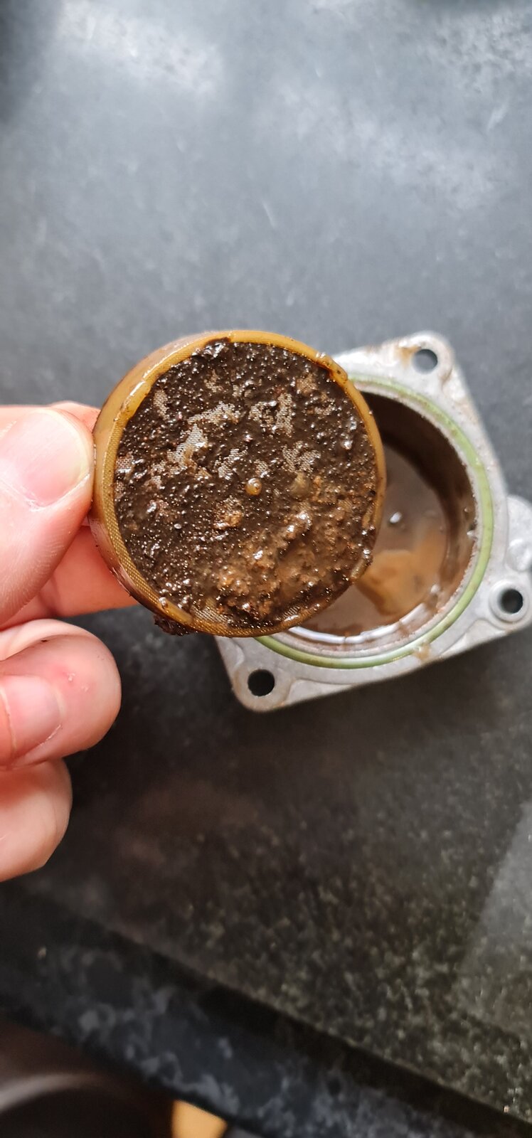

The normal f0 263. Is displayed after a burner lock out. This has been the normal thing when I switch it off at the wall after a burnout lock.
I went to the normal as it had been sitting for 8 months with no real oil in the tank and crud on the bottom, I bled it on the oil burner and out came some green goop pretty rubbery, this is post service as the gentlemen that serviced it had it running, but I warned it had been sitting for a long while.
Now it goes to start up initiates the green light then stops after about 2-10 seconds. Displays the 9f 855 error which normally points to air or crud in the system.
I've checked the lines, the water pressure, the light sensor which is clean, I've check the electrodes and looked at the nozzle but nothings coming up like obvious. I'm not an engineer as you can tell. Just learning as we go with a mechanical background.
I've got it perfectly clean, the engineers claiming it worked so unlikely to be a fault he's caused, but my question is, has the new nozzle likely to have clogged so quickly within a 2 week period with the system only being asked to do trickle heating? There was a fair bit of rust and what can only be described as muddy slime that came out before it went clear. When on I couldn't get real air, and pressure appeared to be fine when bleeding like it would spray you in the face at the right turn of the bleeder valve when initiating burn.

Have you had a delivery of oil since the service? If so, you may have disturbed the sediment in the tank and sucked this through. You need to thoroughly purge the oil supply from the tank, through any filters (cleaning/replacing them ) and not forgetting the filter in the pump. All this should be done before bleeding the fuel from the bleed screw, which should be done withot the burner running.
As above. Full purge of oil line and filters. Green goop sounds like more left behind and making it's way downstream.

Your description of the fuel is such that I suspect it is contaminated by water and microbial growth (emulsion / sludge). Apparently quite common. A random google find: https://www.beesleyfuels.co.uk/news/microbial-fuel-contamination-symptoms/ is worth a quick read?
I suspect the tank needs drained and cleaned thoroughly to remove all contamination... along with a clean of filters/housings and fuel lines. New kerosene added since moving in might be salvageable (not my forte, need an expert).

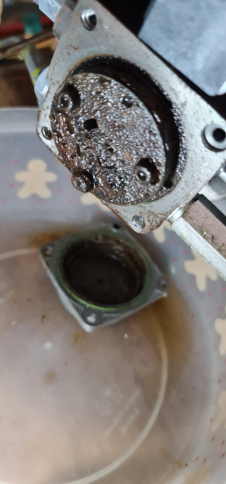

Err think I may have found the problem...
How is this not part of any service. No wonder the pumps die.
Ordered myself a spare filter too. Will clean this one up but that caked up there's no pressure and I've never seen a boiler engineer even look at the pump. Explains why I could get it to go clear on the bleeder but not on the system. There's a fair bit of rust there too which I will green scotch off.
I assume carb cleaner won't do it much of any harm. Will bath the rest of it before refitting
Oh and oilhead was right in a roundabout way. My problem probably exacerbated by sitting for a long time. Will confirm its working after that for future reference.
