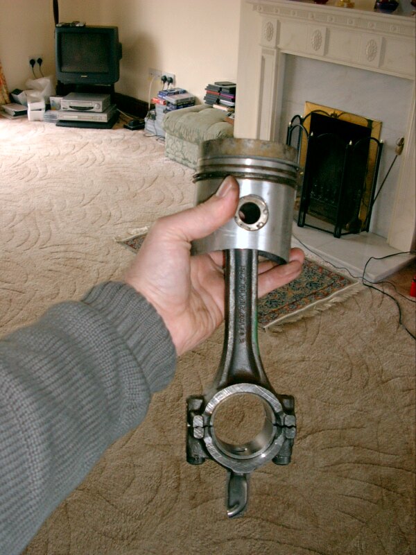

What does surprise me, is just how little pressure they need, depending on the design. My boat engine is a horrible, 10hp single cylinder diesel. It has no oil pump (or filter)! The main bearings are big rolling element bearings, but the big end is a conventional shell. The bottom bearing cap has a pressed steel scoop on it, projecting downwards. It's designed to dip into the oil in the sump at the bottom of each revolution and just scoop a teaspoon full of oil up into the groove in the shell bearing. That's it! That's the entire lubrication system! The little end is splash lubricated - as are the mains and the valvegear. About 20 years ago, I did replace the big ends, but only because the engine got some seawater in it and the rings rusted to the bore, so while I had it in bits, I thought I'd best throw a pair of shells in it. However, the ones that came out were surprisingly good! The engine's about 35 years old now.
All shell bearings work in a similar way. They don't rely on the oil pump to create enough pressure to provide a cushion against the force coming down the con rod. Just the viscous "shear strength" of the oil film. Obviously, in most designs, the pump is needed to make sure that all the bearings are "full" of oil at all times, but that's all the pump is doing. Basically the same job as the scoop on my boat engine.

Interesting! I must say I’ve never seen that on a diesel engine but it’s well common on petrol stationary types. On a motor of that age I would have thought the con rod would have cast in white metal, rather than replaceable shells. It sounds like a Lister or Petter.

A BMW no less! A D12. A rare beast these days. Back in the early '80s, BMW decided that they wanted a slice of Volvo's pie. Volvo having more or less cornered the small marine diesel engine market. They didn't design it themselves, they went to Hatz, a German supplier of small plant engines, and asked them to marinise one. It had a baby brother, the D7, and there were some larger ones too.
All the more remarkable, because it was intended to run on a straight SAE 30 grade mineral oil, so at operating temperature, it must have been practically like water!
Well interesting! Direct injection, looking at the piston. I'd guess these are directly water cooled and hand start?
Presumably this engine was designed to run on canals, being a wet sumper - unless the sump was heavily baffled.
What RPM are we looking at?
