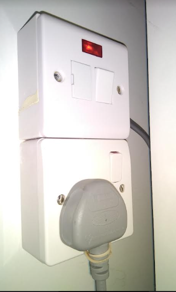

Moved a Laser Printer to the utility room without thinking about sockets :rolleyes:. Nearest socket is wired into fused switch socket for a freezer.
Can I plug in an adaptor and safely have the freezer and printer both plugged into that?

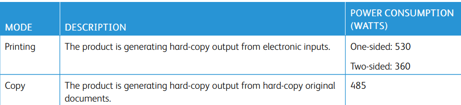

Laser Printer Xerox C15 - spec says
Here's the socket with freezer plugged in.
Yes, power consumption of both is far less than the 13A maximum.
Might the freezer switching on and off mean the printer needs surge protection
Very likely, but that was the case before you moved it. Surges don't stay local to the device which creates them, they are distributed throughout the building and even into other buildings nearby.

One wonders what the purpose is of the FCU is. Your freezer plug has a fuse after all.
I would remove both the FCU and socket and replace with a double socket.
Please don't give advice when you don't know what's happening.
Unless I've missed something
We don't know why the FCU is there.
We don't now if it feeds something else,
We don't know if it's from a spur feeding this socket and another (or more) elsewhere.
Recommending it's removal is a very irresponsible thing to do without establishing actually what is here.
Agreed that the best way would be to replace the single socket with a double. The op does state that the pic shows the freezer plugged in so the fcu must be feeding something else, there is a cable exiting to the right. Hopefully the fcu is fed from the socket rather than the socket is fed from the fcu.
Quite honestly I don't know what OP is saying and where conclusions are being derived from.
