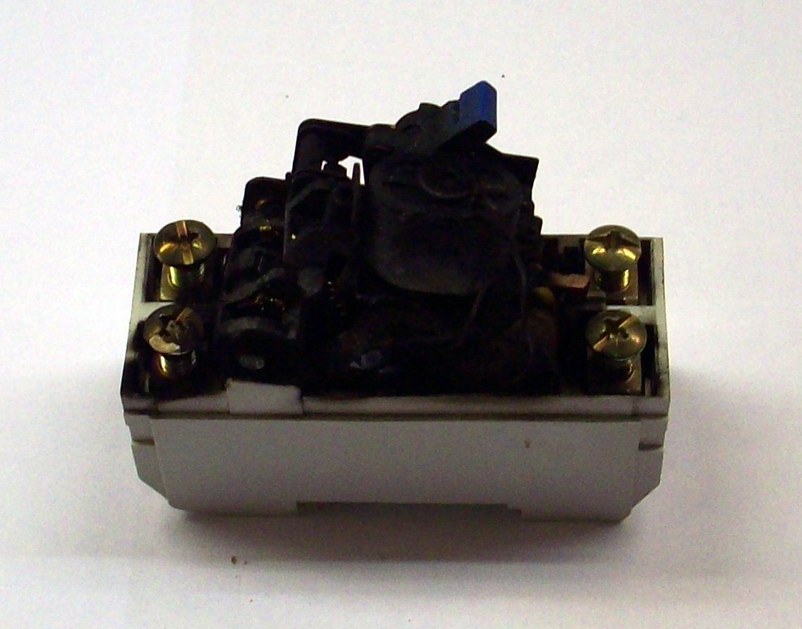

That rather reminds me of my oft-mentioned story about what happened when my daughter pressed the test button on her RCD ...
Kind Regards, John
That happened to me when I pressed the test button on an old QOH Square D RCBO..
Gave me a hell of a fright!
That happened to me when I pressed the test button on an old QOH Square D RCBO.. Gave me a hell of a fright!
Same with my daughter. There was a very loud bang and a cloud of soot (which took out the cutout fuse). Unfortunately, it has caused her to take a "never again" attitude to pressing a test button. In that case, the problem arose because when it operated, the trip mechanism somehow sliced through the insulation of the main conductors, presumably due to some manufacturing fault (although she had been pressing the button regularly for several years before this happened)...
Kind Regards, John
