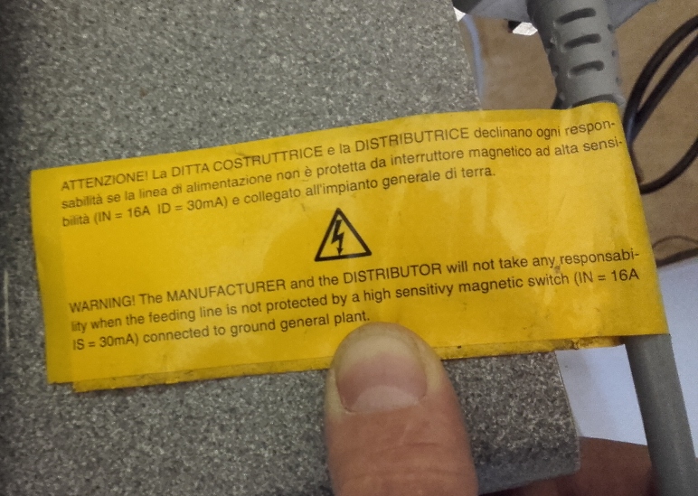

Some things certainly do seem to get lost in translation, found this tag on a fridge today. I get it, but I can't imagine the average user will have a clue what it means.
