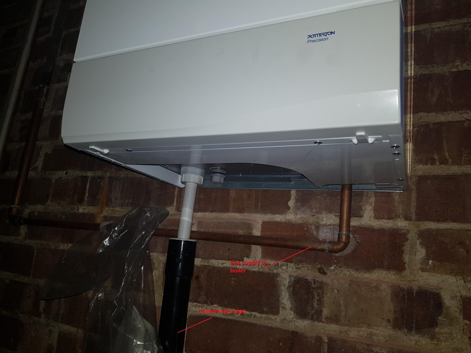

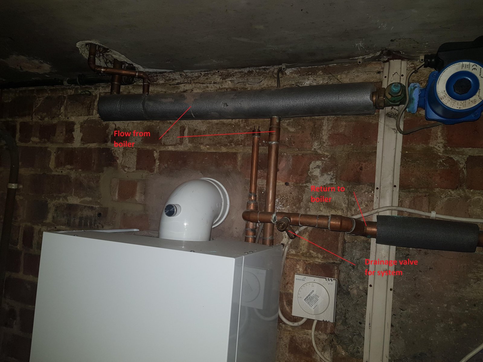

Next up and before the 1st question. Are the below correct fro the boiler end?
The boiler trips out every few days which i thought may have been a result of low/drop in pressure in the central heating but i guess not if it tops itself up.
How do you mean it trips out? Is it tripping your electrics?
yes, is the boiler in a basement ?
Boiler is in the garage. If the descriptions as marked are now correct. Why does the feed from the boiler split into 2 runs just before it punches through the garage roof into the house? Is this controlled to serve the Heating/rads and hot water supply to the cylinder separately?
I dont think so as both the heating and the rads need pumped water, I think the two pipes to the left going up through the ceiling are the Feed (15mm pipe) and the expansion (22mm), but I am just guessing as I cant see everything
That would make sense as the F&E tank that i believe to be linked to the heating is directly above those pipes in the loft. Now i have a good idea of the purpose for each pipe i will have a better look round tomorrow and try and trace everything to see if it stacks up. Then i will have a correct set of images with the pipes correctly marked to ask a few questions from.

Remove the insulation from the pipework above the boiler....that's an odd layout for the safety vent and feed pipe.
That boiler is a dog...it has the old Barcelona heat exchanger and every boiler it's been in has been problematic.
They are a pain to service properly and require regular attention (seals burn through etc).
