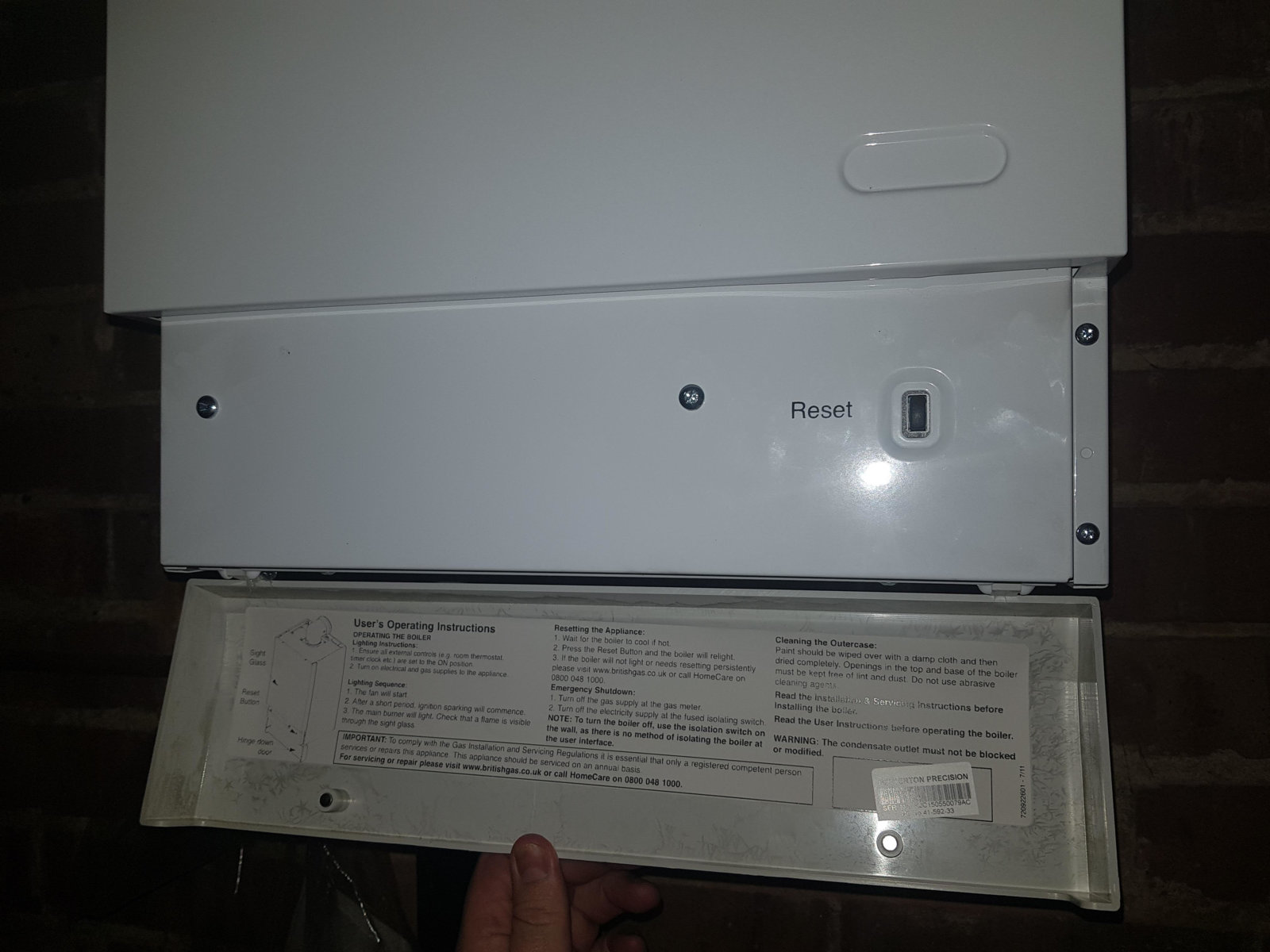

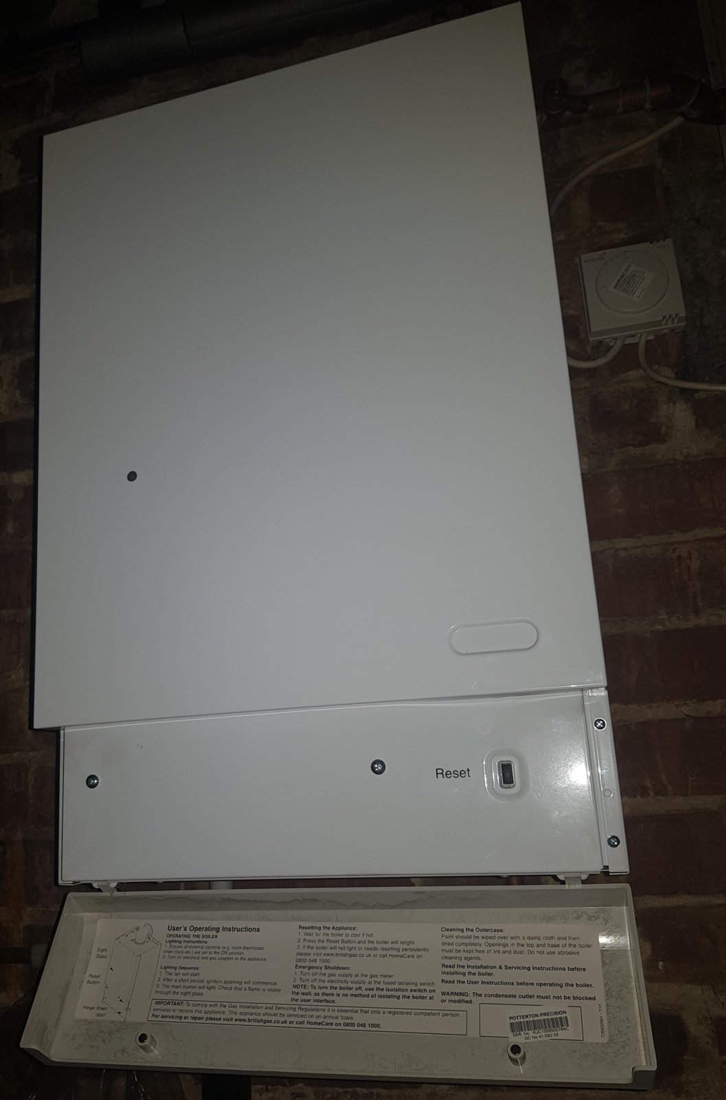

I cant see any fault lights on the unit. There is literally a viewing hole and a reset button on the boiler. That is it!
The problem is i am getting it in the ear about having to reset it each morning. I would happily hang it out until it gets replaced but this may not be possible if i want to stay alive.
Lower the grey flap that has Potterton Precision written on it and post a pic what is on the facia behind that
The pipe stat is in series with frost stat and turns off the boiler once the return water temperature is say 30 degrees.
Turn off the power and remove the boiler OUTER cover only....there's a couple of screws on the front AFAIR.
You will see the diagnostic lights on the plastic module on the lower right hand side.
Do not touch any other covers.
my apologies as @Gasguru correctly advises you remove the two screws on the front of the plate with the reset button on and the fault lights are behind that , total shoite design I agree

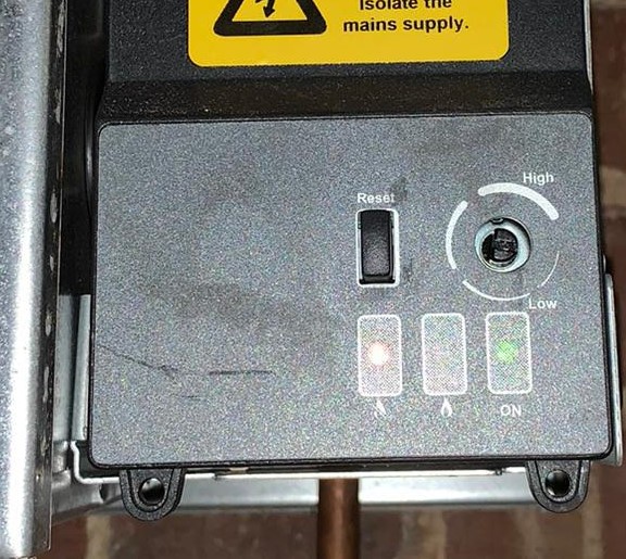

Uncovered the lights and this morning when we woke up to a cold house and no hot water the lights weer showing as below;
Left light (No flame) Flashing red
Middle light (Flame) no light
Right light (power) solid green
Why on earth are these lights hidden behind panel?
That sequence means that the overheat thermostat has operated, you will need an engineer, can be faulty thermistor, faulty O/H thermostat, faulty case seal or PCB faulty
