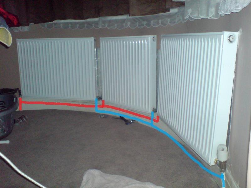

Was called to a v. similar set up recently. Two 1600mm long doubles, side by side, linked as yours are.
I'm afraid yours is even worse. Flow goes into the left rad, where it circulates inside rad, dispersing its heat to the rad, then flows out much cooler into middle rad, where it transfers what little heat is left to that rad. By the time it leaves the middle rad, and enters the right-hand rad, the water flow is virtually cold.
Presumably, its floor boards underneath, as the only way these rads will ever work, is if they have their own seperate flow and return pipes. Has to be re-piped.

Just because it has one pipe linking 3 rads doesnt mean its a one pipe system. You can still balance a one pipe system but you cant balance these. The 1st rad will always be the hottest and the last will always be the coldest because radiators are designed to remove the heat that they contain. By the time the water gets to the last rad, the heat will be lost.

When you drain down to fix the rad properly I would check the tails in the others for a blockage, at the same time change the trv to the flow pipe.
There's no reason it shouldn't work as is, other than a restricted flow.
I agree with DIA and look @ it not as a 1 pipe - but as a large sectional rad BUT with small - 1/2 inch connections between sections :idea: The old sectional cast rads had @ least 1inch bsp holes between sections . It`s a case of getting the volume of water to it ( meaning the 3 joined rads) to maintain the water temperature within .
If you consider that the total output of the 3 rads are probably in excess of 13000 btu.
You will NEVER get it to work properly in that configuration.

Posted: Thu Dec 16, 2010 10:00 pm Post Subject: Old Curved Single Bay Rads replaced with 3 double Not Workin
Hi,
I recently had a single curved really old bay radiator changed, as it was not heating the room enough. I spoke to a few plumbers and was told I could replace it with 3 new double smaller straight ones. I used a well known website to find the plumber.
In the end I got 2 X 800x600 and 1 X 600x600 fitted together with on thermostat.

Don't want to doubt you, but can't agree with anything you say.
1) One pipes work by thermo-syphon from having a valve at each end of the rad. How can thermo-syphon possibly be efficient if the rad is split into 3 seperate rads?
2) One pipe relies on the rad having short tails. Who knows how long the tails extend under the floor to the main F and R pipes?
3) You have recommended that he keeps this ba$tardised one-pipe abomination, but have neglected to point out that one-pipe really needs larger bore valves. Thermo-syphon will be killed through the narrow ways of a standard TRV. Needs one-pipe valves eg. Danfoss RA-G.
So, a rad split into 3, wrong valves, and poss. long tails. How do you propose that this is ever going to work as one-pipe? This whole mess needs a few simple additions of an extra pipe to each rad to make 2 pipe. Otherwise it will always be grief.
OP, Yellowbelly's suggestion, while not the neatest or easiest, will do the job if you don't want to lift the flooring.
