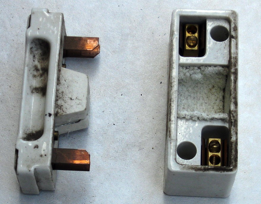

Evening all...
What's your views on changing a fuse wire in an old asbestos lined fuse?
I had to change one today, I wore a mask etc..I didn't like it, but what choice did I have...
What would you lot do?
Ideally the fusebox should be relaced, or at least if possible the asbestos fuseholders changed, but that will require an asbestos certified removal company.
Be careful buddy, it aint nice stuff.
It was an isolator L3 down I replaced the wire, then wished I hadn't, it was feeding a small office and they couldn't shut the shutters.....bloody job, wish I'd listened in school lol.

P3 mask I hope.
We won't / not allowed to pull the ceramic pot fuses anymore. leave them intact and we replace the cutout or isolator as a whole. Only takes a few particles to get into your lungs to cause you problems. The job aint worth the risk.

When you see it now, it's hard to believe a small piece of cloth like that has the potential to cause so much illness :cautious:
