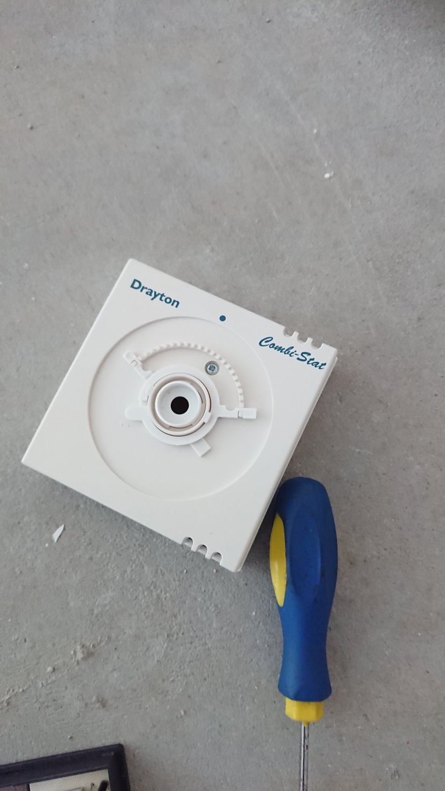

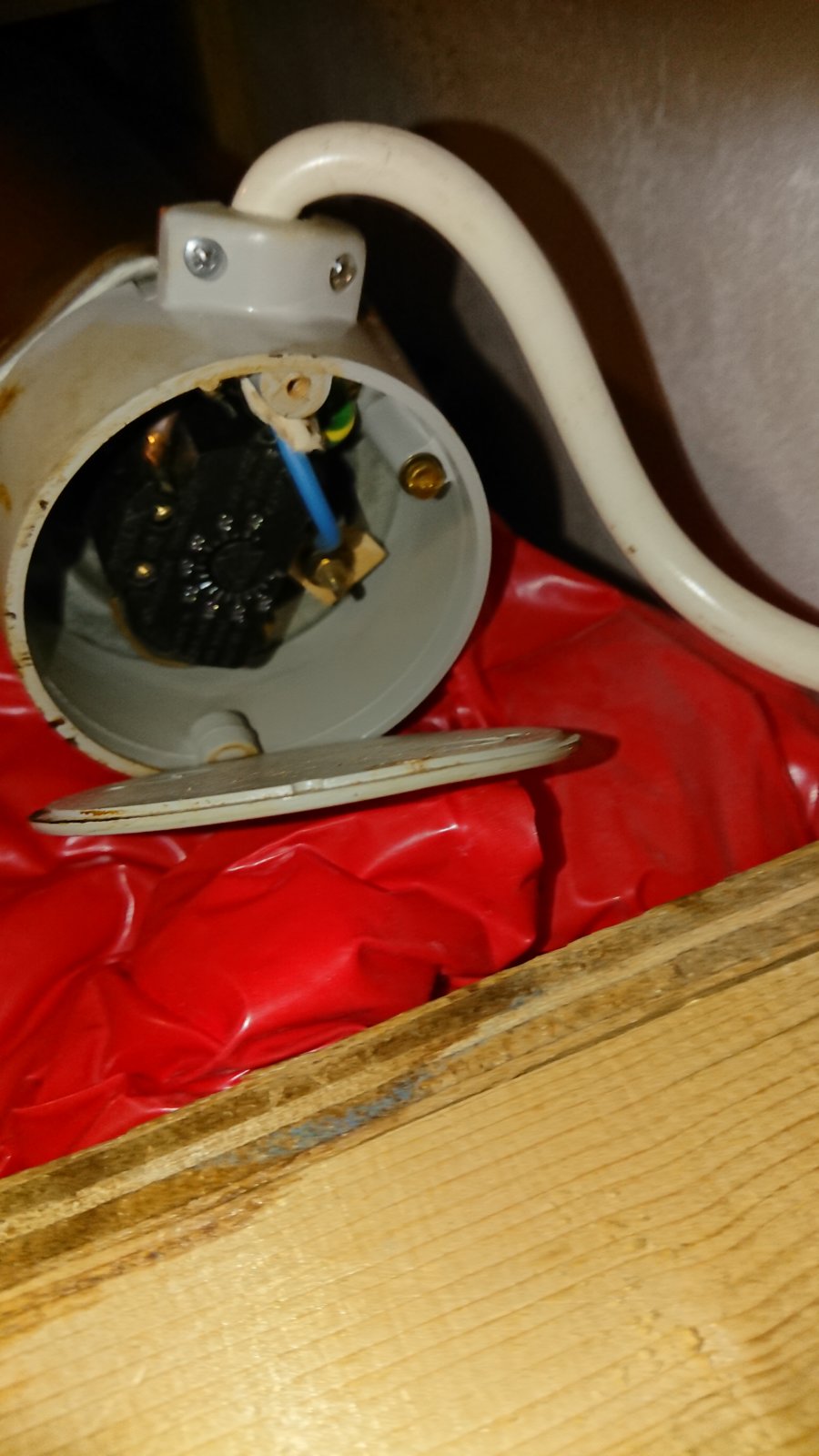

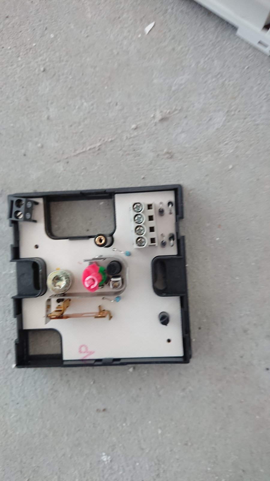

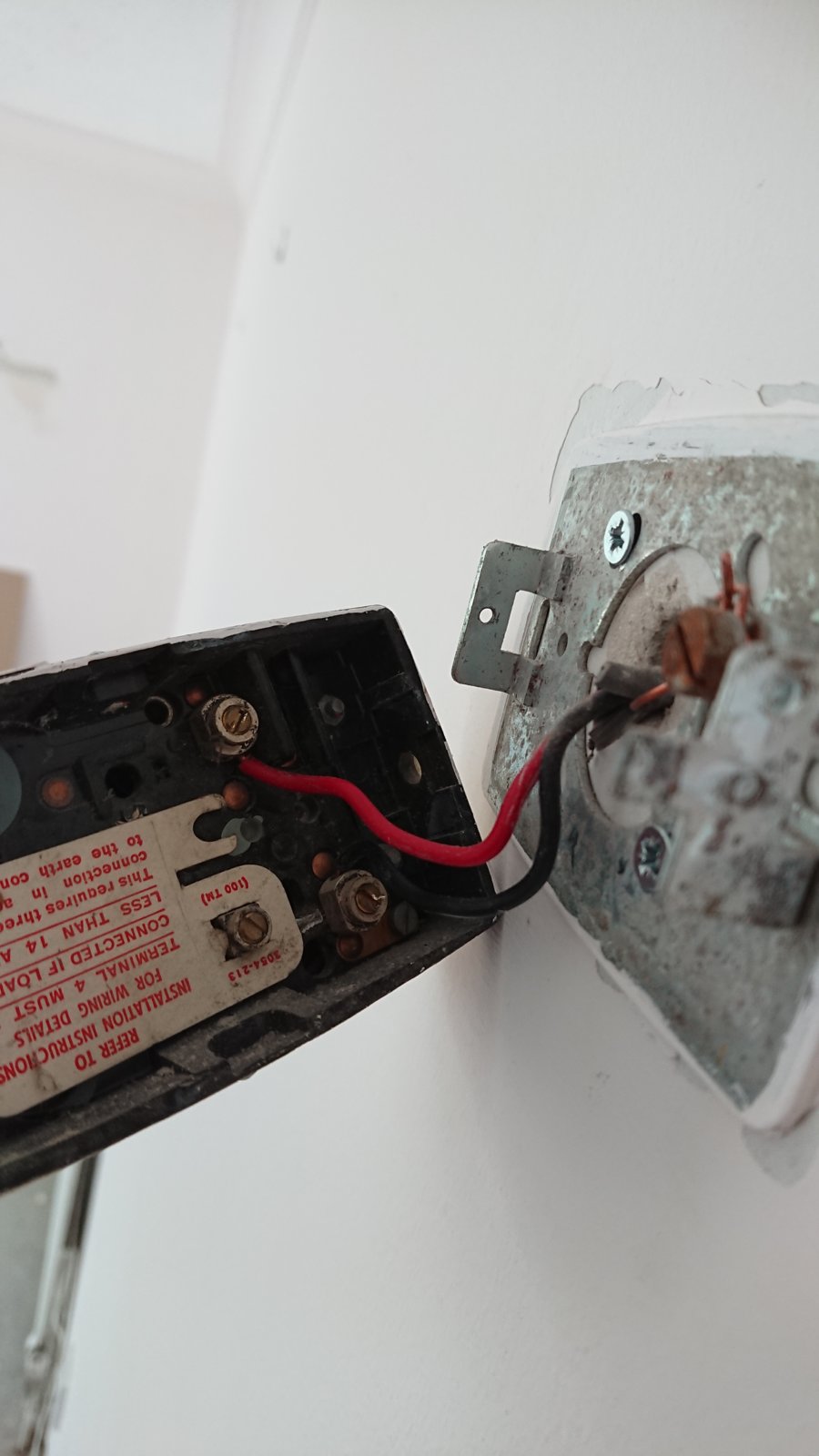

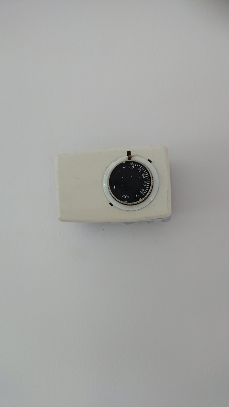

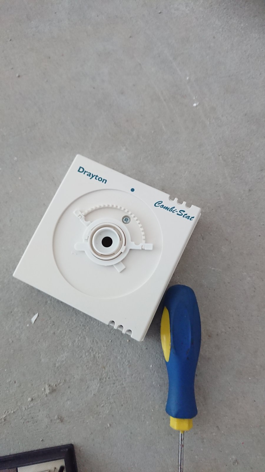

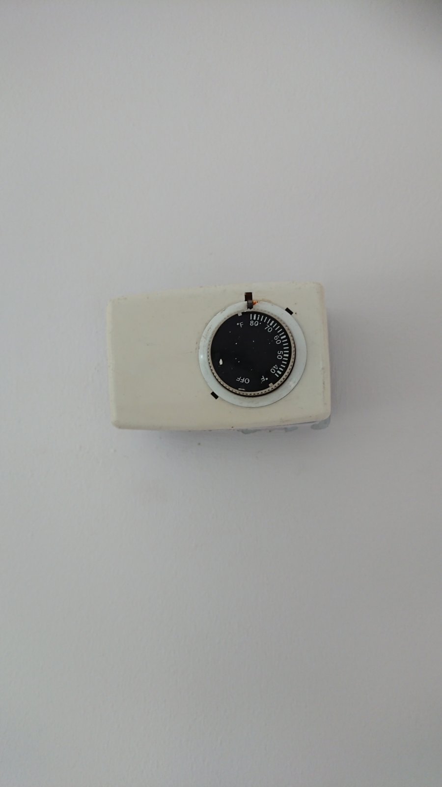

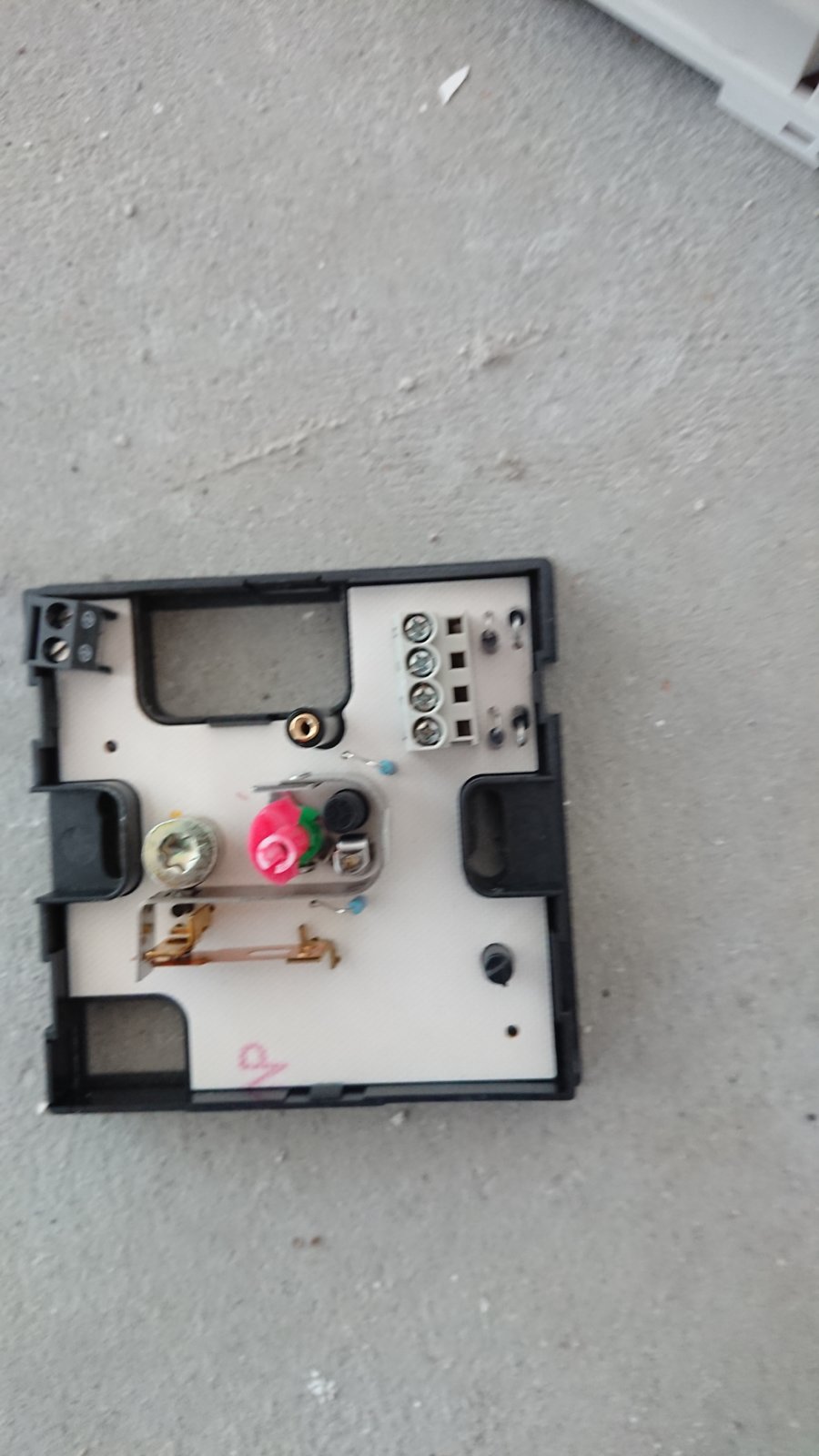

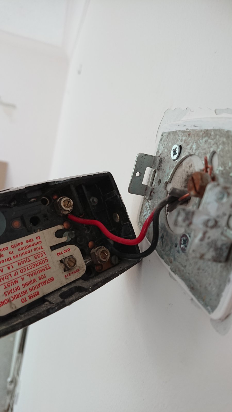

I am trying to replace the room thermostat please see pictures of old one and new one. I thought it was a direct swap but when I put live to live and neutral to neutral then earth the new one heating will not come on. I have to have to old one set to max for heating to come on so I thought old thermostat was buggered!!

From what I can see in your photo, the original thermostat is not wired up correctly. There is a wire missing. Apart from the earth...
There should be a Live (this is probably the existing red wire)
There should be a Switched Live (this is probably the existing black wire)
There should also be a Neutral (can't see one)

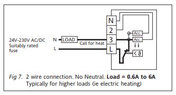

If the Neutral is missing the RTS8 can be wired as shown below using the 'L' and Terminal '3' But it won't be as accurate as it could be, because the neutral is required to operate the accelerator (Acc in the drawing)
So I would either wire it correctly using a neutral, or swap the thermostat for a battery powered one that doesn't need the neutral.
It is.
All wired and working thermostat cuts out when temperature is reach brilliant.

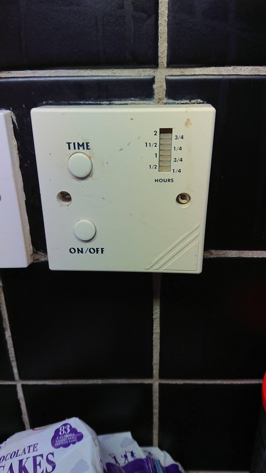

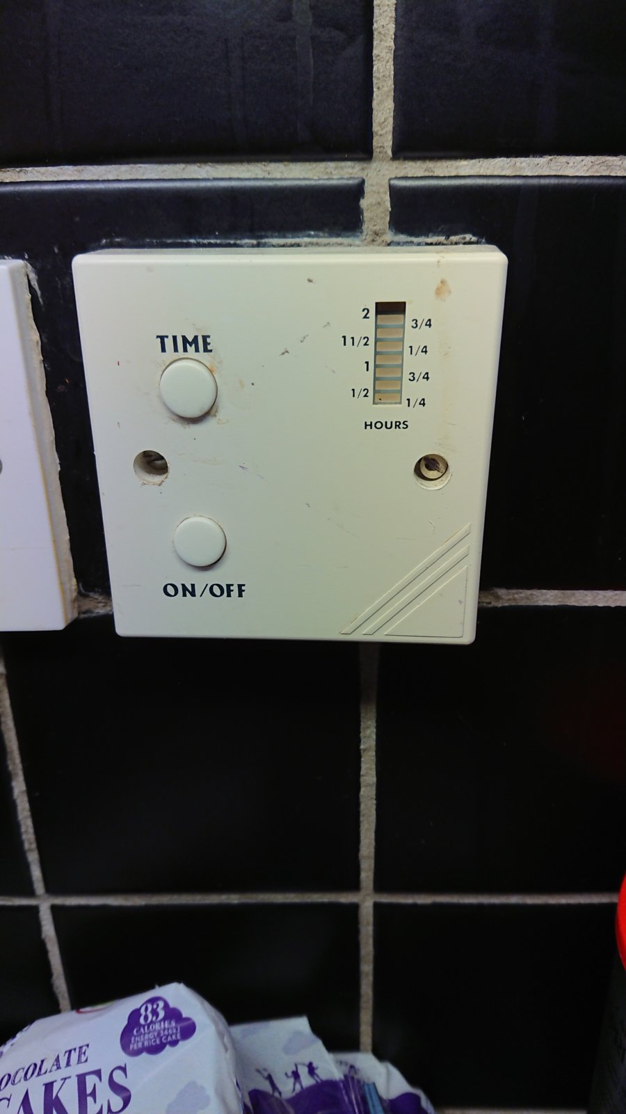

Another thing I have a immersion heater switch see picture. I want to replace it with this
https://www.screwfix.com/p/greenbro...0v/7643g#product_additional_details_container
Would this be feasible? Just want the ability to set heater to come on in morning to heat water, also don't think I have thermostat at hot water cylinder could this be installed?
The immersion will have a thermostat otherwise the water would boil and be very dangerous. It's under the immersion heater cap.
You can add a timer such as the one you have provided a link to. But if you need any help with that, I suggest that you start a new thread in the electrical section, I'm not going to be around the forum much (if at all) for the rest of the month.

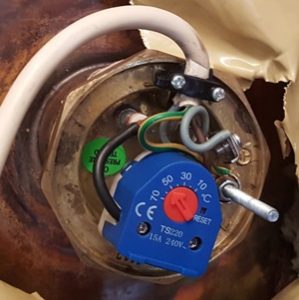

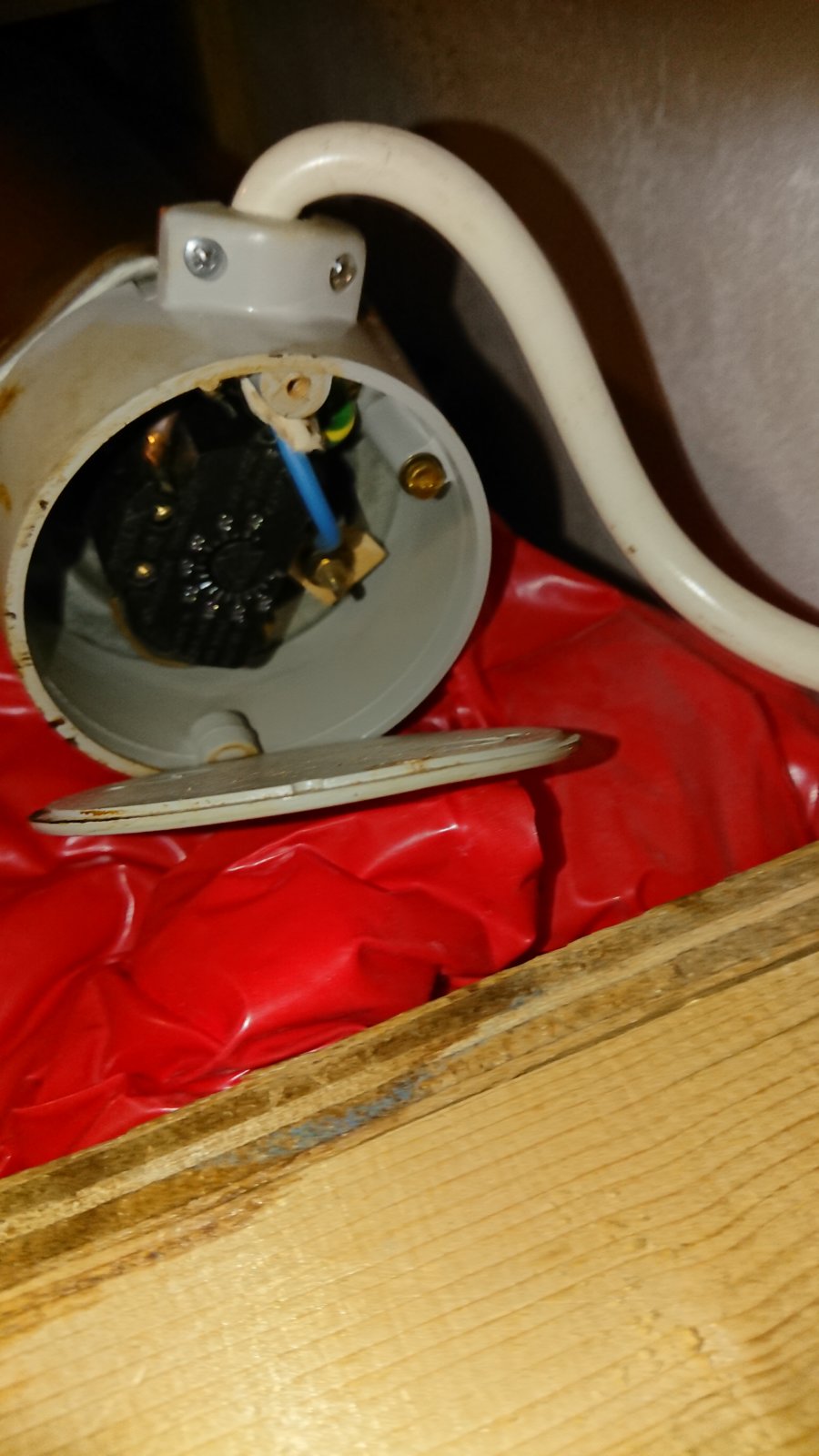

I take it this is the thermostat?? Should his be set so high or is this normal?
Yes that's it.
The setting is really your personal preference. But generally those that use off peak tariffs (eg economy 7) to heat the water tend to set it high to store as much hot water as possible during the off peak time, the hotter it is, the less quickly you will empty the cylinder because you will be mixing it with cold water.
