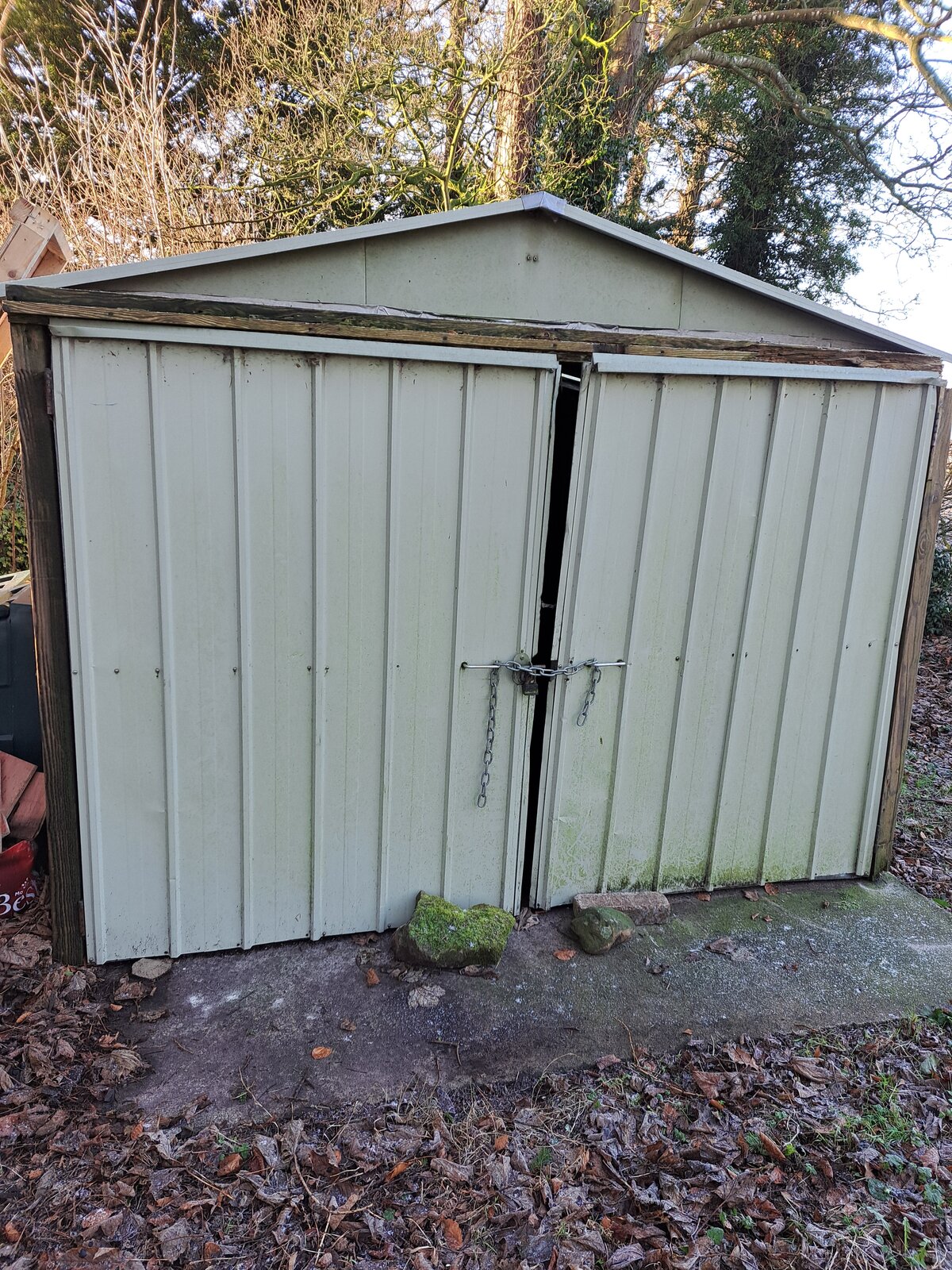

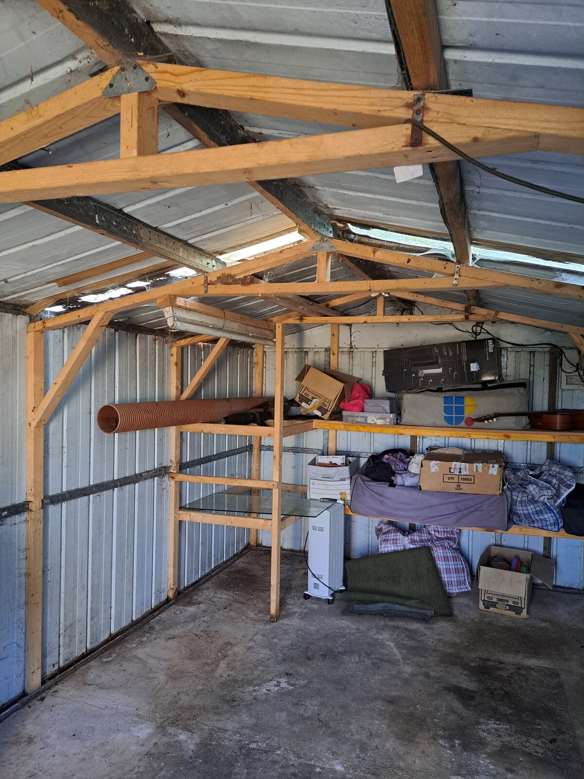

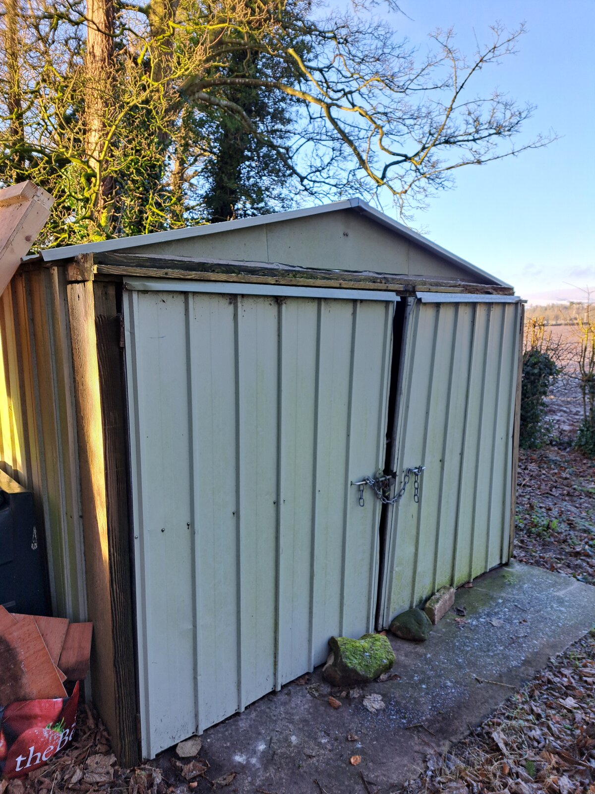

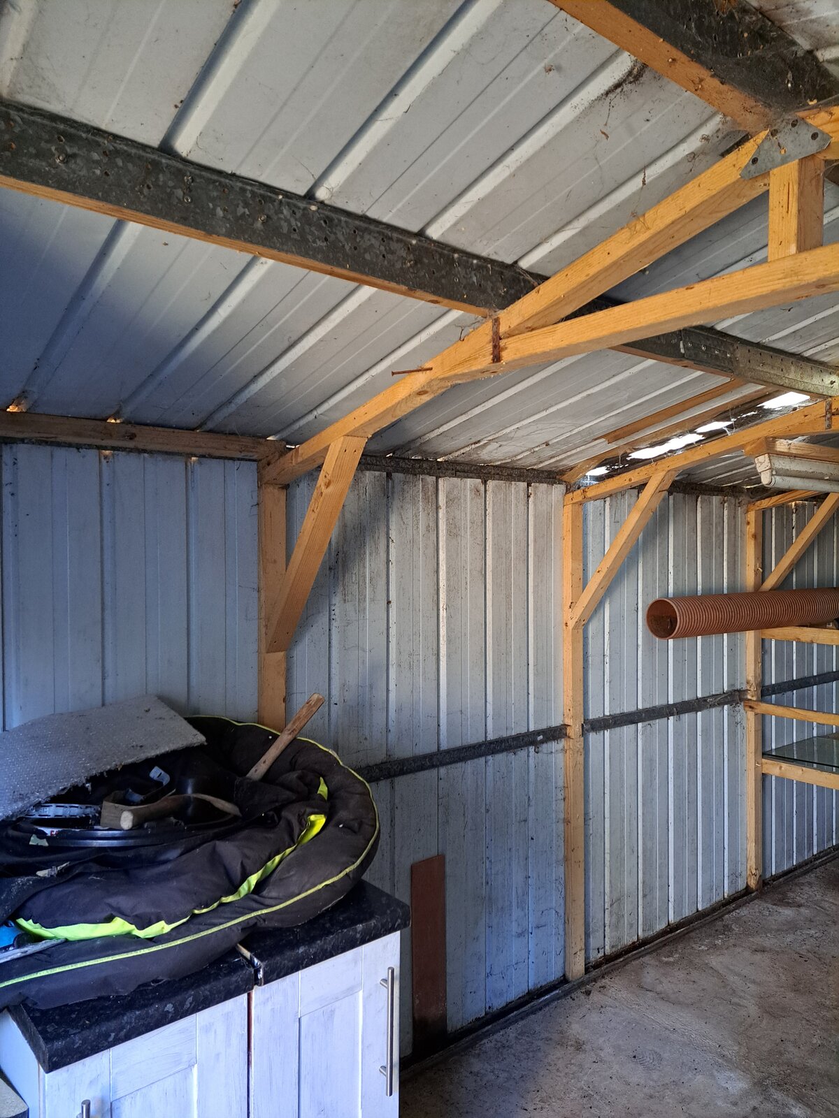

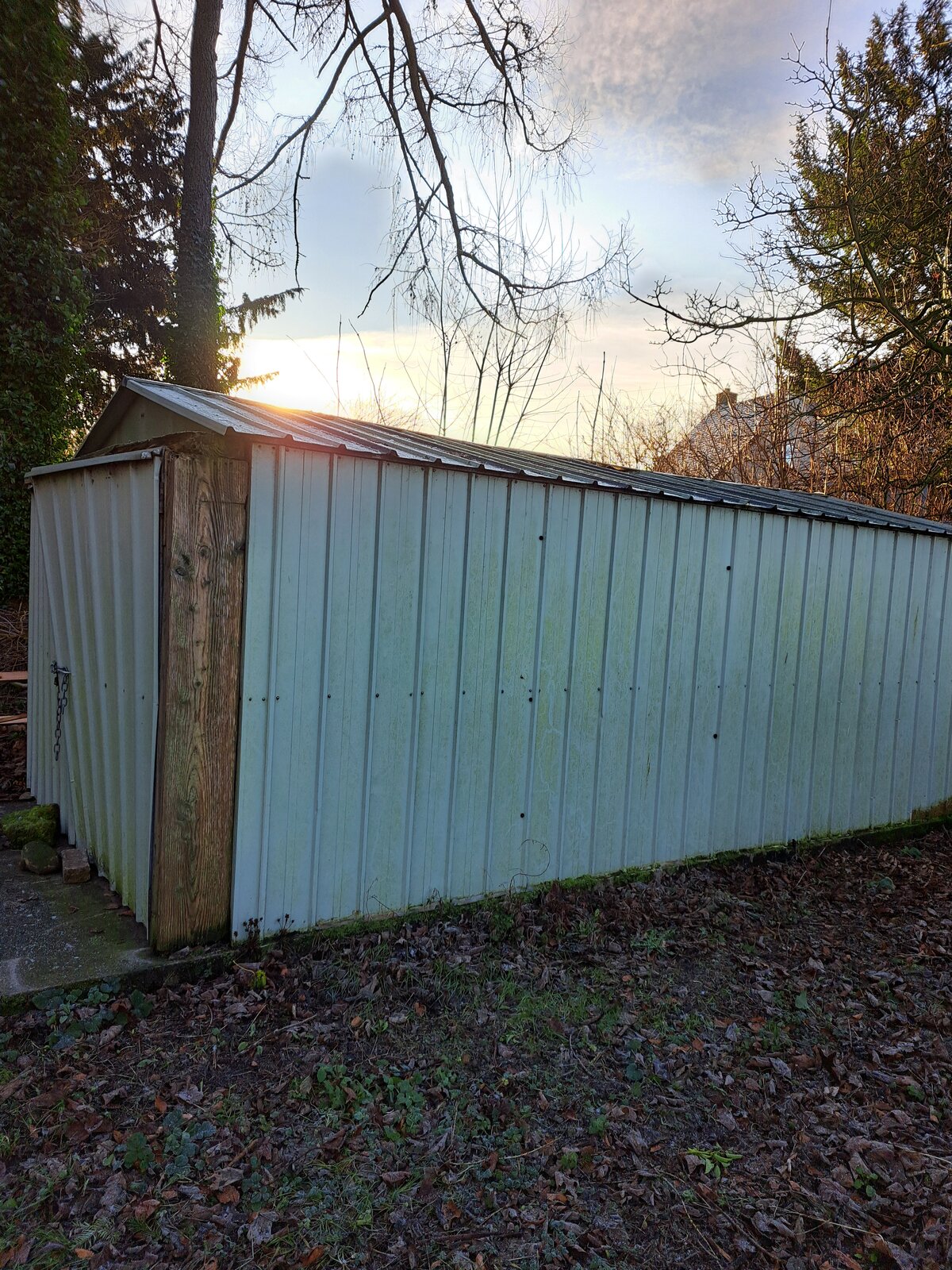

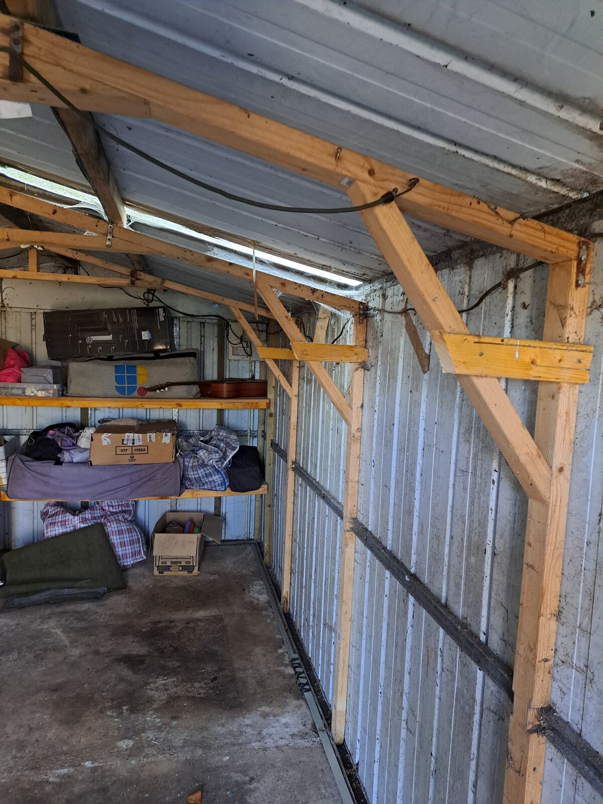

Hi I want to have a office man cave studio type chill room for all stuff...got an old metal garage quite solid apart from doors, is it worth using this frame as a starter to shape build something around or keep as is paint and insulate with new PVC doors, or should I chuck it away and buy something like a Dunster house build type, concrete base is good to go from garage build, so just want to check what you guys would do.

That's a pretty low end structure right there. It depends how much 'turd-polishing' money you are prepared to squander or put towards a nice new shed?
Its solid enough, guess I could repaint and maybe clad it on outside then add insulation inside and on concrete floor then finish, could use breather membrane wrap outside first then clad maybe? roof needs some attention but as a shell may build on it as is...take doors off and close that end off then put doors on side looking over the fields...sound like a plan?
I think there would always be condensation problems.....I'd go for a timber type design.
Seal the concrete floor too!
John :)
Thanks chaps that makes sense now, will rip the old garage down keep the timber frame and add to, seal the concrete floor, any guidance on what sealer to use before I add insulation on top.
