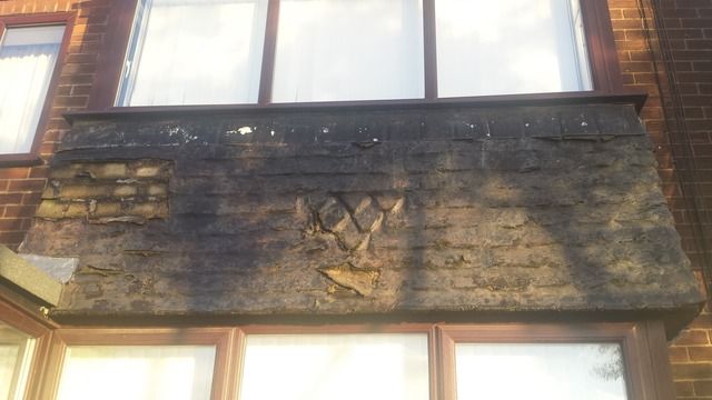

I have noticed quite abit of damp/mould coming into the main bedroom which is behind these tiles, one bit of the wall can get literally wet as if the tiles are letting water straight in somewhere.
Here are the tiles in question:
They were like this when we moved in, now winters here they seem to be causing trouble and also they look complete mess.
Heres what i'd like to do, pull all them tiles off, fit some thick insulation behind there as It sounds like a wooden stud wall and is always very cold! Then put some brown UPVC cladding on there to match the windows and hopefully make it all water tight again.
Is this a good idea? What will I find if I remove them anyone know? I'm hoping its just going to be some sort of wooden frame work I can work with.
Any help appreciated :)
Replacing with UPVC sounds a good bet, looks like it has been a long term problem. It's been bodged up with a bitumen paint or similar.
Hung tiles are usually on battens but they may be rotted to bits with that long term damp.
You need to get guttering above the window too I bet that is the real cause of the trouble.

My guess is water running off the flat roof down the front is causing trouble, some gutter around the bay would help.
1. there's no sign of a RWP from the bay roof.
2. water from the flat bay roof could be cascading down the face of the bay? The bay roof is probably sheet lead.
3. when were the main roof gutters last cleaned out? The main roof soffit's & fascia look weary.
4. You will need to work off a tied-in tower, and off the porch roof.

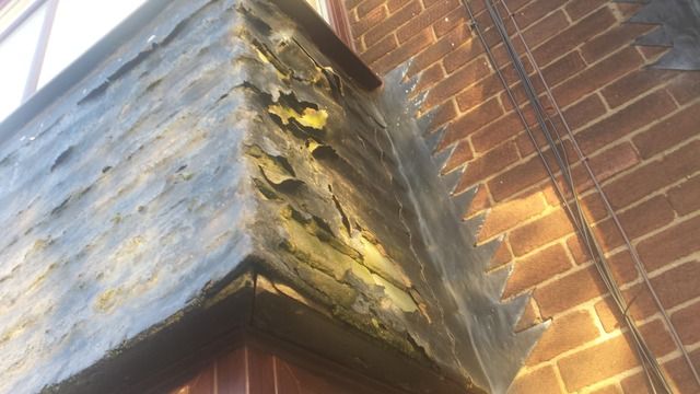

5. Can you pic how the porch roof ties-into the bay, & how the porch wall meets the bay? Any refurbishing will run into detailing difficulties here.
6. Is the idea to do repair work or replace the bay?

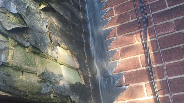

7. If you lift & bend the lead flashing out of the way, you could begin to strip the tile hanging from the top down.
8. when the bare studwork is exposed then you will have a better idea of how to proceed.
9. pics of the damp and mould in the bedroom would help. Have you carefully examined the ceiling and walls on the ground floor?
10. is the building to the right part of your house?
11. a pic of the whole front elevation would also help.
Yes I will get you some more pics tommorow

To answer your initial question, yes there will almost certainly be a wooden frame behind the tiles.
To be honest the whole thing is shot, you might as well rip it all off, that way you will see the extent of the damage, and can replace any rotten wood and insulate whilst your at it, your flashing looks ok apart from some minor re-pointing so as was said you should be able to just ben that back, but the top flashing under the window looks a bit gash and may well need replacing. Then it's just case of deciding how you want to refinish the outside again.
