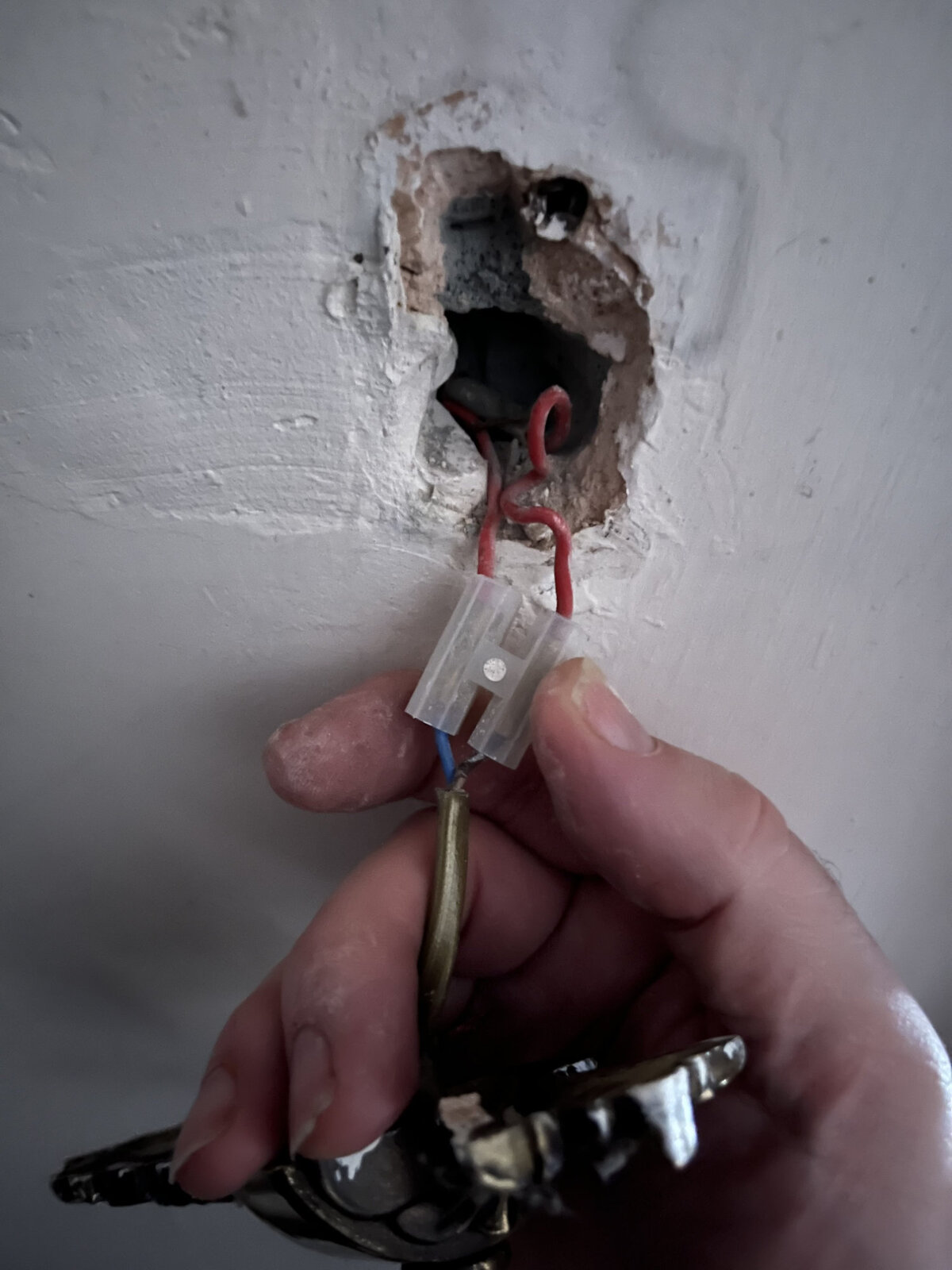

I've just moved into a very old house and need to replace a wall light fitting. I've done this before and am comfortable doing so (although I wouldn't attempt to fit any new light circuits). The existing light is wired to 2 switches.
After turning off the power, I removed the light from the wall to see what the wiring looked like.
As expected there are 2 cables, each running to a switch. Both cables are 2 core. Each with a red wire which were connected to the terminals for the lamp. The other wires were bare copper and wrapped up "neatly" out of the way (can't see them in the photo).
I've no idea why they would have been stripped and I can't see any insulation on them at all which made me think perhaps they were earths. But I'm unsure that 2 core cables with live and earth is a thing so I guess they are Neutrals, right? In which case, surely they shouldn't have been stripped and wrapped up out of the way.
Now the new light fitting, despite not being metal, has an earth terminal. If those bare wires are earth then I guess they should be wired in there with the 2 live wires being connected to the Live and Neutral connectors on the lamp. But I'm really not sure
How should I deal with this?
Likely, but not definitely, the bare wires will be earth wires, but you need to find a way to be certain of that, before connecting them to the earth terminal of the light, plus ensure the earth wires are actually earthed.

No metal box. The wires come down behind a metal shield which is behind the plaster to the left.

“Single plus earth” is a thing:
The earths should have been joined together in a terminal of some sort, not just twisted.
Yes.
Don’t loose track of which red wire is actually neutral. Put some blue sleeving, or tape, on it.
Yep I think replacing that terminal block with a Wago connector would be a good idea
