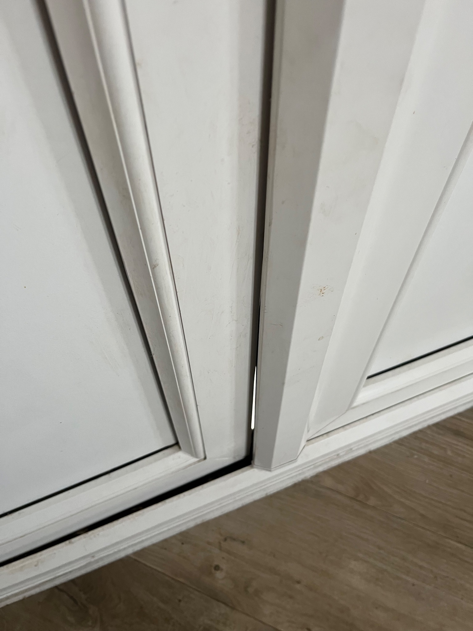

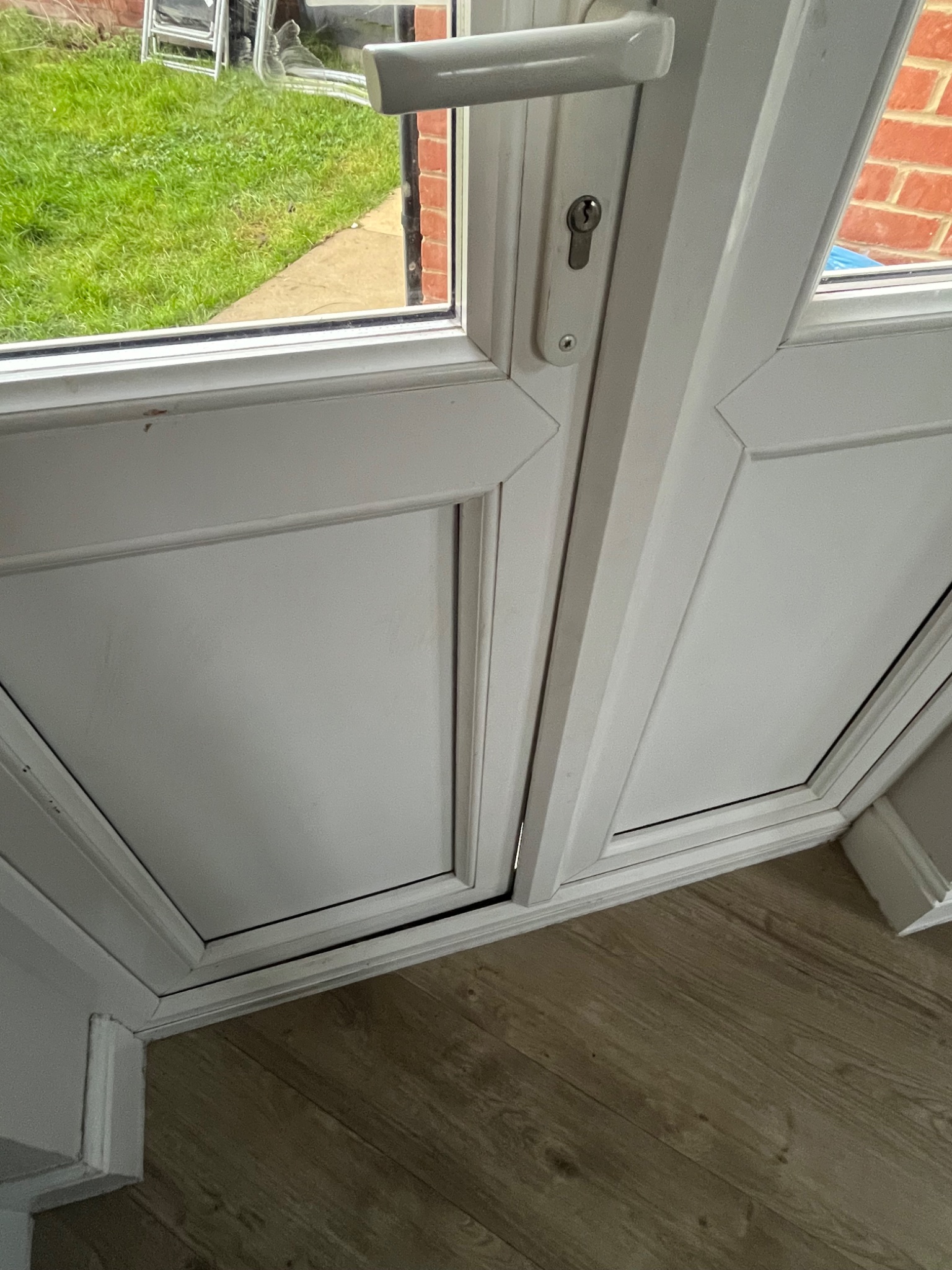

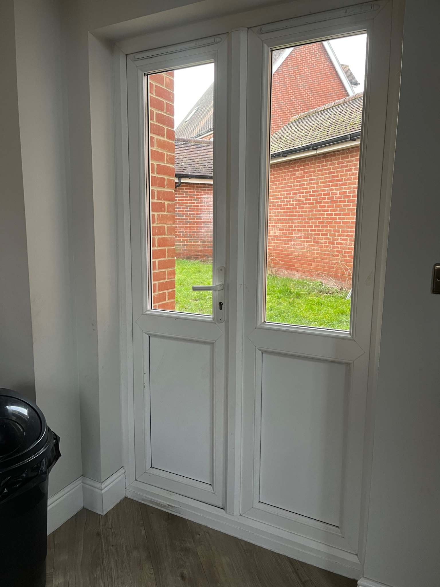

Hi all,
Wondering if any suggestions on this one before I need to contact a locksmith
Moved into a new property on Friday and one issue found is the doors going into the garden.
The bottom right corner of the left door appears to have been closed and locked while out of alignment.
We can’t open the doors with a key at all, key won’t turn and doors have no movement in them either.
Currently out of ideas other than having the lock drilled

Are you sure it's even the correct key then?
Changing locks is probably a good idea anyway after buying a house, you don't know who still has keys and it's not beyond the realms of possibility that you've purposely been left with a different key.
The gap at the bottom should be easily rectifiable by adjusting the hinges, it's an old Anglian door and I'm not sure on the type of hinge they used from memory
Instead of a locksmith you might want to try a window/door doctor type outfit as from experience I found locksmiths aren't well versed enough to adjust and align pvc doors

I did think a window/door person might be better but then wasn’t sure if the lock would need drilling out as you can’t get to the hinges
I’ll probably send the pictures to a few local companies who do both and see if they are confident they can resolve
Now resolved for £80
Definitely no key for the lock so,
Was a case of removing the handle
Using grips on both sides on the barrel (one outside and one inside) to wiggle it back and forth until it snapped
Opened door and changed barrel
Then the door had dropped so just a case of using the Allen key hinge fittings to raise the door
