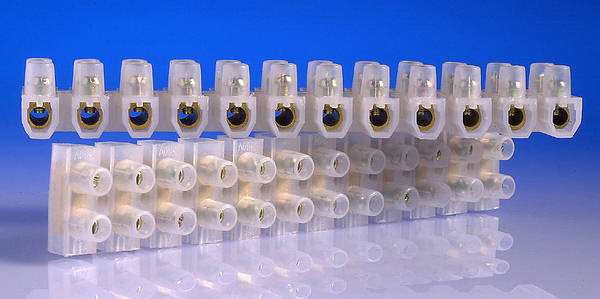

henryb1 said:
sorry i dont understand what you mean and ive looked at for reference and am confused by that also.
Are you saying that all the wires (9 in total) wont be used for my new fitting and i need to "blank" the redundant wires off?
Who's saying you need to blank the redundant wires??
jenki said:
You should end up with:
A block for the Loop (usually 3 red wires)
A block for the Neutrals (usually 2 black wires + 1 blue for the flex to the light)
A block for the switched live (1 red or (black wire with red sleeving) + 1 brown flex to the light)
A block for the earth. - If it is a metal fitting ensure an earth is connected
3 + 2 + 1 = 6 + (3 for the earth) = 9
When you took off the rose there will have been 3 reds connected in the centre, this is the loop, and need to remain connected together.
then there was one Black wire connected to the blue wire leading to the bulb, this wire needs connecting to your fitting 'N'
the last wire either a red wire (or black wire with red sleeve), which was connected to a brown wire leading to the bulb, needs to be connected to your fitting 'L'
finally all the earths (with green / yellow sleeves) need connecting to your fitting 'E', if the 3 grey wires are not long enough to reach your fitting then you can use choc blocks to extend the Neutral (black), and switched live.
Likewise if you cannot get the earth wires to the fitting then use a choc block and an additional wire.
Ensure all earths have green / yellow sleeving, and the Switch wire has red sleeving or red tape on it.
