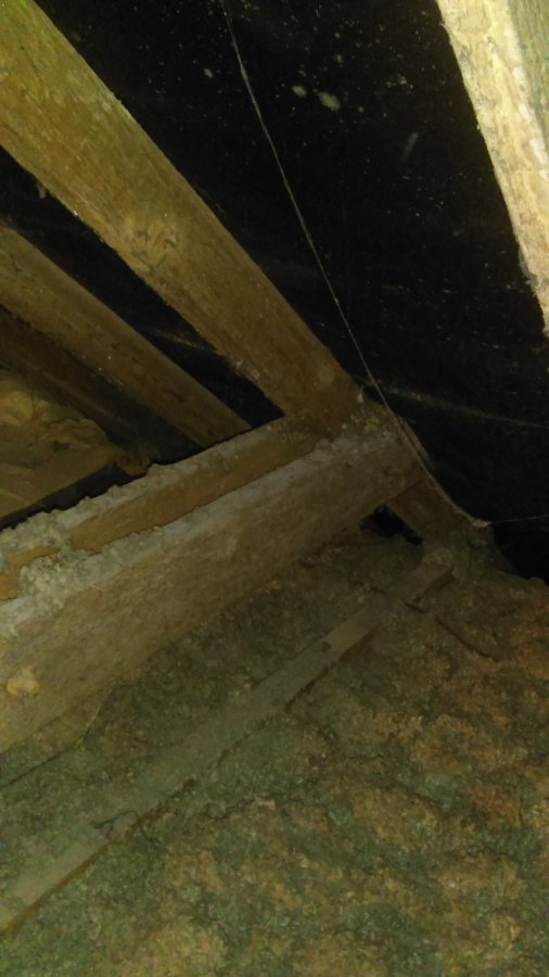

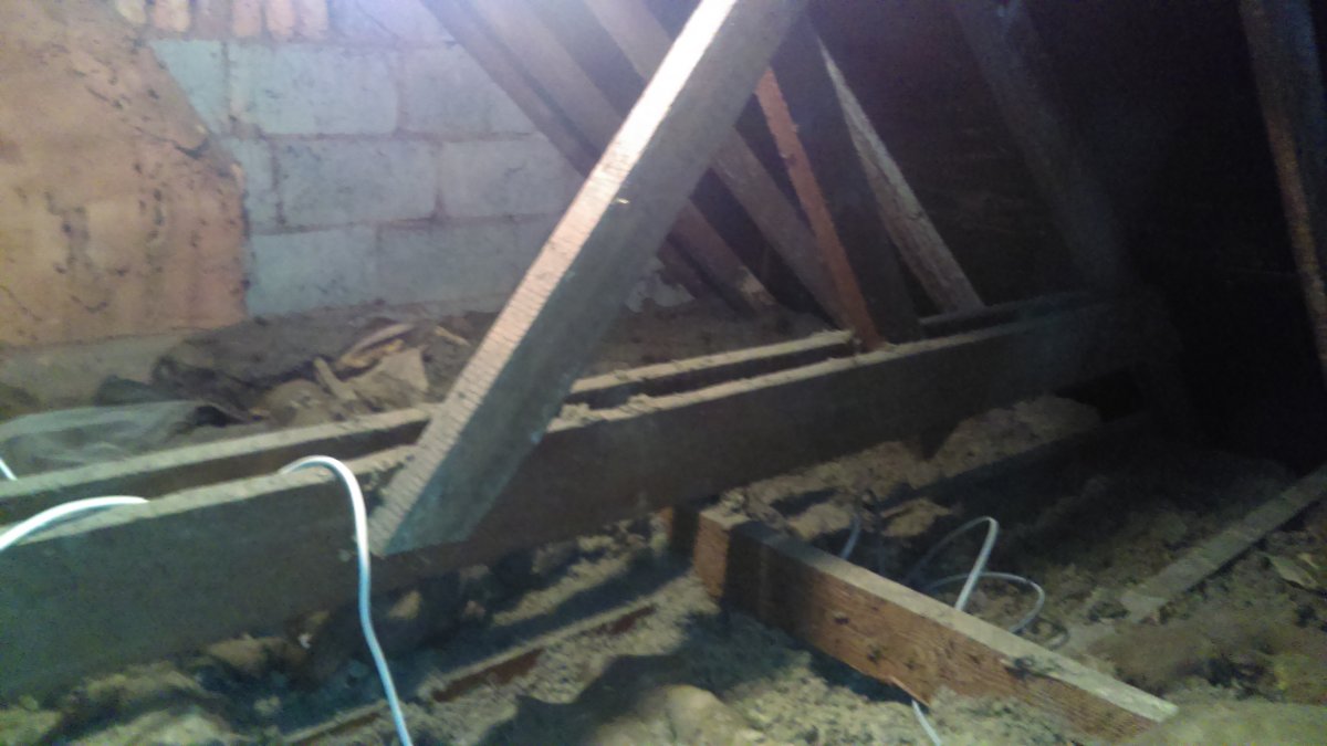

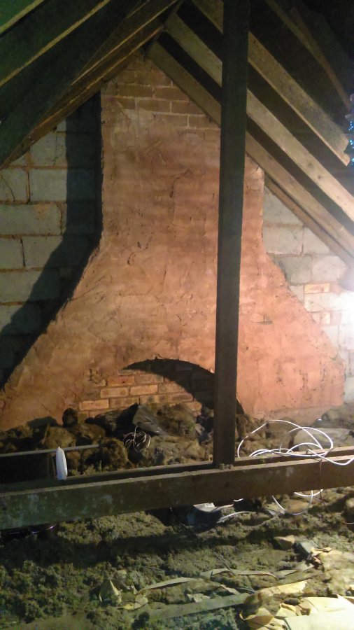

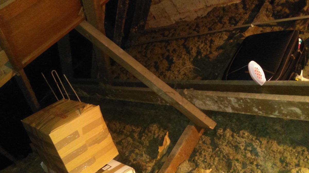

Hi all I'm new to this but I'm looking at removing the timbers from my loft for easy access storage it's an old traditional loft as far as I've red,I'm not to bad with wood work ect so just want some advice, can all of these timbers be removed and if so do need to support anything and how to do it will post pics in a bit when I work out how to.
Thanks for any help in advance
There are 2 of these 1 either end of the loft non of these timbers are rest on floor joists or walls just bolted to the rafters and 1 to the purling please help
No they can't. They were not put in as ornaments, but to prevent your house from falling down.
If it's just for storage, reconstructing will not be economically viable.
If you secretly want a habitable loft conversion, it will have to be done properly.
