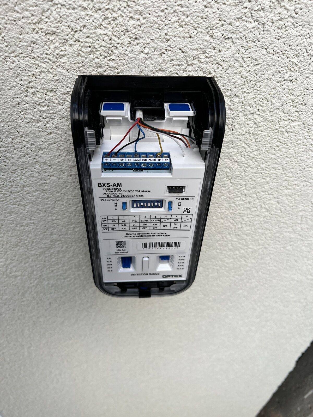

Optex BXS-AM wiring help

You have a left hand alarm output, a right hand alarm output and a tamper output.
You can wire each output to individual zone if required.
How have you got this pir configured, post photo of your wiring of pir and at the panel end.
Check your mounting height?
It's been know for people to install external detectors without checking the correct height.

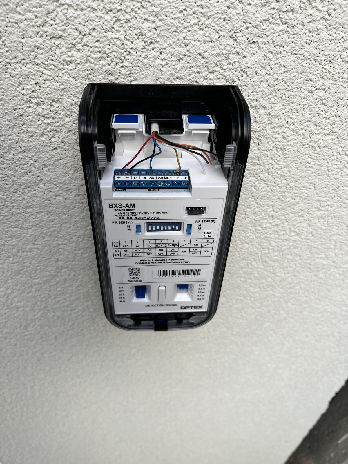

This is a picture of the garden PIR wiring. I don’t have a picture of the panel end but have the alarm wire going into an alarm terminal and tamper wire going into a tamper terminal in the same zone.
I have the zone programmed as guard but when the system is disarmed and I walk past the PIR I get a tamper alert. Have I used the wrong tamper terminal on the PIR?

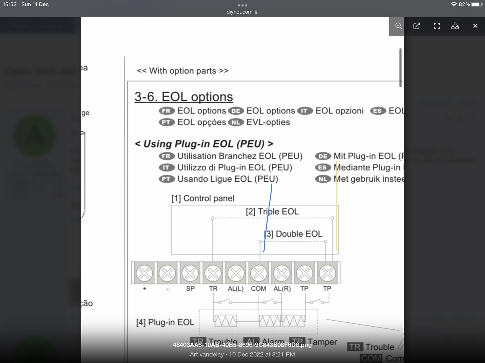

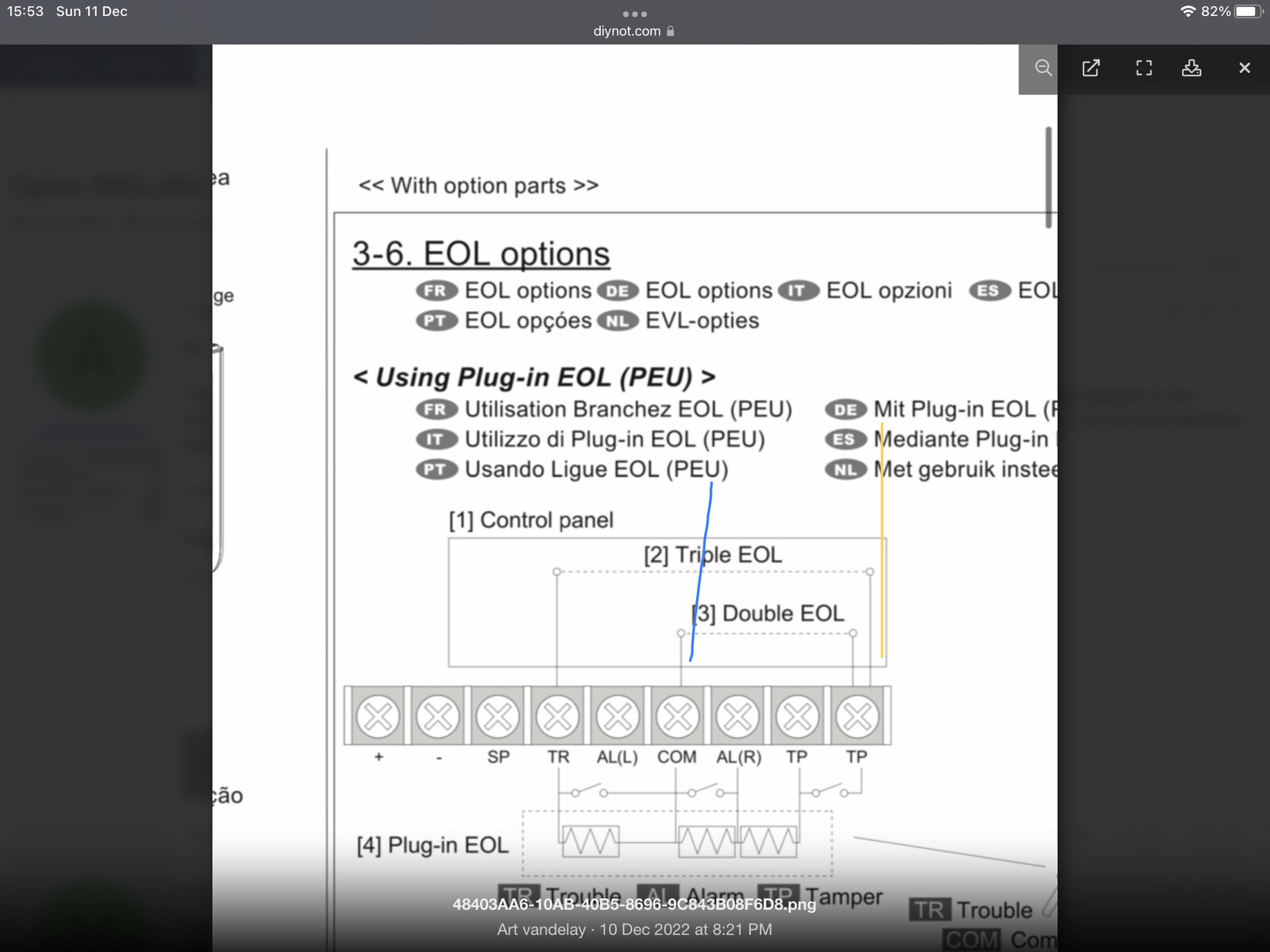

They both need moving over to the right by 1

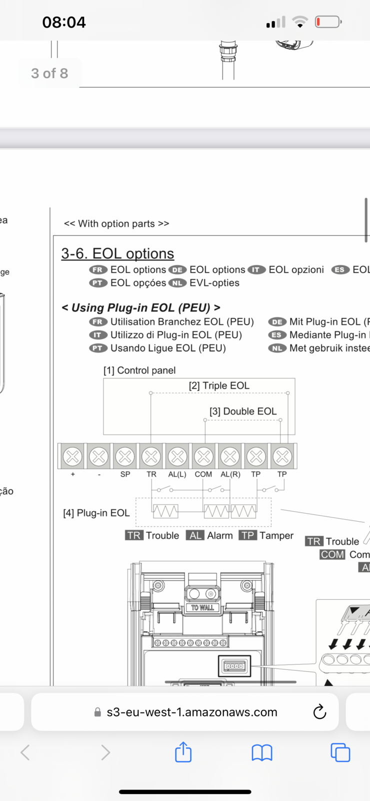

I think you would have to revert to normal 4 wire wiring and remove the resistor pack , then wire the other zone ( left ) to another zone ?
