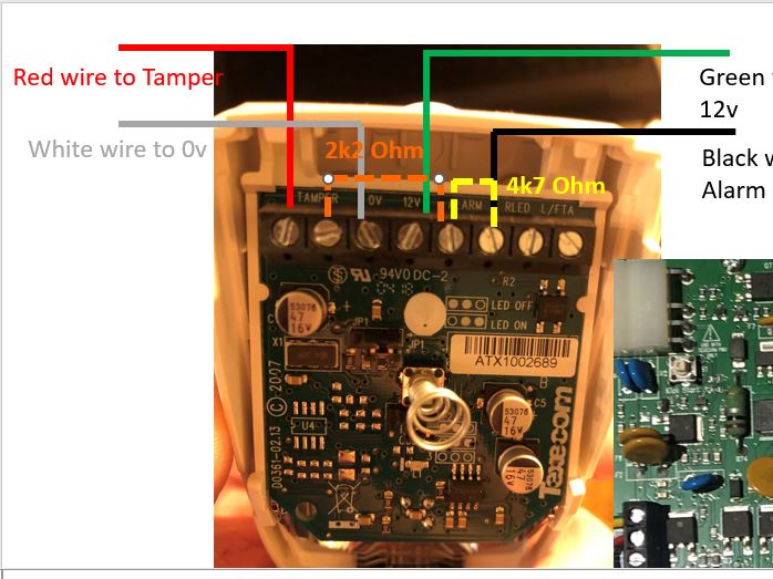

I have just wired a new PIR to my Texecom Premier Elite 24 panel. The PIR I am wiring is a 'Premier Elite MR'.
I copied the same wiring as my existing three PIRs but I am getting a Tamper error.
I have seen some references to resistance but there seems no method of adjusting this on the Premier Elite MR version and therefore I am a little confused what the problem is and how to fix it.
Please see the attached images.
Please could someone advise?
Your pir requires resistors.
2.2k and 4.7k ,that's why you have a tamper fault.

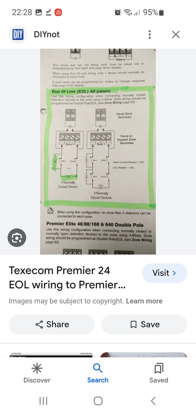

Thanks for this Jo,
I am sorry but I struggle to interpret the manual drawings. Is it saying I need to do this (see attachment)?
What I cannot understand is why I need these resistors when the previous model of PIR (same brand) didnt require any of these.
Thanks again.

Did your previous detector have selectable resistor values. Have you a pic of old sensor.
Having looked at it again, yes it did haev selectable resistor values (it was a Texecom Premier compact IR).
Is my previous image correct on how the resistors should be wired please?
