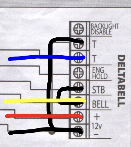

Could somebody please help. I have tried to help the old gentleman next door and its turned into a bit of a disaster.
He has an Optima G4 panel and an ancient alarm box. I have changed boxes before but when I took off the old bell box I was only met with four wires. Two to a siren and two to a strobe.
I spoke to Optima and this is what they advised but it doesn't work.

Your need to use two wires for the bells constant power (hold off + -) another for the bell trigger (in bell loop this wire into the strobe terminal so that strobe flashes upon bell activation, as you only have 4 cores you cannot have a seperate strobe wire) then the last wire will be for the tamper return.

Disconnect all wires in panel or tell me what wires are in what terminals at present.
Tell me what the terminals are marked as in panel & bell, take pics if needs be and i'll tell you how to wire it up.

Wire bell like this
Wire like this and remove any other links other than in the diagrams. Let me know how you get on.
Also its advisable that you enable the battery in the siren too. Small jumper link.

Your have nothing coming out of strobe terminals in panel as you dont have enough wires so we are linking the strobe with the bell trigger in the siren itself. Only downside to this is that when the bell time expires the strobe will also stop whereas we would normally have the strobe carrying on so that you would know that there has been an activation.
