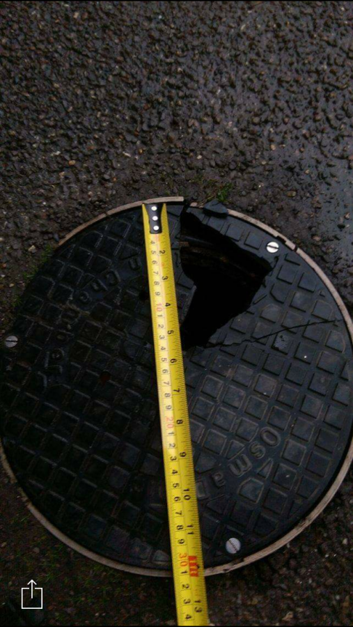

I wonder if anyone can help please. I need to replace this drain cover which is on a shared driveway, but I can't seem to locate a 310mm cover. Would a 320mm with frame be okay, it's very possible I've measured it wrong (photo attached)
I don't mind if it's osma drain brand or not so long as it does the job.
Many thanks!

You would get a like for like from Travis Perkins but it would probably break again.
You could fit a stronger rectangular lid and frame over your round chamber.
See
http://www.rjpryce.com/Products/osma-110mm-below-ground-drainage/WV4D328
Looks like the "frame" is bust as well. If so and especially if it is distorted a new frame and cover would be better but make sure it is suitable for traffic not just pedestrians.
If you know how it got broken then chose accordingly. e.g. If some lorry did it, it may well be OK for cars.
