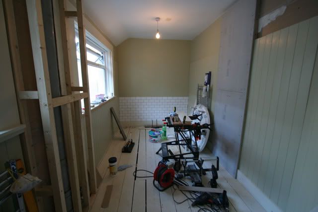

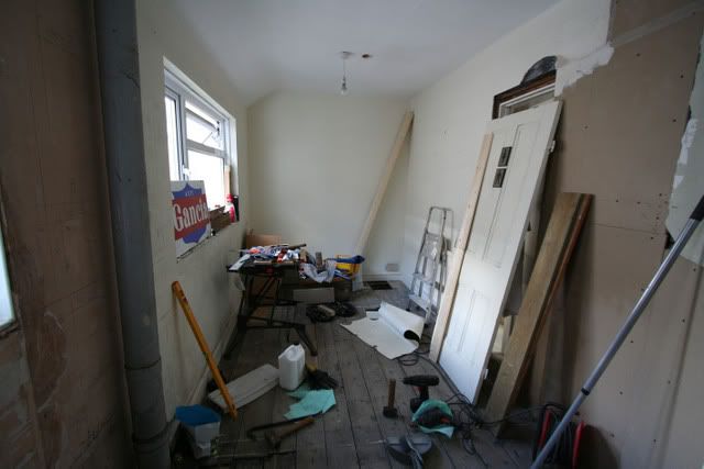

:eek: Almost 3 months on and we are finally nearing completion.
So I thought I'd share the last few months slog with you all and say thanks for the great advice you've all given (which I haven't always followed :oops: ).
I'll post up pics of the completed bathroom after Wednesday which is the plumbers last day ...then it's bath time!!!!! :LOL: hurray!!!
and these were taken yesterday...
Almost there :rolleyes:
In case anyone was wondering if I was a bit stinky after 3 months of not having a bath, it's ok we have a shower room downstairs ;)

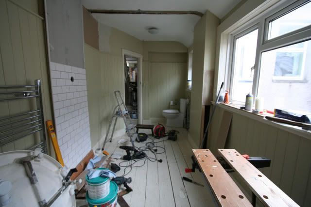

Yeah it did get a bit tiring towards the end. It was converting a cupboard off the bathroom into a walk-in shower that impacted our timescale the most.
After building the new stud walls and Aquapanelling the shower and plasterboarding the other areas, getting the waste in etc we stripped everything we could around the existing suite.
The actual changeover with the new suite only took a weekend!
We also had to put a new cistern in the loft to feed the shower pump as the existing one was too small and in the airing cupboard so the shower wouldn't gravity-flow.
Been in a few months now and still working A-OK (crosses fingers!!)

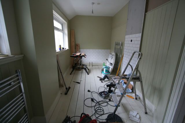

I think it looks great, Amanda. I particularly like the t & g boarding. Did you use single boards, or the mdf stuff?
Thanks Nick,
We used the single boards. Once the battens were up it was quite a therapeutic job. Just me and radio 4 and I was away :) and only hit my thumb once or twice.
Trying to get my OH motivated was the biggest job! We could only worked at the weekends and he would lose interest after a few hours :mad: but he redeemed himself with the tiling. He did a sterling job, really professional. (Ignore the bottom 3 rows of the bit where the shower is going to go cos these will be hidden behind the plinth and he couldn't be a*$ed staggering them!)

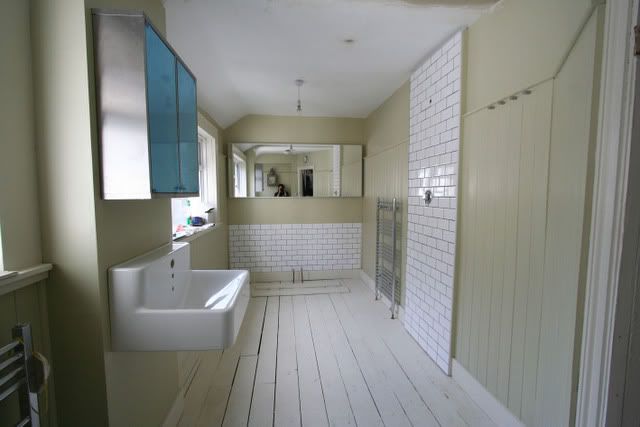

Well, I'm very impressed. Had you thought of writing to a magazine and asking if they'd like to buy an article on how you did it? I'm sure other people would appreciate your tips. For example, I see you have quite a large mirrored cabinet on a plasterboard wall (above the washbasin). I assume you screwed this into the wooden supports, etc, etc.
:LOL: Not to worry Nick, the sink and the cabinet are attached to 5x5cm timber studs and the front is 12mm ply not plasterboard (tho' the sides are).
Just waiting in now for our plumber to arrive. He's got an awful lot to do today including fitting up a D-shaped shower :eek: rather him than me...that thing scares me.
As to writing in to a magazine, I'm not sure how I want to reveal how I've done things :oops: as I am the Queen of botch!!!

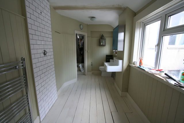

:( The D-shaped shower has flummaxed the plumber so not quite finished.
But we have a working bath and sink now hurrah :D
I need to phone the Sloegrin helpline tomorrow to see if they can offer a bit of advice.
Watch this space...
