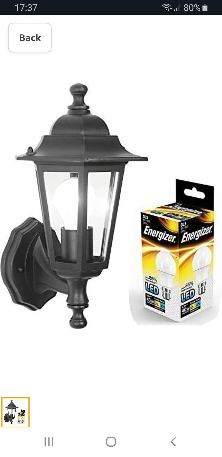

Do they still exist?
I had them in my previous house and now I would like one in the alleyway but I want to avoid passing too many cables.
The wall where it would go has got a socket on the other side, previously used for tumble dryer, so no problems powering it.
I just can't find them.
This is what I mean by lantern, in case they've changed name.

I don't mind other styles, as long as they don't cost a kidney.
An integral switch would need a lot of protection from dirt and damp.
You might consider a dawn-to-dusk photocell, or an indoor lightswitch with timer and light detection.

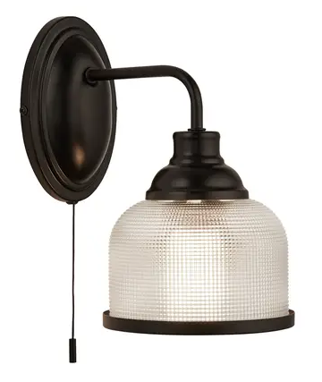

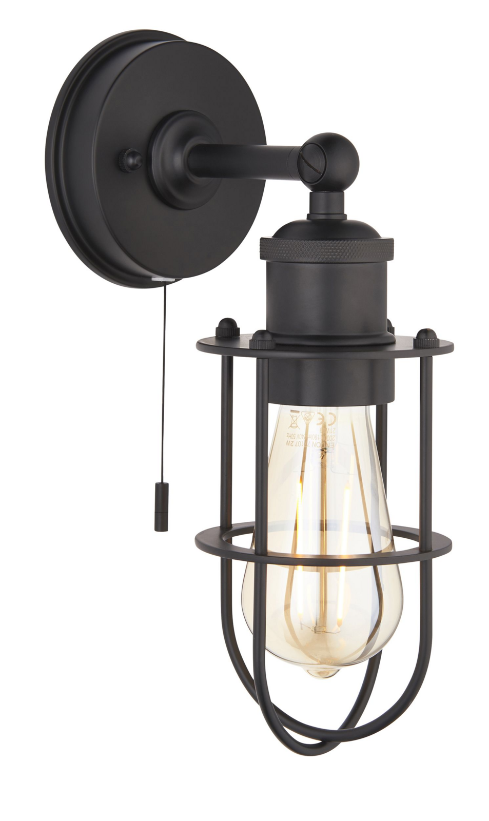

The problem with an integrated switch is to have enough distance between your fingers and live parts to ensure water can't result in you getting a shock, at one point we used earthed metal on outside switches, but the TN-C-S supplies and dangers with loss of PEN means that is no longer considered safe.
So there needs to be some method to keep distance, using a pull cord seems the easy way, found this 1674906631987.pngbut rather expensive and no IP rating, same with this 1674906855936.pngsays suitable for bathroom, but not sure on using outside. I got my white carriage plastic outdoor lamps for £2 each on sale at Link, OK cost £9 each for the smart bulbs I used in them, and when not on sale similar lamps likely £10 each, but paying £60 for outdoor lamps made of steel or aluminium which you know will only last a few years before they look old and tatty does not seem to make sense.
