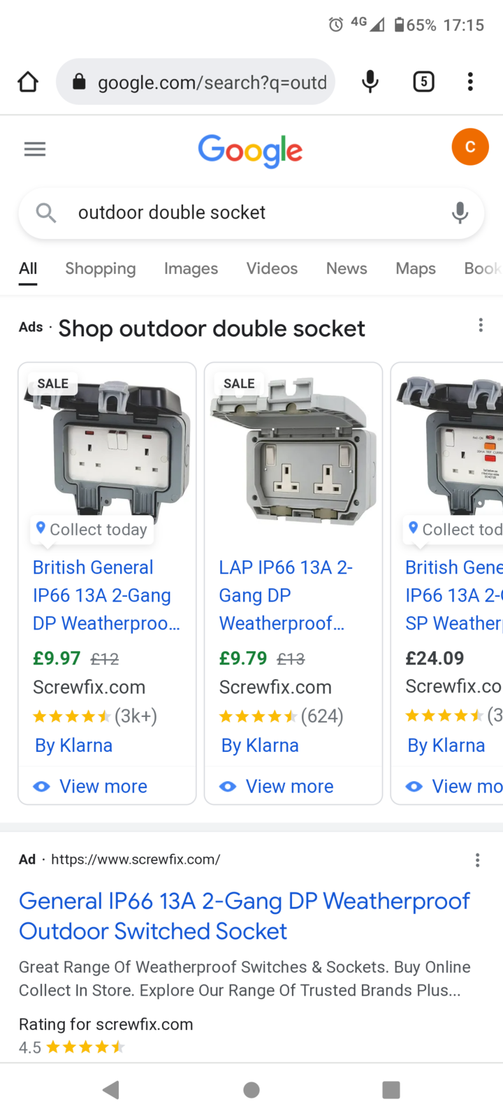

Anything special about them?
Will one of these be ok?
It will be fed from a 2.5mm radial from the CU.
Is the circuit protected by an RCD at the consumer unit ?
If it is you don't need the socket which has an RCD built in.
Ones made by Click are very good, they come with a gasket which goes around the whole fitting, ensuring a good seal if the cable enters the back.

Terry said you don’t need an RCD socket if the circuit has RCD or RCBO protection at source. He didn’t say you shouldn’t fit one. It’s hard enough getting people up to speed with BS7671 without Frodo introducing Australian rules and concepts. There is a section ‘electrics outside the UK’ for his posts.
